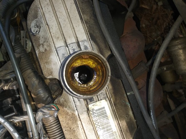

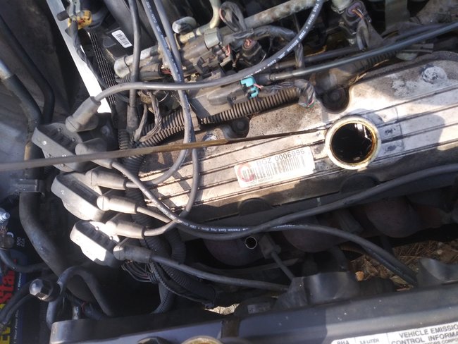

I just bought the car listed above literally 3 days ago. although it had been sitting for a while started great ran great. Absolutely no noises. Last night as I was driving it started ticking only on acceleration so I immediately begin to find a place to pull off of the road, when I was almost stopped the car shut off and started smoking. It never overheated and I never smelt antifreeze. Once it cooled I checked the oil cap and it had bright yellow almost spots on the cap. so I pulled the dip stick but it did not have the gunk. I did not try to restart it. Can you please help me out? Thanks in advance

Got the car home started right up no antifreeze on dipstick or inside engine. however, there is yellow slug on oil cap. What should be my next step to prevent further damage?

Can you also post a picture of the sludge?

The sludge.
Nov 9, 2019 at 3:34 AM
That is fuel mixing with the oil.

The dipstick looks like it is overfilled with oil.
