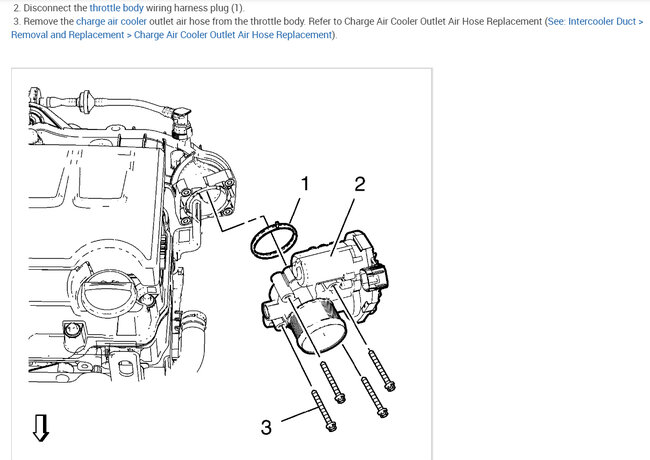

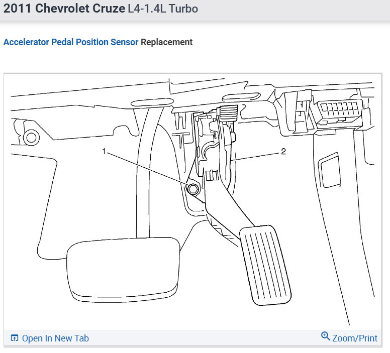

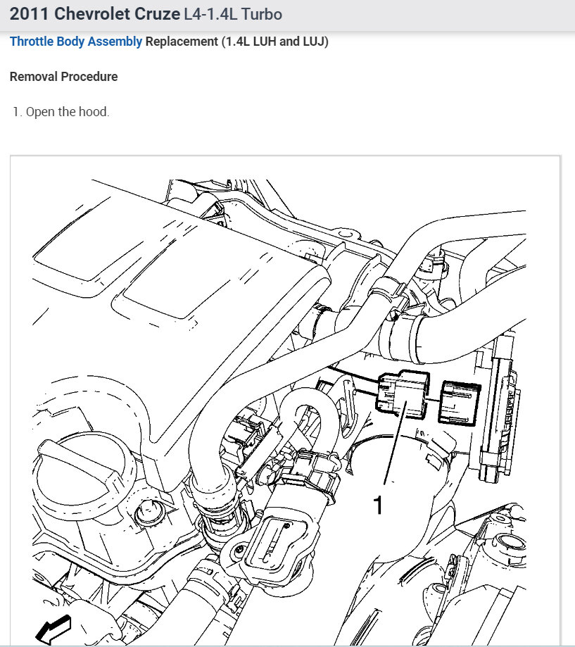

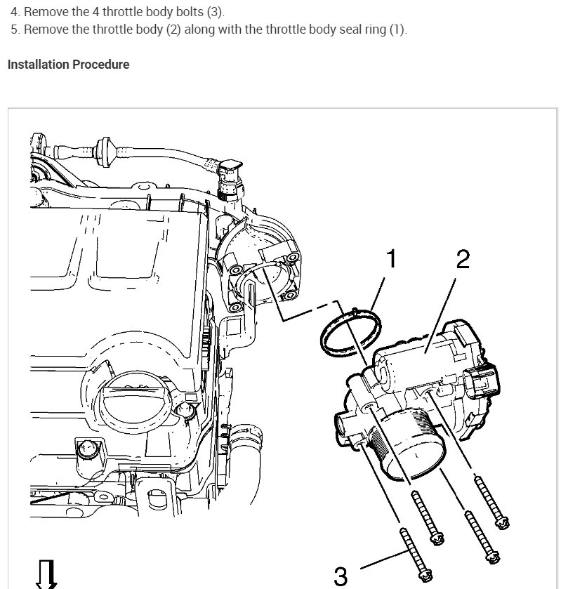

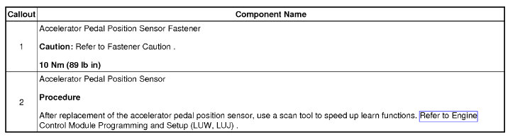

It sounds like the throttle actuator, or the accelerator position sensor is bad, but can I ask if you have a check engine light on? We should run the codes to see if any are stored, this guide can help:
Here is how to change out the throttle body and accelerator sensor in case a code comes up for either one. Check out the images (below). Let us know what happens and please upload pictures or videos of the problem so we can see what's going on.

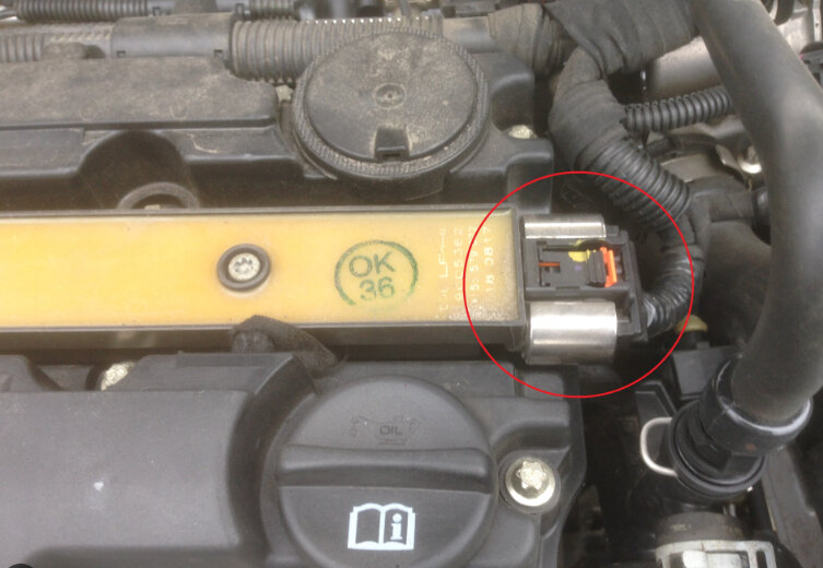

Also, I would suggest checking the coil pack connector.
While the engine is idling wiggle on the connector and ground wire, black wire.
See if the engine will cut out.
The ground wire, black wire, is bolted to the cylinder head just underneath the coil connector. Check that the terminal is clean and secure.
This problem will not set any fault codes.

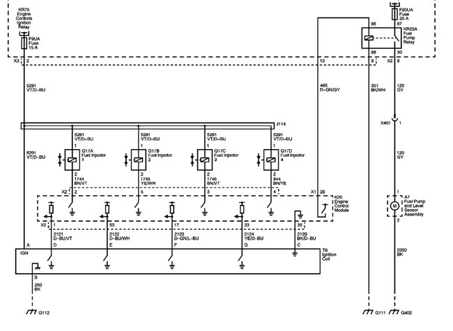

Wiring diagram below.

Hello Boris! you nailed it. Coil pack was blown. Once it was replaced with a new one, it's thousand times better, but still there is a small lag or skip in the engine. My mechanic is looking for other faults in the engine. Will keep you posted with updates!
