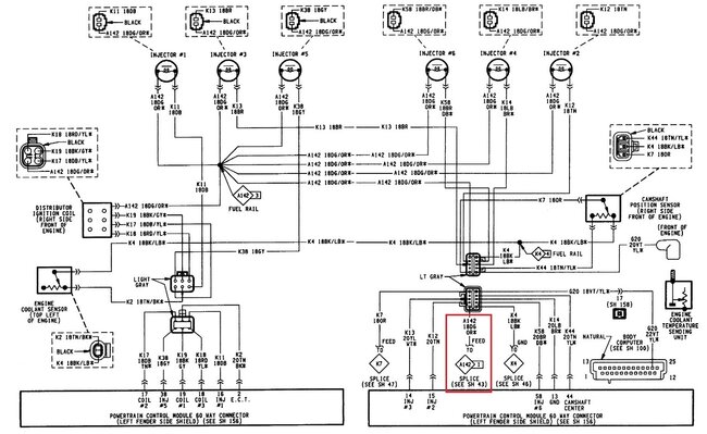

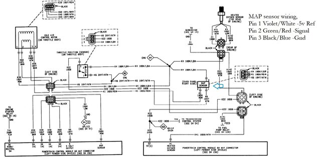

Well, here we go again. it would do this occasionally. it would do this and buck and sputter. then it would run smoothly again. but now recently it was doing this. now it turns over, but it won't fire over. it seemed like it was running out of fuel. i checked fuel pressure and it seemed to be ok about 40 lbs i checked the coil and that seemed to be okay. but now I'm thinking could it possibly be out of time? oh, and i forgot to add i didn't get any codes. so i'm totally lost. can i check timing anyway ? it doesn't even show me which is the # piston in my Haynes manual. DOH ! thanks-

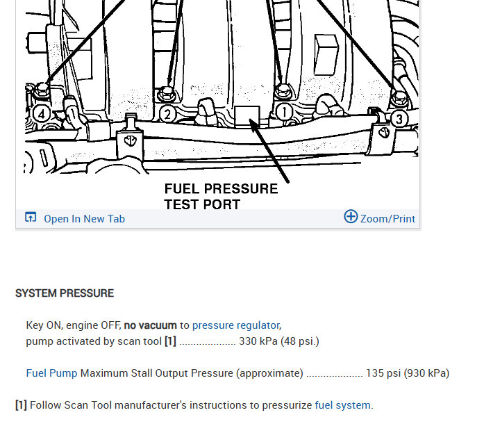

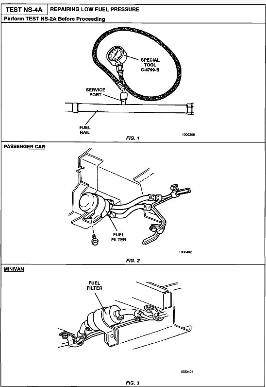

40psi is a bit on the low side, should be 48psi key on engine off.

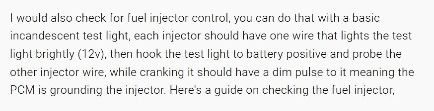

I would also check for fuel injector control, you can do that with a basic incandescent test light, each injector should have one wire that lights the test light brightly (12v), then hook the test light to battery positive and probe the other injector wire, while cranking it should have a dim pulse to it meaning the PCM is grounding the injector. Here's a guide on checking the fuel injector,
I'll post the wiring diagrams for you, they're not great, but will help, what are you using to check for spark? The adjustable spark testers are best because they will stress the coil somewhat. The "light up" ignition testers don't really give you a good idea of how strong the spark is. I'll get these wiring diagrams together for you, that way you can verify a full 12volts on critical components.
https://www.2carpros.com/articles/how-to-test-a-fuel-injector

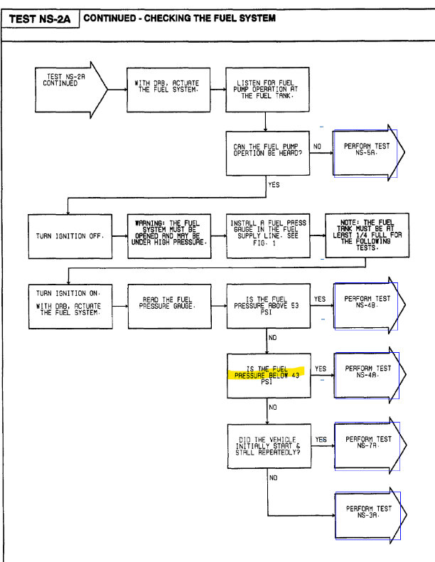

Okay, if your fuel pressure is below 43 PSI. They have this as part of the Crank No Start flow chart of theirs, they want you to check fuel pressure at the fuel filter. If you can't blow air through the fuel filter it's no good, and most of the time a clogged filter will stress a fuel pump and overwork it causing it to eventually fail, with low volume/pressure output. So, I would start here.

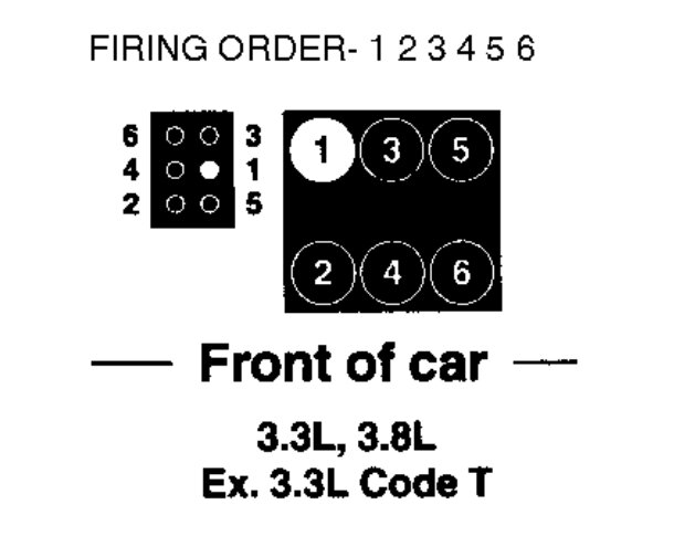

Here's your firing order and cylinder location, along with fuel pressure spec, ignition coil connector and the PCM connector if needed.

Okay Al, I'll start with your first reply. in my Haynes manual it says i should get a fuel pressure reading of 39 lbs it started this morning ran smooth for a while. i tested the fuel pressure while running and it was about 40 lbs steady. Then spit and sputtered and it shut off. won't start now again. The check engine light wasn't on. so, if it was on with only key on then what? i also checked engine codes engine running no codes. i pulled the fuel pump relay for corrosion and there wasn't any. so i'll check the fuel filter next. what i don't figure is? i replaced the fuel pump 3 years ago and the filter that is on it is like a micro fine filter so tell me how anything can get past there to clog the secondary filter ? DOH ! so where are you getting the pump pressure reading from ? thanks

The fuel pressure spec is from All Data, and using a test light on the ground side of the fuel injector is to test if the PCM is actually controlling them, if it's not pulsing the ground side of the injectors that tells you the PCM has stopped controlling them for some reason, such a bad cam or crank position sensor. Testing the resistance of the injectors is fine, but the test light is to check for PCM control. On some systems, especially these old ones, if there is a fuel injector shorting out when hot, for example, the PCM might shut them all down due to excessive current flow, on newer system, cylinders are controlled independent of each other. You still have 40psi and a no start condition, if you have good spark and you're sure of that, then you are most likely losing injector control.
Go ahead and do a resistance check of the injectors, they should be 12-14 ohms each, but if you have a test light hooked to B+ and there is no pulse happening on the ground side of the injector connector, there's no fuel injector control happening.
An old school trick is to put a long screwdriver up to the injector and listen for it clicking away while someone cranks the engine for you, just using the screwdriver as a stethoscope.

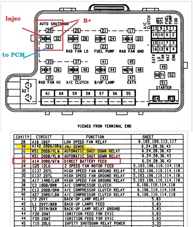

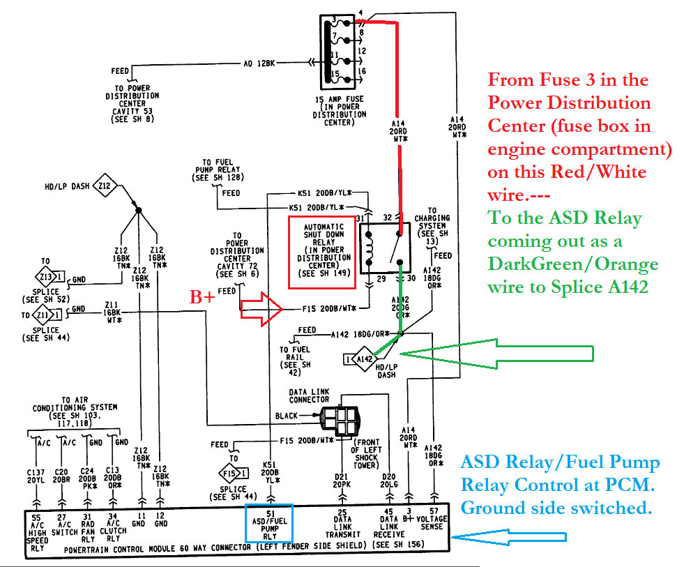

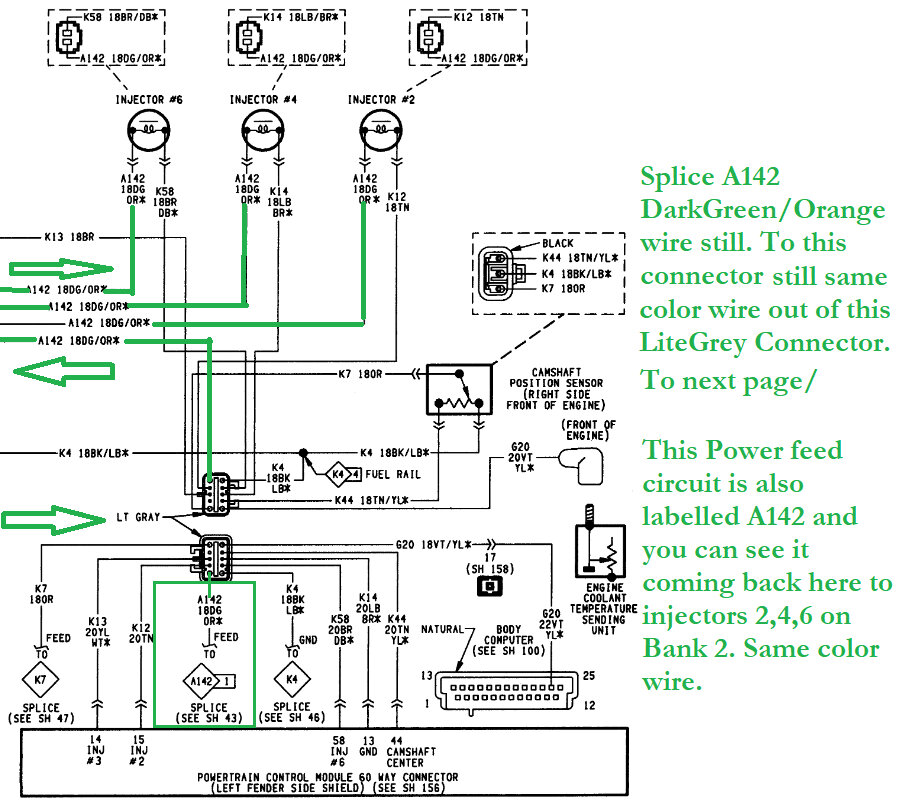

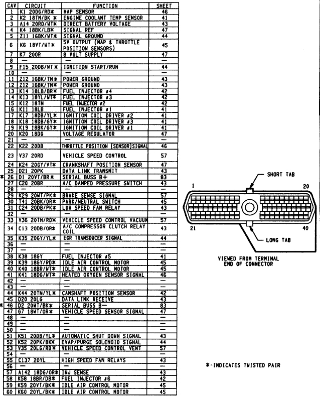

This is the power feed to the fuel injectors and ignition coil. It starts at Fuse #3 at the Power Dist Center fuse box in the engine compartment out to the ASD Relay, so if you take out the ASD relay you should have power on 2 of the 4 pins of the relay socket with the key On and relay out, the PCM grounds the ASD relay and Fuel Pump relay at the same time if these diagrams are correct, so if you have fuel pressure this may just be a bad ASD Relay, but following the below diagrams power goes out of the ASD relay to Splice A142 and that goes to this Lite Grey Connector which in turn sends power out on the 1st diagram to each injector and the coil pack.

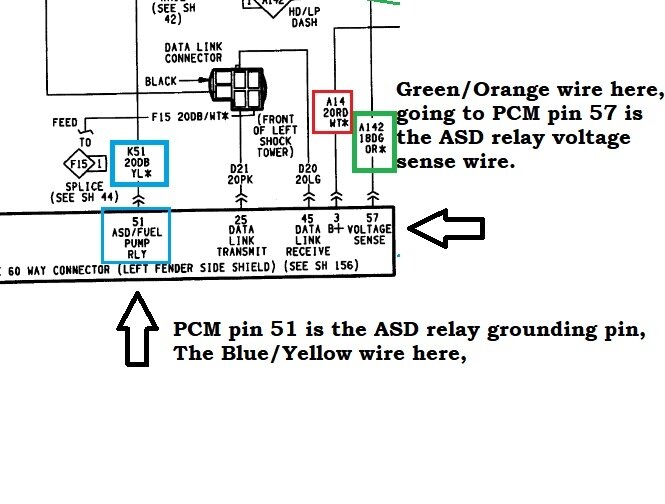

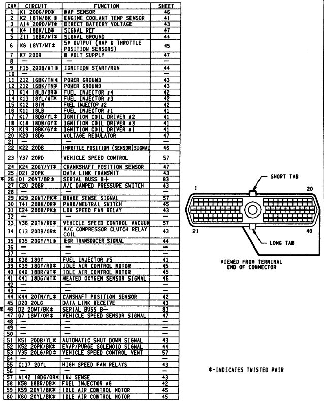

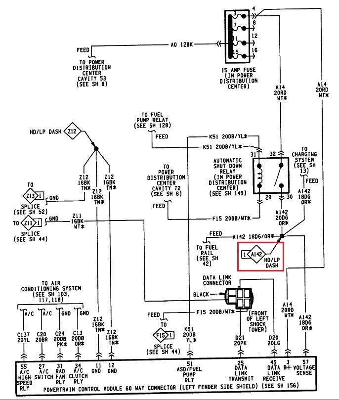

Also, in the first diagram marked in blue, is the ASD Relay goes to the PCM at pin 51 and is supposed to be a "Sense" but also looks like the Relay Control wire as well, the diagrams are incorrect in some places. The PCM should be setting a code if power is not sensed on this circuit, and since you're not getting any codes there might be an open circuit further down from the relay. You'll need to trace this Dark Green wire with an Orange Stripe.

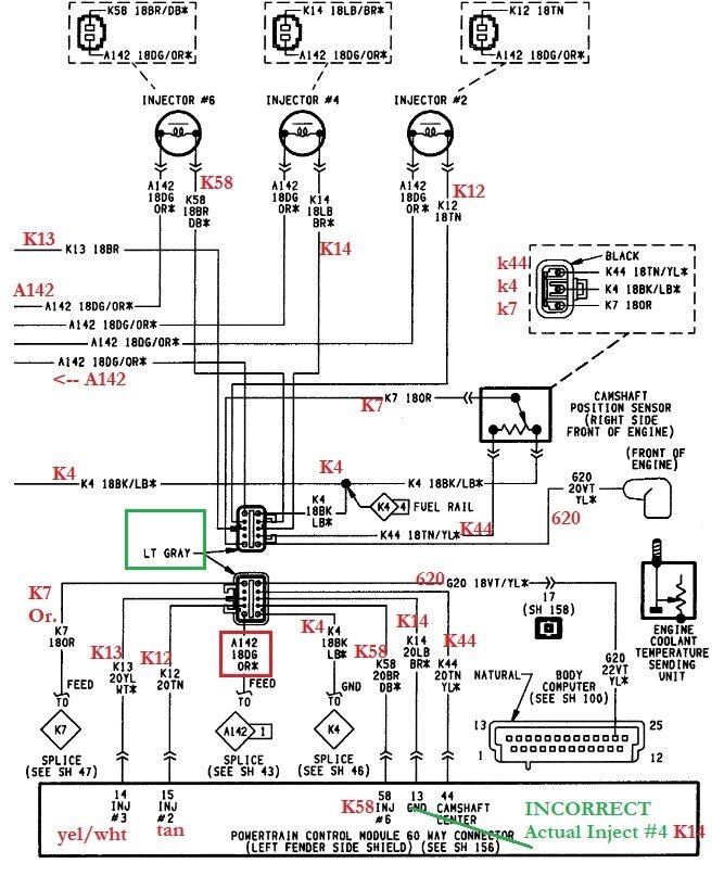

I will try to find to find this Lite Grey connector in diagram 2 below, which looks to be 10 pins. You may be able to find it in the engine compartment and check for power there on the same color wire, this dark green/orange wire seems to feed power to all the injectors and coil pack so it should be easy to identify.
At least now you know what the issue is, make sure you don't have any blown fuses as well

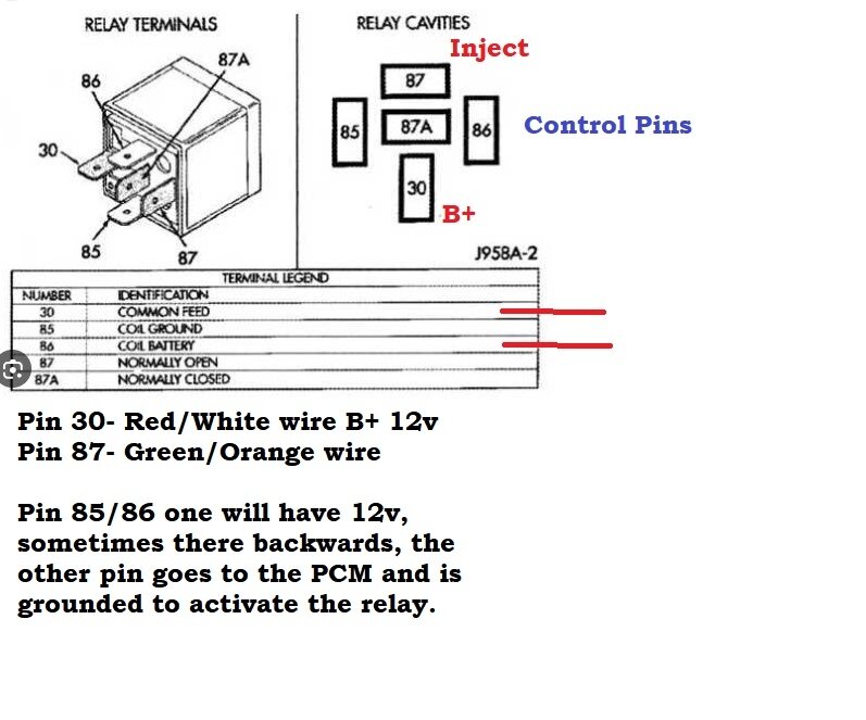

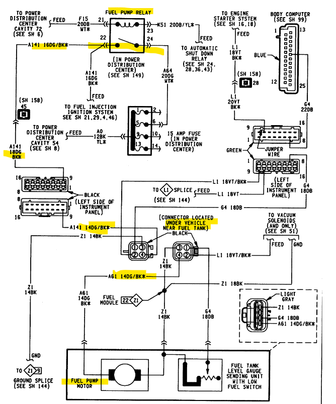

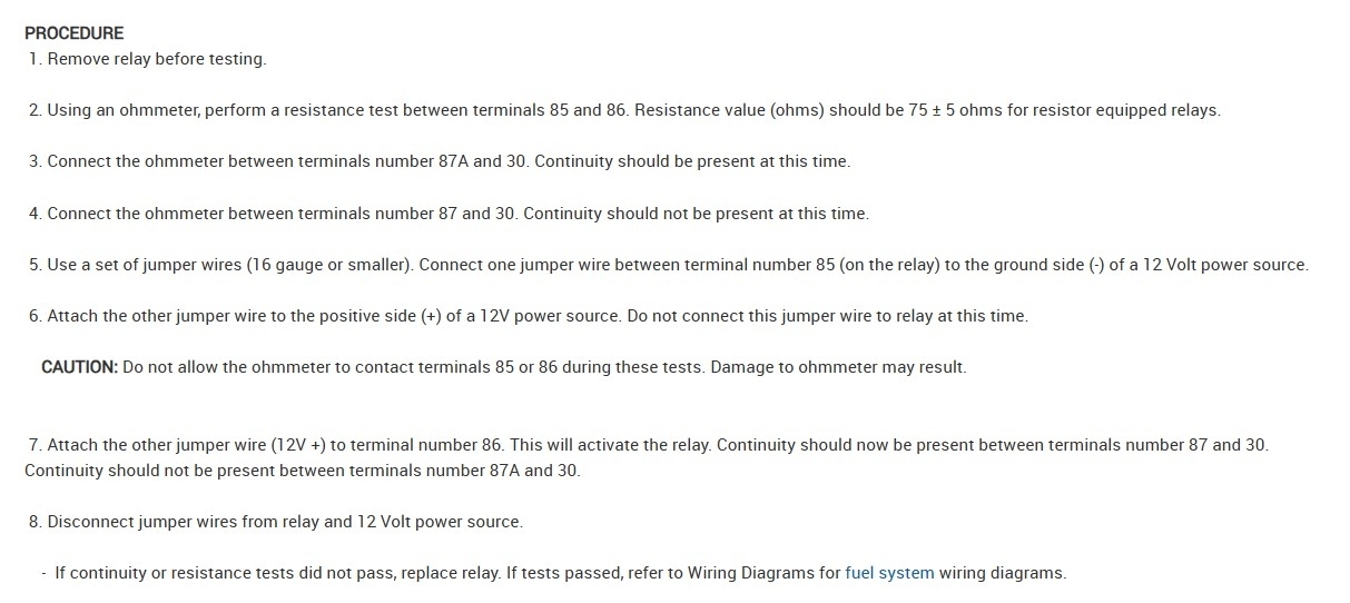

Diagrams 4,5 are the ASD Relay operations and testing.

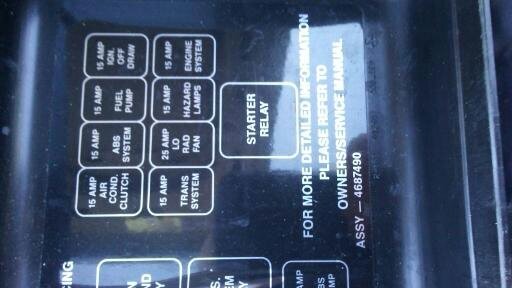

Okay Al, I'm a little confused and a lot frustrated. i don't know what fuse #3 you're referring to. the green/or wire you refer to goes to different pins. anyways i traced the gr/or one to the coil and got continuity. and to the injectors. i'll try to post a couple pictures to clarify. and i swapped relays and that did nothing. the green and orange wire goes to pin 87 and there's a red/wh wire that goes to pin 30 i looked at all the harnesses and dint see a red wire. i found the gray 10 pin plug its behind the battery. i didn't know where the crankshaft sensor was until i removed the air filter housing and it was way down in there. so i'm puzzled with that too. i removed the wiring harness from it and turned the key on. wouldn't that throw a fault code? so do you think i might have a bad crank shaft sensor or camshaft sensor? i can't see what color wires go to the crankshaft sensor and i can't trace them with out a wiring diagram so? thanks

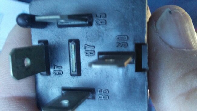

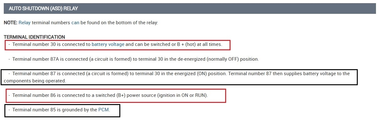

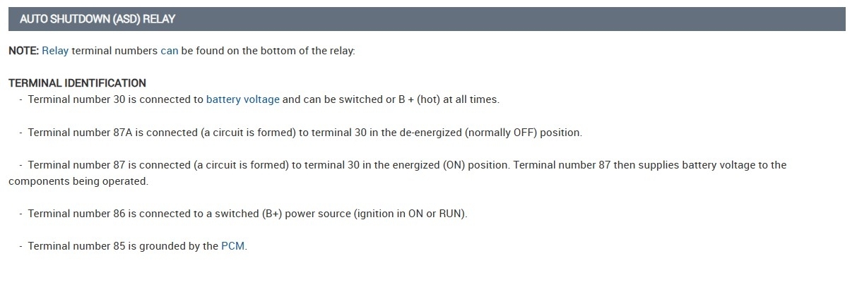

Okay. But these wiring diagrams are completely horrible, thats because theyre older, and I can see quite a few issues with them,
Dont bother with resistance/continuity testing now, right now you are looking for voltage, if it lights the test light up bright, you can verify its a full 12volts with a meter,
using a test light is faster and it puts a small load on the circuit,
But with the ASD relay out, you should have 12v on two of the pins where the relay sits with the key On, If this is correct, the control side of the relay should be pins 85 and 86, one of those pins should have 12v with the key On, Pins 30 and 87 should be the Load side of the relay, so one of those pins should have 12v.
(And pin 87A is a normally closed contacts with pin 30 until the relay is activated. For now, just verify the 2 hot pins, the PCM should set a code if it doesnt sense power.)
on the Red wire, it should be Red/White. These diagrams have the relay contacts listed backwards in some cases and upside down in other,
So we will just go with basic ASD relay operations.
The Red/White wire going to pin 30 is the constant power feed with the key On, , thats coming from the Fuse #3. But if you have 12v on pin 30 and it lights the test light bright, it should be ok for now.
pin 87 is where the power is going to exit the relay and head out to the injectors/coil etc. So those pins are the Load side. That should be the Green/Orange wire, So key On the relay should click and there should be 12v on the Green/orange wire (pin 87).
In the wiring diagrams they have these relays pins marked 29,30,31,32 so thats useless here.
Right now all we know is that youre missing power to the coil and injectors so we need to solve that first.
There should also be a Blue/Yellow wire and a Blue/White, those should be the other 2 wires to the relay, One will have power, and the other goes to the PCM.
*(note here, the PCM is using the Green/Orange wire for its "Sense" going to pin 57 of the PCM, thats telling the PCM that power came through the relay. So it might be ok,
I think youre going to find a broken or very corroded connector somewhere. And there's voltage being lost there.

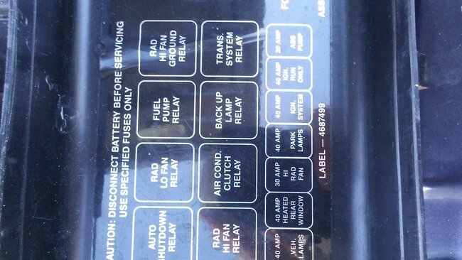

well, here is one of them anyway of my fuse box Al.
Jul 2, 2024 at 1:14 AM
DODGEPODGE
  • 111 POSTS
i had power to pin 30 and 86 with the key on. i don't see anything else that the green/ or wire goes to. here's what my relay looks like, and my relays and fuses are. all fuses are good. so-
Jul 2, 2024 at 1:59 AM

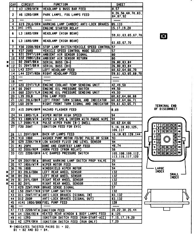

there should also be this 50 pin Bulk connector pretty visible, they are difficult to miss, check that.

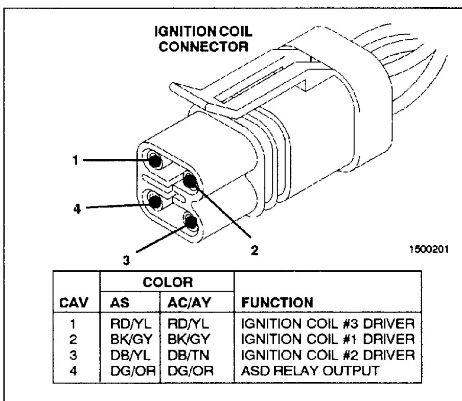

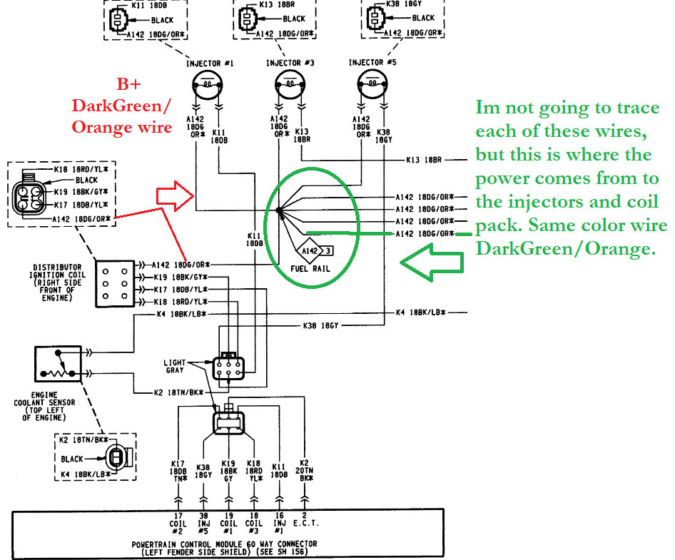

The 1st diagram is the 10 pin light grey connector, although it only has 9 wires in it, the 2nd diagram shows each wire by Circuit reference #, with the wire colors so you can identify the correct connector, It has the same Green/Orange wire running into and back out of the connector from the ASD relay pin 87 to the Splice that branches off to the injectors and coil. You need to track it down and check for power on each side of the connector,
The 3rd diagram is both pages 1 and 2 put together so you can see the entire circuit, the 4th
shows the splice off the ASD that feeds the grey connector, you'll need to follow this wiring section by section checking for voltage along the way until you find the area where there is no voltage, a broken wire, connector issue, etc.
Wires also do corrode inside the insulation and the copper strains break inside; it only takes a pin hole in the insulation for that to happen over the years. If you can't figure, it out, from here its best if you get it to a shop where they can diagnose what's happening, I'm not at the vehicle, so I can't do the testing for you, high resistance points to a bad connector, corrosion, water intrusion-corrosion, etc. worst case start checking them all.

If it's that close to starting, are you sure you have a strong enough spark, or the plugs are not fouled out, because it sounds like you have everything you need to start here. You can check the MAP sensor if you want to, here's the wiring pinout for it.
Because of miscommunications here we're taking too long, we went down the rabbit hole here with the wiring.
But we're missing something simple here. The engine needs a good strong spark, good fuel and good compression for an engine to run.
If you're getting a pulse from the injectors that means you should have a good cam and crank signals, the MAP is a possibility,

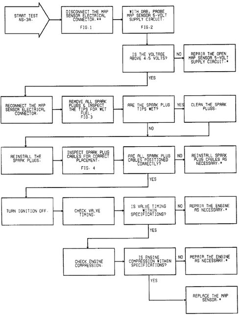

I'm just going to run you through the basic trouble shooting chart they provide here.
Hopefully you can see the 2nd diagram good enough below, first they want you to check that the spark plugs are not wet with fuel. And you have good strong spark, if those are ok, next they want you to unplug the MAP and check for a good 5volt reference feed, But I would do this plugged in to make sure the MAP isn't effecting the 5volt ref.
If those are okay, they want you to check compression.
If you cannot see the diagram well enough let me know and Ill break it up into smaller sections.

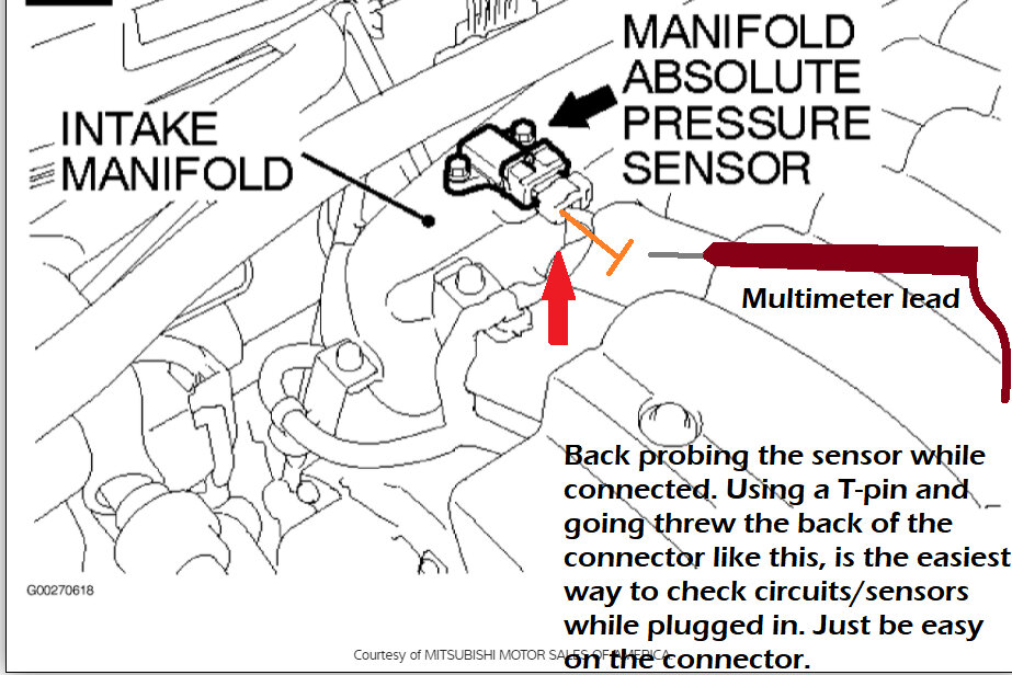

This is just MAP info.
(The Purple/White wire is the MAP 5volt feed. Green/Red MAP signal. The MAP should read closer to 4-5volts at key on engine off, and running should be 1-2volts roughly).
Jul 13, 2024 at 6:54 AM

A good spark should be able to jump at least 1/4- 3/8 in gap, If it does and the plugs are not fouled out with carbon or fuel, then go to a compression test, disable to the injectors, and hold the gas pedal to the floor while cranking, watch the compression gauge for the first pressure reading and then the 4th final pressure reading.

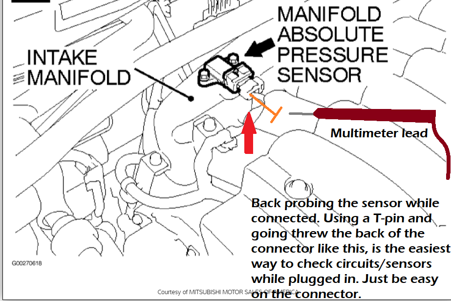

So, if i test the voltage at the map sensor plugged in. do i only test the feed wire and signal wire? and not the ground wire? will the voltage then tell me if the sensor is functioning? thanks
Jul 15, 2024 at 4:03 AM
AL514
  • 5,668 POSTS
You can use the sensor Ground when testing to verify its good, if the 5volt reference feed is low, switch over to Battery negative for ground to see if it jumps up to 5volt, indicating a bad ground for the sensor or PCM. Then at Key On engine Off, you should get a reading closer to 5v, usually 4-4.5v roughly on the signal wire, and when cranking since there should be some vacuum in the intake manifold the MAP signal should drop somewhat, it wont go as low as it would if the engine was running, since there is more intake vacuum when the engine is running at a higher rpm. Idle should be around 700rpm and cranking rpm is much lower.
Just make sure the pins are not spread inside the connector,
If you find that the 5volt ref is low and changing ground location doesnt make any difference, then unplug the MAP and check it again, when sensors that use the 5v Ref short out and pull down the reference voltage, it will cause the PCM to fault.
Also take a look at live scan tool data when cranking, you should be able to see the MAP sensors voltage live data PID along with the other sensors, Engine coolant temp sensor, TPS voltage, idle air control valve position.
The coolant temp sensor should be reading ambient outside temperature when you first turn the key On since the vehicle has been sitting over night.
Or if any of the sensors are reading 0volts, or full 5volts, those types of things should stand out as abnormal.
Did the front spark plugs look fouled out with fuel? Pull off the vacuum hose going to the fuel pressure regulator on the fuel rail, does any gas come out of it? You havent mentioned anything about the condition of the spark plugs yet.

The only way to know if it's got bad gas is to take a sample of it, cut a 2 liter soda bottle in half or some clear plastic bottle and take a sample of the gas, let it sit for a little while, if there's water in it, the gas will separate from the water into different levels. If its just bad gas you will notice it doesn't smell like gas anymore.
You can try the starting fluid, but it might not help much if the plugs are completely fouled out, but see what happens.
Its difficult to help when I don't have a clear idea of what is functioning and what's not.
I would recheck that there is good strong spark though as well, here's an easy guide to help make sure the spark can jump a good size gap.
You may want to get someone to come help you here, if you're having this much trouble understanding the testing methods.
https://www.2carpros.com/articles/how-to-check-for-ignition-spark
