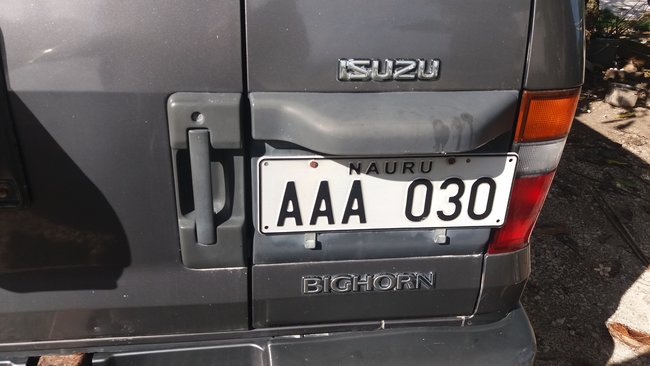

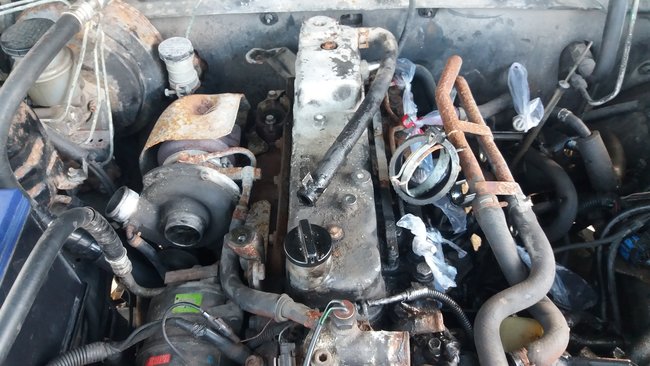

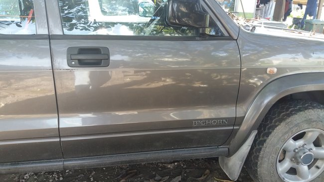

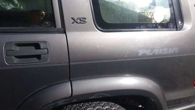

1995 ISUZU BIGHORN ? I don't see this engine in this truck?

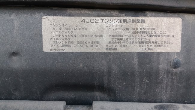

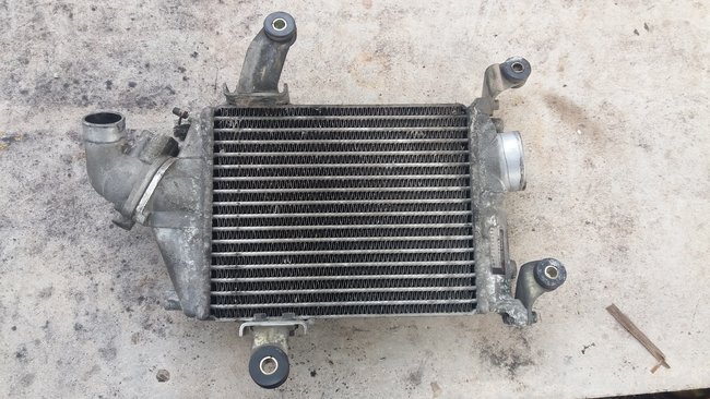

BATAAN DEIRERAGEA
  • 10 POSTS

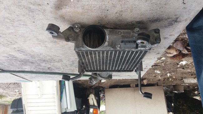

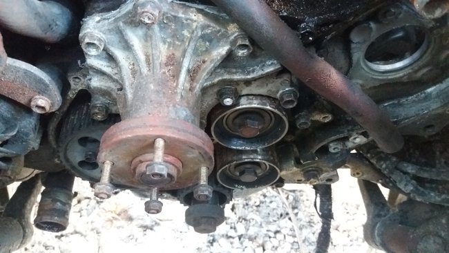

These are some actual photo of the truck for verification.
As you can see I have removed the intercooler, front end cover and injector pump in the plan of sending the injector pump oversees for checking and repair but decided to pin point the problem first whether it is actually the injector pump, ECU, sensor or wiring etc. is at fault but this is difficult without proper manual.
The only manual I have for this model incorporates a mechanical injector pump.

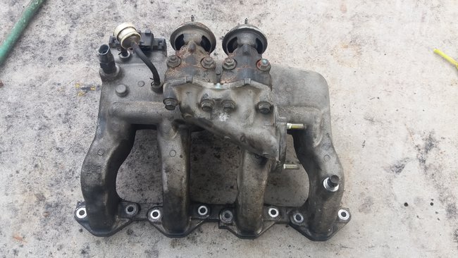

Does this have a throttle body can I get pictures of that?

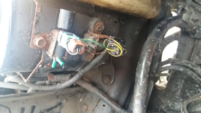

BATAAN DEIRERAGEA
  • 10 POSTS

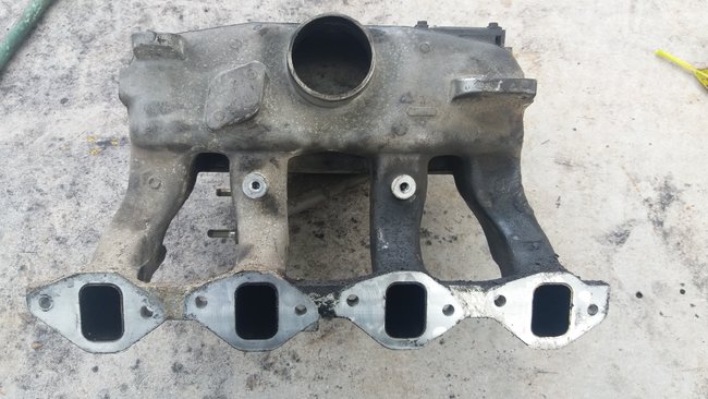

Photos taken on intake manifold, inter-cooler and electric valve controlling EGR valve. Looks like no throttle body or anti-shudder valve equipped for this model.
Apr 10, 2019 at 9:22 AM

Do you have a picture of the throttle body?

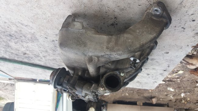

The throttle body is usually mounted on the intake manifold, if i am correct, which obviously nowhere to be found on the intake manifold. refer latest reply photos. If I'm wrong, please advise where to locate it.
Apr 11, 2019 at 4:07 PM
  • 55,711 POSTS

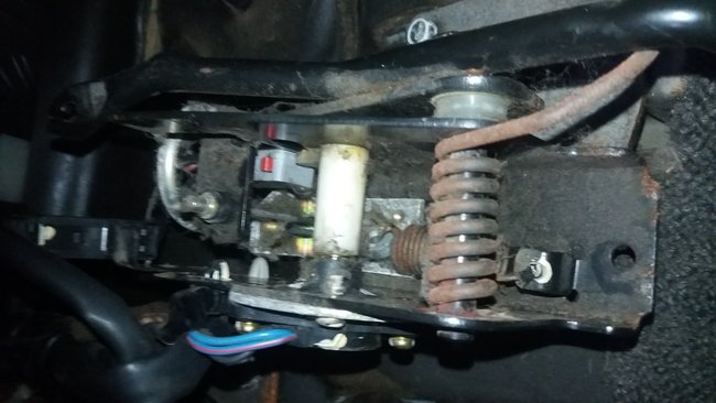

It might not have one, the high idle is due to excessive fuel entering the engine at idle. This could be due to a faulty throttle sensor or injector pump, on or the other. can you take pictures of the throttle pedal etc?
Apr 12, 2019 at 3:15 AM

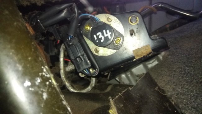

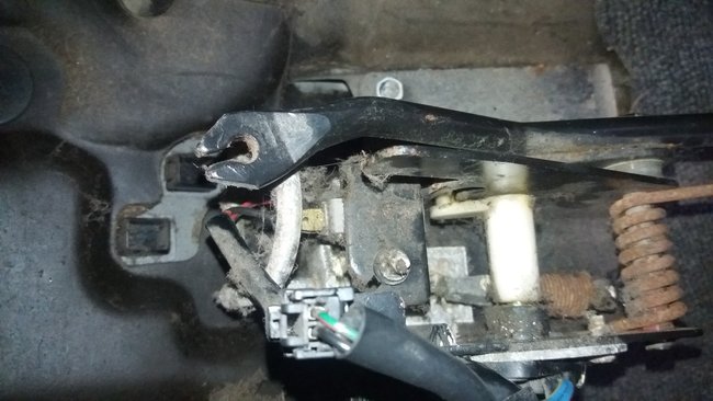

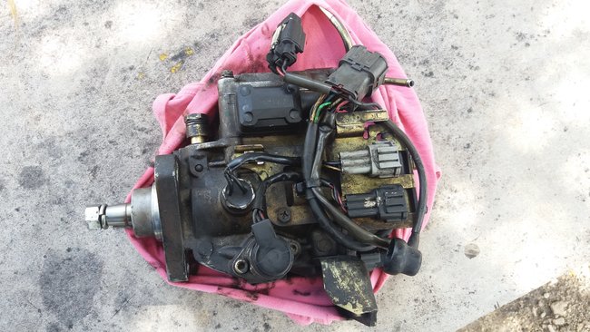

BATAAN DEIRERAGEA
  • 10 POSTS

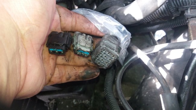

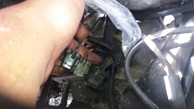

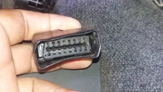

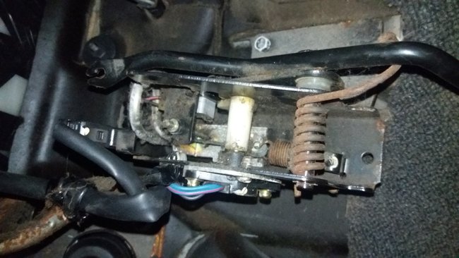

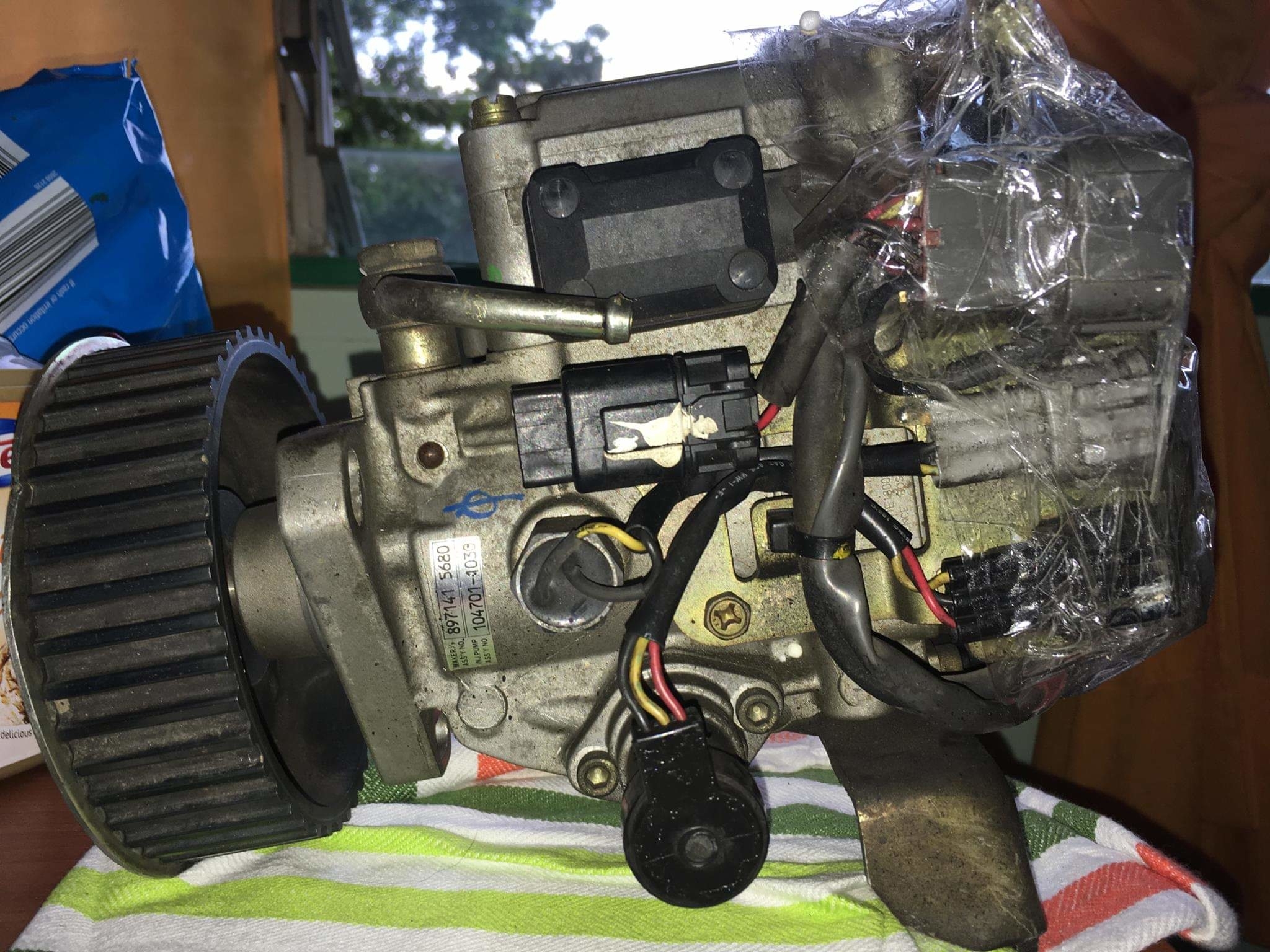

Photos taken: injector pump connectors, OBD2 connector and accelerator position sensor, last 4 photos, respectively.
Apr 12, 2019 at 2:47 PM
  • 55,711 POSTS
Yep, I would test or replace the throttle sensor or look for an adjustment. Also lets run the codes to see what comes up.

Unfortunately no available scan tool is able to retrieve fault code. but I've disconnected the accelerator pedal sensor but still engine rev problem existed.

  • 55,711 POSTS
Lets remove the EGR valve to see if it is stuck open. here is a video to help:

BATAAN DEIRERAGEA
  • 10 POSTS
It's been long since my last post, sorry.
The injector pump just came back from servicing overseas as it is at fault as per agent finding and now problem existed no fuel reaching injector nozzle upon cranking.
Could this be timing setting, wiring connection or any other problem that's causing this?
