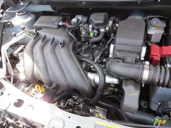

Hello Joe, you are right it might be a vacuum leak, this 2014 Nissan Versa SV engine is equipped with a tachometer and when the car is idling at the red traffic light in the Drive position the tachometer registers an idle speed of just 500 RPM or just 500 revolutions per minute and it barely idles and barely keeps the engine from stalling out, at idle in Park the tachometer registers an idle speed between 500 RPMs and 600 RPMs and I think that the normal idle RPM in Park should be 750 RPMs, I said in my original post that I would download the photo of a removed engine but the laptop computer refused to download the picture, this time I will try to download the photo of an engine that is still in the car, Wow this time the photo downloaded successfully, so I know that in the front side of the engine right above the intake and exhaust variable valve timing solenoids there is a vacuum hose that goes from the valve cover to the PCV valve, but I see vacuum hoses next to the electronic gas pedal which I don't recognize and I don't know what they are there for, any help is greatly appreciated, thank you Joe.

Wow, that engine looks brand new!!! Are you sure it has 100K miles? LOL
The PCV valve should be located at the valve cover. From there a hose takes it to the air induction system (air filter box and inlet). See pic below.
Check to make sure that isn't damaged, disconnected, or cracked.
I need to see a picture of the hose near the accelerator pedal position sensor. There shouldn't be any vacuum hoses in the vehicle.
One last thought, if you find the PCV is not leaking, I need you to check other possible leaks. Follow the directions in this link and let me know if you find anything.
Let me know what you find. Also, if you could record the noise you hear and upload it for me to hear, that would be helpful.

the reason the engine in the picture is looking brand new is because it's not our engine, I don't know how to use the laptop computer's webcam (web camera) which is located right on top of the computer screen, I don't know how to use the computer webcam to take a live photo of our engine because I am computer illiterate, instead this photo came from the bing images search website where I typed 2014 Nissan Versa SV engine and this engine photo came from a car dealership website and I am sure that they polish and shine the engine so they can sell the car, excuse me Sir Joe (JacobandNickolas), but if our engine barely idles at 500 RPM when we stop at the red traffic light then if I mess or fool with any vacuum hoses or any vacuum lines won't that further (farther) dilute the already lean air-fuel mixture or air-fuel ratio coming out of the fuel injector electromagnetic coils, needle valve armatures, and needle valves and out of the electric fuel pump's electromagnetic poles, armature, impeller, rotor, turbine pumping element, and cause stalling at stoplights? also I notice that there is no fuel return line and no fuel pressure regulator in this vehicle like the ones found in 1990s model new cars back in the 1990s and also from the electric fuel pump module picture in the Advance Auto Parts website I notice that the electric fuel pump module has no strainer underneath it, are fuel pressure regulator, fuel filter, and fuel pump strainer internally located in the thick plastic cylindrical electric fuel pump module? I was just curious, thank you Joe (JacobandNickolas)

As far as a fuel line, there is one. I attached a pic below and highlighted it with yellow. In this pic, there is a pressure tester between the supply and fuel rail. I have a blue arrow showing where the line belongs.
As far as checking for a vacuum leak, I'm not sure I understand your question. It won't make things worse. We are hoping to identify a leak so it can be repaired and the idle can return to normal. You mentioned a lot of different electronics that aren't involved with testing. If you follow the link I attached above, you will be fine.
