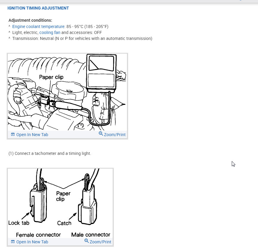

I was going to check the timing as I already replaced the Throttle Position Sensor and Idle Control Valve. I saw a post about using a paper clip, but I can't find anything on the actually procedure. I will be cleaning the throttle body but thought I'd check everything.

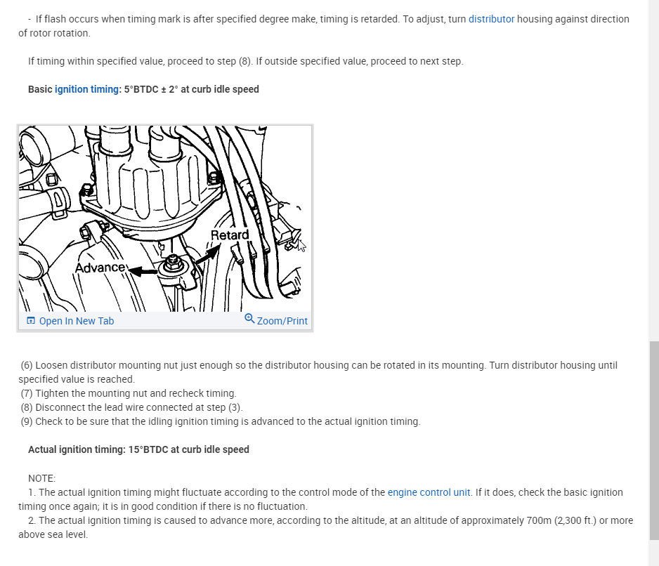

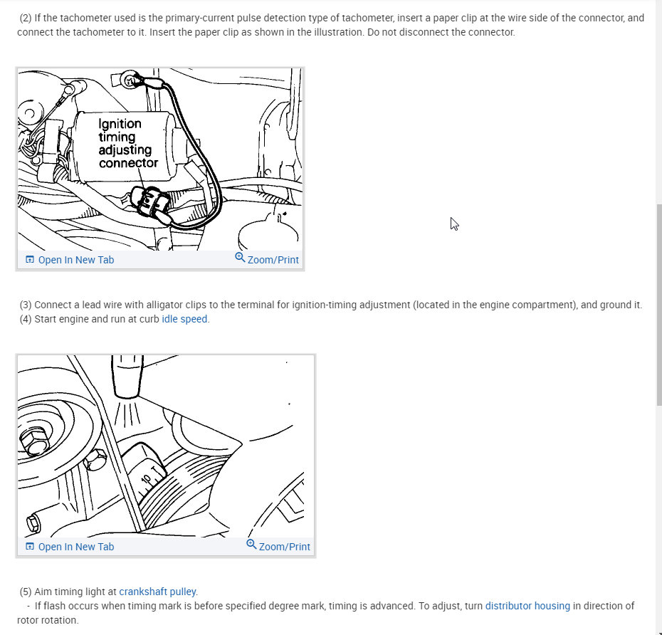

Yep. Here is the procedure including the paper clip.
Another thing to check is for vacuum leaks. Here is a guide that goes through how to do that:
Let me know what you find and we can go from there. Thanks
