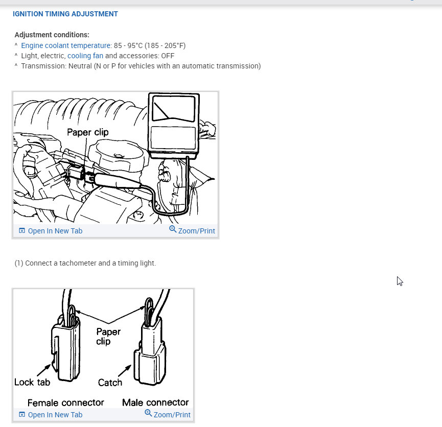

Engine idle jumps from 900 to about 1,500 rpm's
1990 MITSUBISHI MONTERO
133,000 MILES • 3.0L • 6 CYL • 4WD • AUTOMATIC
JOHN BLAILE
I was going to check the timing as I already replaced the Throttle Position Sensor and Idle Control Valve. I saw a post about using a paper clip, but I can't find anything on the actually procedure. I will be cleaning the throttle body but thought I'd check everything.
Thanks,
Nov 4, 2019 at 7:26 AM

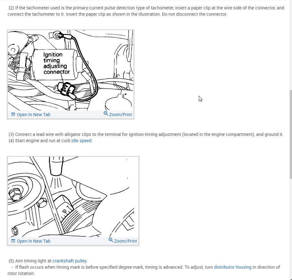

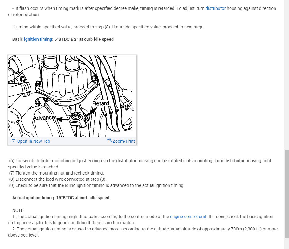

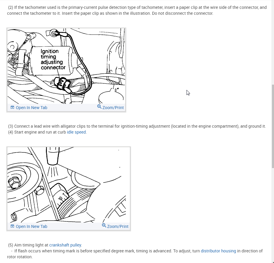

Yep. Here is the procedure including the paper clip.
Another thing to check is for vacuum leaks. Here is a guide that goes through how to do that:
Let me know what you find and we can go from there. Thanks
