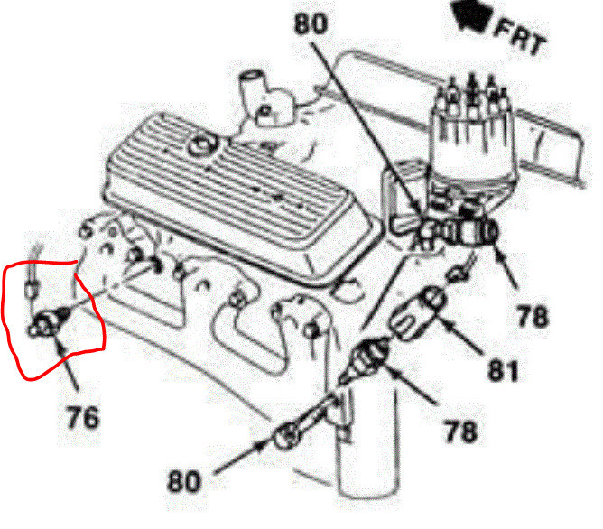

the engine starts up fine but when it warms up it starts to shut off like it's getting too much fuel. If I try to drive it it keeps dogging out when I give it gas unless I floor it. I've replaced the EGR valve, the EGR cyl, the ECM, the TBI with a working junk yard one and still no luck. My Uncle replaced some other things he thought it could be. I'll try to update this but any advice would be amazing. Also there hasn't been any check engine light I replaced the bulb just to be certain.

My first suspect is the coolant temperature sensor, it's located by the thermostat housing. It is inexpensive and a very common problem with the early GM systems, a lot of times without a check engine light. When they go bad it will usually run decent when started but as the engine warms up and the ECM doesn't know it it due to the sensor it runs too rich.
If it was my vehicle I would replace the sensor regardless. If you can replace the sensor and let us know the results we would appreciate it. We look forward to hearing back from you and thank you for using 2CarPros!
Feb 17, 2021 at 8:33 PM
  • 110,248 POSTS

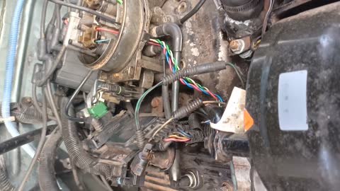

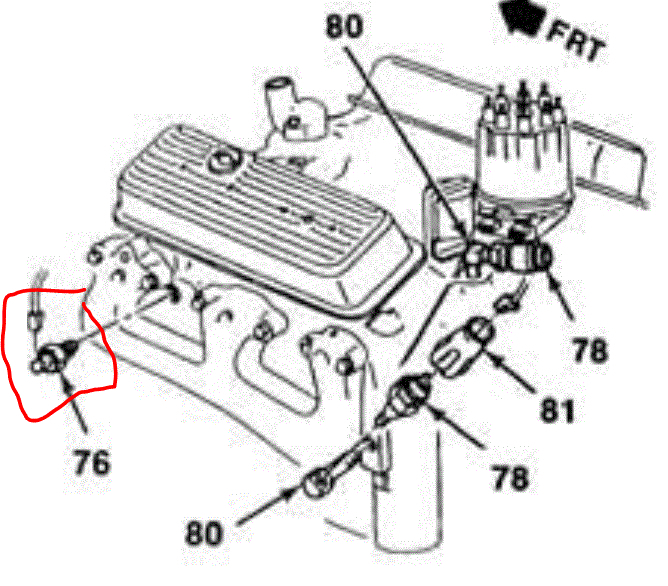

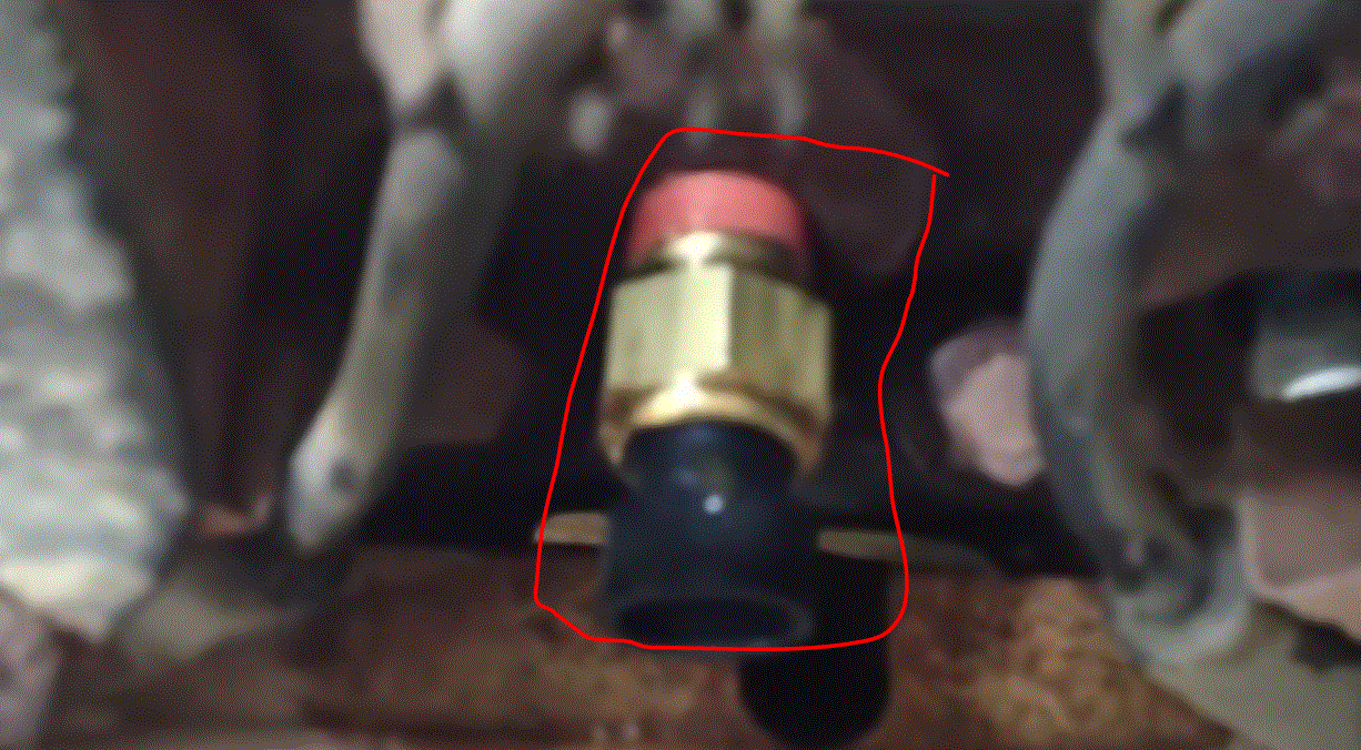

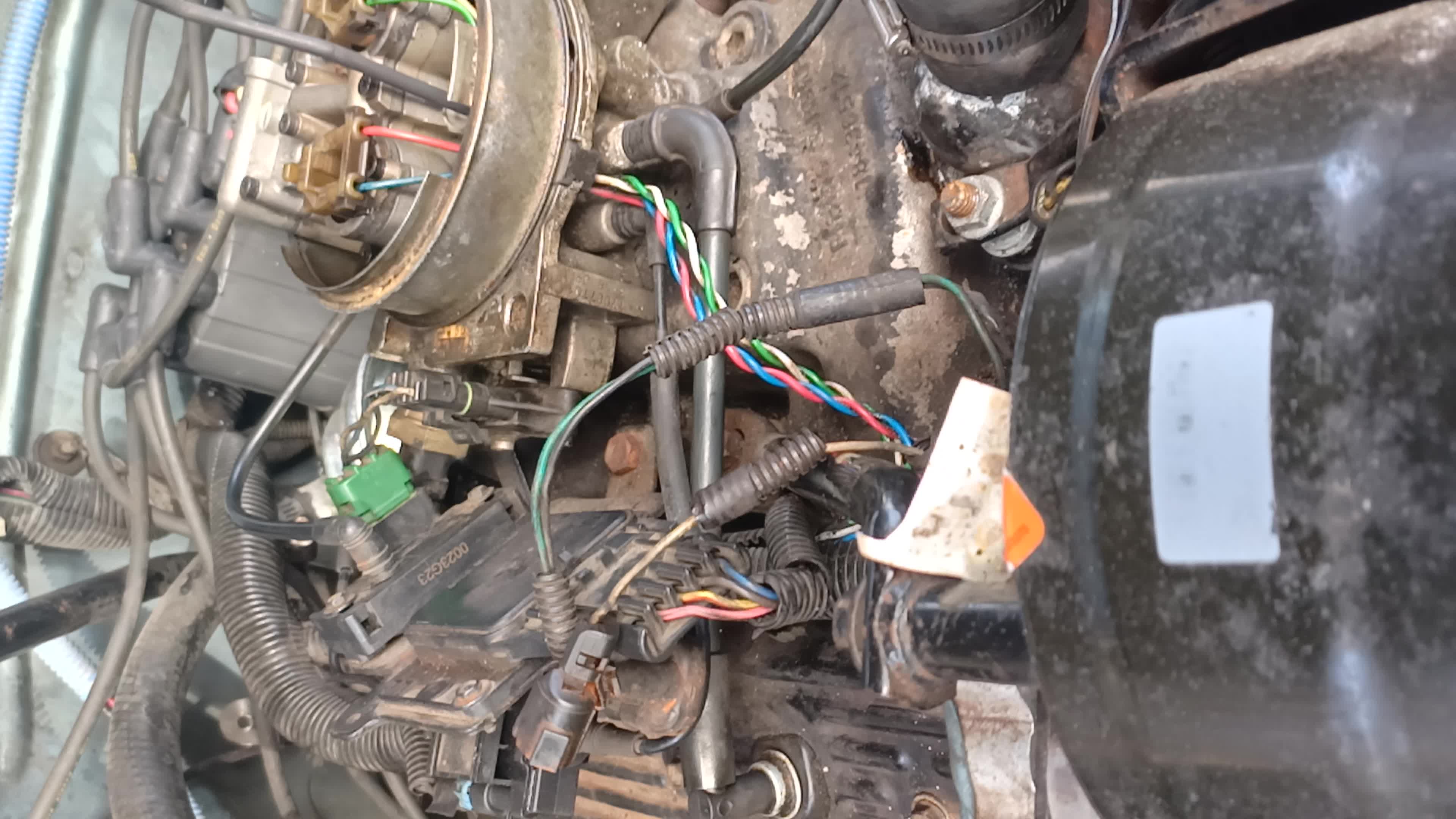

The coolant temperature switch is located on the left side of the engine (driver's side) and between the first and second spark plug. See pics 1 and 2.
