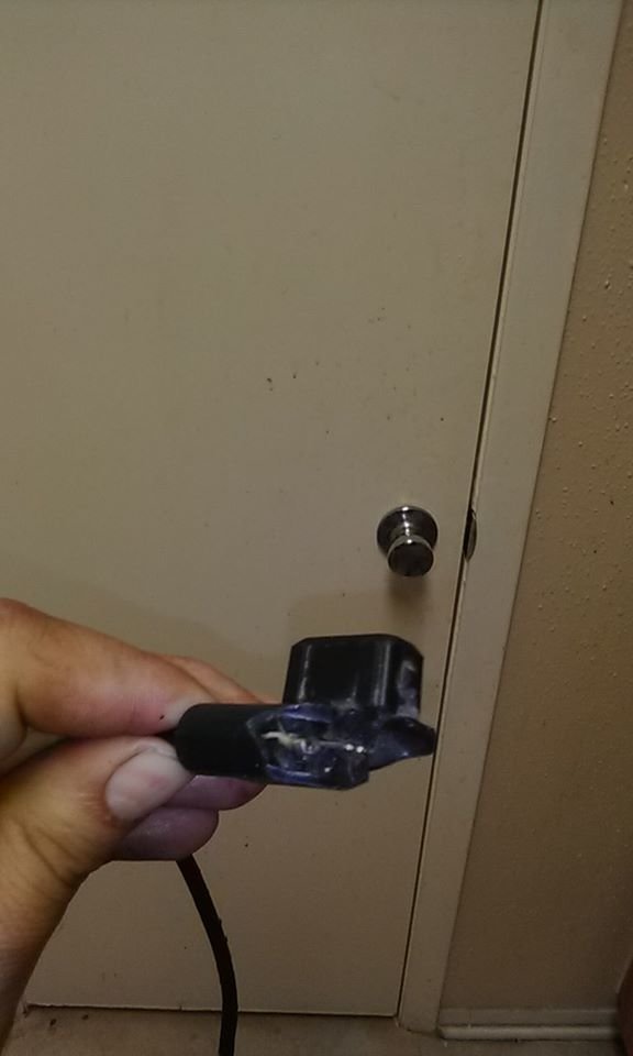

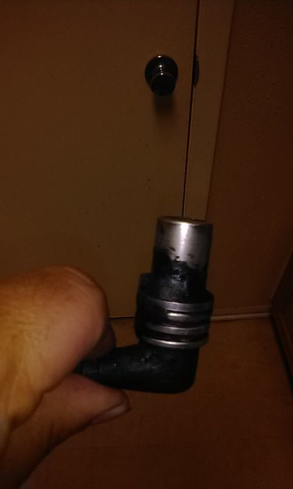

Hi, i cleaned the CSP, because it was very dirty and the wire connector is coming apart and i also swap out the fuel pressure regulator had a used one i had here and didn't tighten it all the way. The car did start did see fuel spray out of fuel pressure regulator. i tighten it back up and the car started again, the engine did want to stall unless i gave it gas. I'm posting pictures of the CSP.
Jun 14, 2020 at 12:02 PM
Were those pictures before or after you cleaned it? I would just replace it if it were me but I do know people who clean them.
