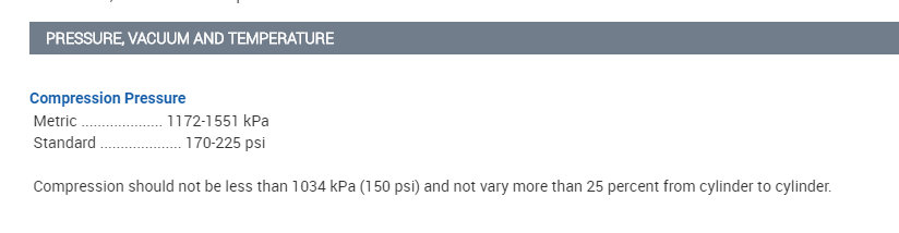

Hello. I have the car listed above SXT model. I have recently replaced the spark plugs, coils, and the throttle body. Still having the same problem. I noticed oil in the second cylinder while replacing the spark plugs. Could a blown head gasket be the source of my problem? Or what else should I be looking at?
Jan 16, 2020 at 7:26 AM
It can but oil in the cylinder is more likely caused by the rings failing.
We need to start with the compression check to see what we have. More than likely you will find it low on the cylinders that you found oil. If that is the case then we need to do a cylinder leakage test.
Let's start with compression and go from there. Thanks

Okay, so the compression test would be the first step in figuring out why it’s idling rough. It happens when accelerating intermittent.
Jan 16, 2020 at 8:48 AM
Since you covered the most common components and found oil, I would just check the base engine by checking compression because if that is not okay then nothing else really matters. However, if that is okay then we can dig deeper.
Think of it as checking the foundation on a house. No need to look to see if the kitchen is nice if the foundation is no good.
We may have a fuel issue but again, that will be the next thing after making sure compression is okay.
