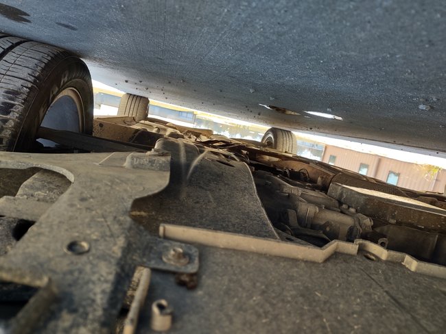

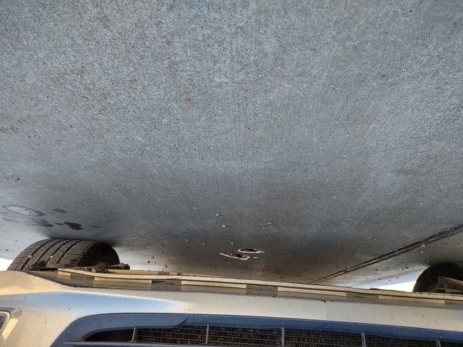

I was driving to work this morning and noticed that my engine was running much hotter than normal but would cool down when I slowed down or stopped at a red light. Got to work and noticed coolant pooled up in the front bumper on the driver side. We noticed the coolant tank was nearly empty even though it was where it was supposed to be last week. We put coolant in and ran the engine but couldn't find any leaks. I'm lost.

Thank you for your reply. I just took it a few miles down the road and back. I'm idling it right now and so far, everything looks okay. But when I stopped at the gas station where I turned around, there was a small pool of coolant. I don't know how to find where it's leaking from. Could it be the radiator cap?

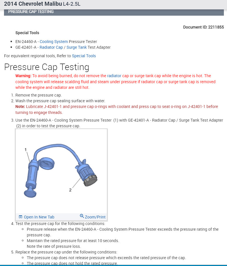

It could be a weak cap that allows coolant to escape. And when the coolant is low the engine will overheat.
See if it comes out of the cap, as it idles.
The radiator cap can be tested. Most auto parts stores have radiator cap tester that you can use to check for pressure leak.

It appears coming from under the engine.

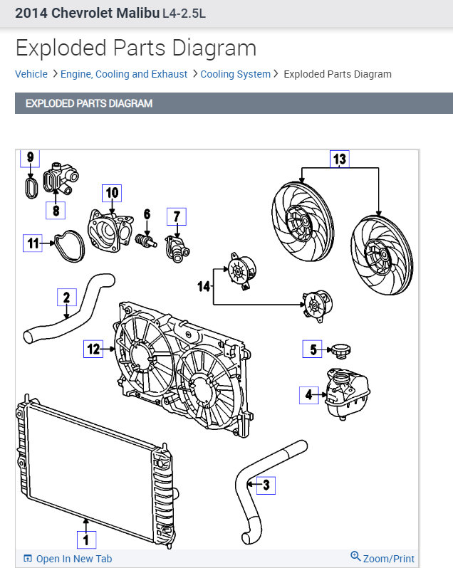

I need you to inspect under the hood. Look close to the fire wall, you will see there are a few coolant bypass hoses at the back of the engine. It could be from one of those.
