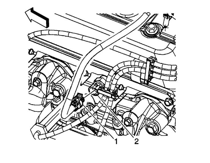

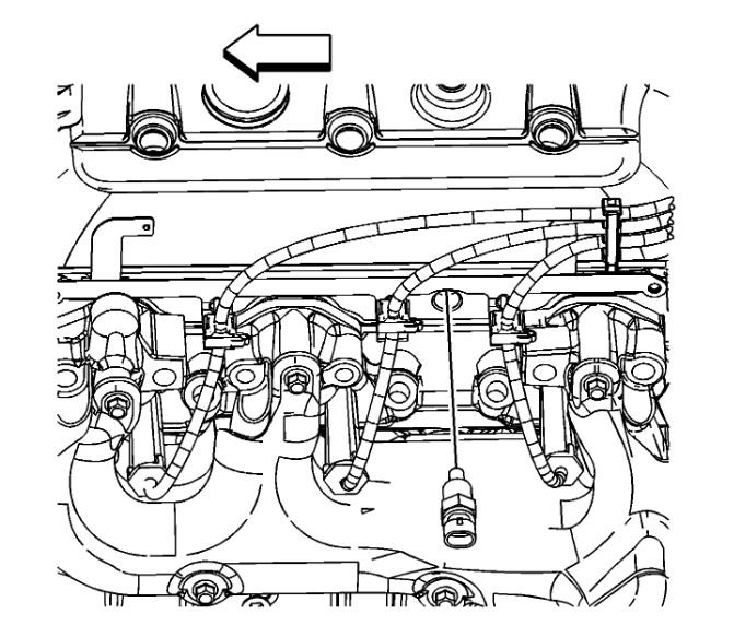

But, at the same time the coolant temperature gauge stays on zero all the time. I checked the coolant level and it's okay. Also the top radiator hose gets hot after the engine has been running. No steam coming from under the hood. I'm not sure it's actually overheating. And no service engine light.
May 4, 2020 at 10:00 AM
Good morning,
Do you have a scan tool that can read live data? See if it reads engine temperature.

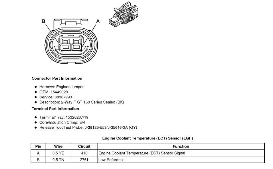

https://www.2carpros.com/articles/how-a-coolant-temperature-sensor-works
The coolant sensor is what sends a signal to the ECM for engine temperature and then off to the cluster.
https://www.2carpros.com/articles/symptoms-of-an-overheating-engine
When the ECM sees high temperature, it will disable the AC to reduce load on the engines.

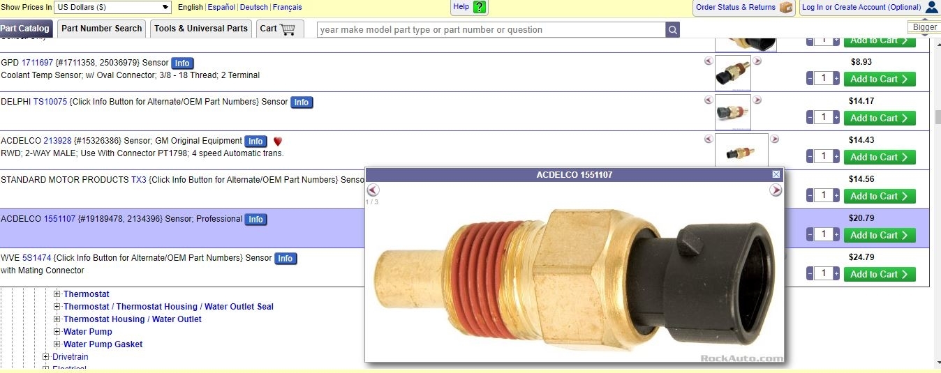

https://www.2carpros.com/articles/coolant-temperature-sensor-cts-replacement

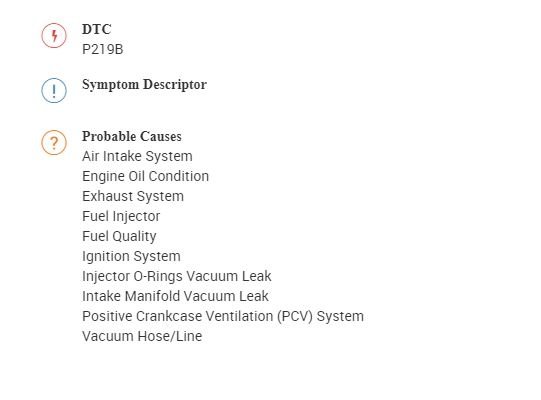

DTC P219A or P219B
Diagnostic Instructions

1. Read and record the Freeze Frame/Failure Records data taking note of the speed and load at which the DTC set.
2. Diagnose any other DTCs that are set. Refer to Diagnostic Trouble Code (DTC) List - Vehicle (See: A L L Diagnostic Trouble Codes ( DTC ) > Diagnostic Trouble Code Descriptions > Diagnostic Trouble Code (DTC) List - Vehicle).
3. With the engine idling and the transmission in the Park or Neutral position, observe the manifold absolute pressure (MAP) sensor parameter. The MAP sensor parameter should be between 19-42 kPa.
If the MAP sensor parameter is not between 19-42 kPa, refer to DTC P0106 (See: A L L Diagnostic Trouble Codes ( DTC ) > P Code Charts > Powertrain Management) or DTC P0107 or P0108 (See: A L L Diagnostic Trouble Codes ( DTC ) > P Code Charts > Powertrain Management).
4. Inspect the air induction system for modified, damaged, leaking, or restricted components.
5. Inspect the crankcase ventilation system for improper operation.
6. Inspect the vacuum hoses for splits, kinks, and improper connections.
7. Inspect for vacuum leaks at the intake manifold, the throttle body, and the injector O-rings.
8. Test for a restricted, damaged, leaking, or modified exhaust system from the catalytic converter forward. Refer to Symptoms - Engine Exhaust (See: Exhaust System > Symptom Related Diagnostic Procedures > Symptoms - Engine Exhaust).
9. Test the fuel injectors for improper operation. Refer to Fuel Injector Diagnosis See: Computers and Control Systems > Component Tests and General Diagnostics > Fuel Injector Diagnosis.
10. Test for fuel contamination. Refer to Alcohol/Contaminants-in-Fuel Diagnosis See: Computers and Control Systems > Component Tests and General Diagnostics > Alcohol/Contaminants-In-Fuel Diagnosis.
11. Test for excessive fuel in the crankcase due to leaking injectors.
12. Test the ignition system for improper operation. Refer to Electronic Ignition System Diagnosis (See: Computers and Control Systems > Component Tests and General Diagnostics > Electronic Ignition System Diagnosis).
13. Test the engine for any mechanical conditions such as sticking valves, lifters, etc., which could alter the flow into the combustion chamber. Refer to Symptoms - Engine Mechanical (See: Engine > Symptom Related Diagnostic Procedures > Symptoms - Engine Mechanical).
