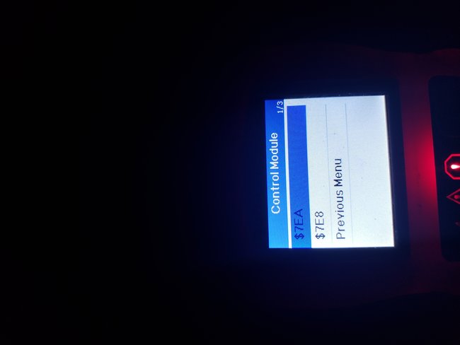

About a week ago the "Engine Hot A/C Off" came up on the dash and the fans kick on as soon as the car starts even after sitting for a couple of days in thirty degree weather. The temperature gauge reads normal and the heat works like it should. The check engine light is on. I have a cheap computer i hooked up and codes $7EA, $7E8 came up but when i hit read codes there is nothing. I have never seen those codes before. I was curious if it could be a bad temp sensor or maybe the thermostat is stuck open.

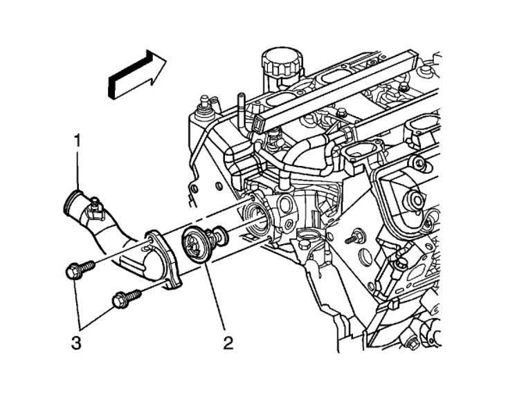

Engine Coolant Thermostat Housing Replacement
Removal Procedure
1. Remove the fuel injector sight shield.
2. Drain the coolant until the coolant level is below the thermostat.
3. Remove the crossover exhaust pipe.
4. Remove the radiator hose from the thermostat housing.
5. Remove the thermostat housing bolts (2) and clean any sealer from the bolt threads.
6. Remove the thermostat housing (1).
7. Remove the thermostat (3).
8. Clean the mating surfaces.
Installation Procedure
1. Install the thermostat (3).
2. Install the thermostat housing (1).
3. Install RTV sealer, GM P/N 12378478 (Canadian P/N 88900041) or the equivalent, to the thermostat housing bolt threads.
Notice: Refer to Fastener Notice .
4. Install the thermostat housing bolts (2).
Tighten the bolts to 25 N.m (18 lb ft).
5. Install the radiator hose to the thermostat housing.
6. Install the crossover exhaust pipe.
7. Install the fuel injector sight shield.
8. Fill the cooling system.
9. Inspect the cooling system for leaks. Repair as necessary.

Even with the engine as cold as the air outside the fans still kick on. I was doing some reading and I found other people have had those same numbers ($7ea, $7e8) pop up. I know they're not codes but there was several other people that have seen them before. In those forums someone mentioned a bad connection for the fan relay or temperature sensor could cause the engine hot ac off light to come on. I was just curious if anyone had a solution before i start going through everything. Thanks for the response.
Oct 28, 2020 at 8:12 AM
When the engine shows high temperature, it will disable the A/C system. That is programmed into the ECM.
If it were the coolant sensor, it would code for it. Since you have no codes, I doubt that is your issue.
Can you take a screenshot of where you see those numbers?

Oct 28, 2020 at 8:24 AM
MELVIND0O92
  • 15 POSTS
This is with the vehicle running. The temperature gauge on the dash never goes above normal while driving down the road or sitting at idle.
Oct 28, 2020 at 8:32 AM
They are not codes, they are systems.

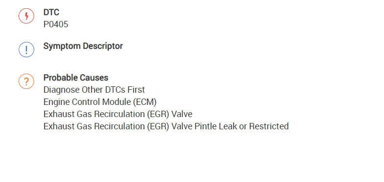

Hello. So I got more info for you. The scanner is saying the engine is running at 203 degrees after running for 45 minutes. Also I got a P0405 code to come up. Not sure if that helps at all.
Oct 29, 2020 at 3:56 AM

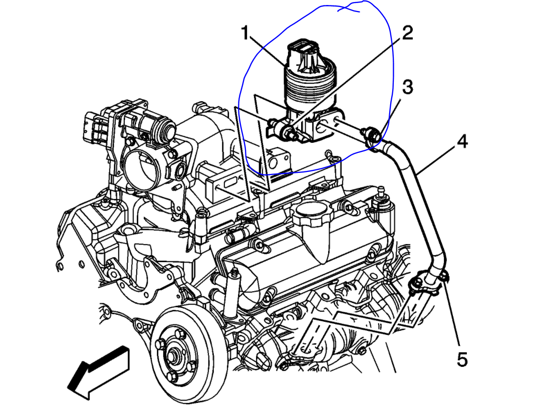

Okay, this code is for the EGR valve. What you need to do is remove the valve and start the engine. You should have a exhaust leak as well as a strong vacuum leak sucking sound.
If you have both of them, replace the EGR valve.
1. Remove the exhaust gas recirculation (EGR) pipe (4).
2. Disconnect the EGR valve electrical connector.
3. Remove the EGR valve bolts (2).
4. Remove the EGR valve (1).
5. Remove the EGR valve gasket.
6. Clean the EGR valve mating surface.
Oct 29, 2020 at 4:04 AM

Okay, thank you. I'm going to go pull the EGR valve and I will let you know what happens.
Oct 29, 2020 at 4:14 AM
You are welcome.
Keep us updated.
Always glad to help.
Oct 29, 2020 at 4:17 AM
MELVIND0O92
  • 15 POSTS
I got it off and it does have a vacuum leak as well as the exhaust leak.
Oct 29, 2020 at 4:48 AM
Then I would replace the EGR valve.
Oct 29, 2020 at 4:58 AM
MELVIND0O92
  • 15 POSTS
Okay. Thanks for the help. It's greatly appreciated. I will let you know what happens when I get the new one.
Oct 29, 2020 at 5:09 AM
MELVIND0O92
  • 15 POSTS
I got the new EGR valve installed last night. So far so good. Thanks for helping me out. Also, for whatever reason the service traction control and service stabilitrak lights are off now as well.
