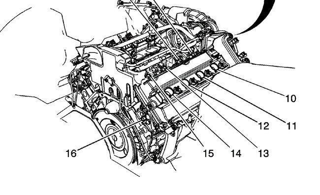

Where is the location of the engine coolant sensor? Engine hot AC off.
Feb 19, 2020 at 8:33 PM
  • 110,194 POSTS
It's on the rear of the cylinder head. See picture 1.

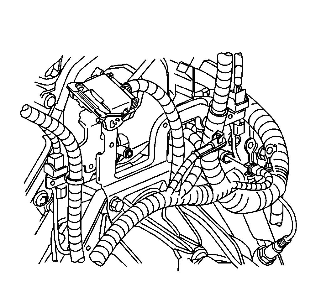

Removal Procedure
Notice: Use care when handling the coolant sensor. Damage to the coolant sensor will affect the operation of the fuel control system.
pic 2
1. Turn OFF the ignition
2. Remove the fuel injector sight shield. Refer to Fuel Injector Sight Shield Replacement (See: Fuel Injector > Removal and Replacement) .
3. Drain the coolant to below the level of the engine coolant temperature (ECT) sensor. Refer to Cooling System Draining and Filling (Static Fill) (See: Cooling System > Removal and Replacement)Cooling System Draining and Filling (GE 47716) (See: Cooling System > Removal and Replacement) .
4. Disconnect the ECT sensor harness connector.

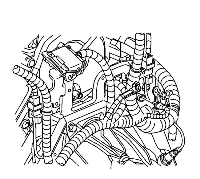

pic 3
5. Remove the ECT sensor.

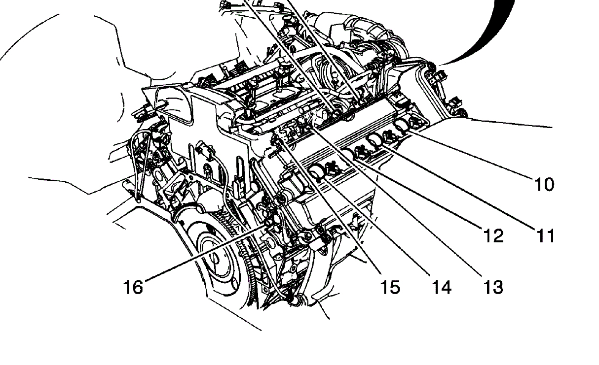

pic 4
1. Coat the sensor threads with sealer GM P/N 1050805, or equivalent.
Notice: Refer to Fastener Notice .
2. Install the ECT sensor.
Tighten the ECT sensor to 20 N.m (15 lb ft).

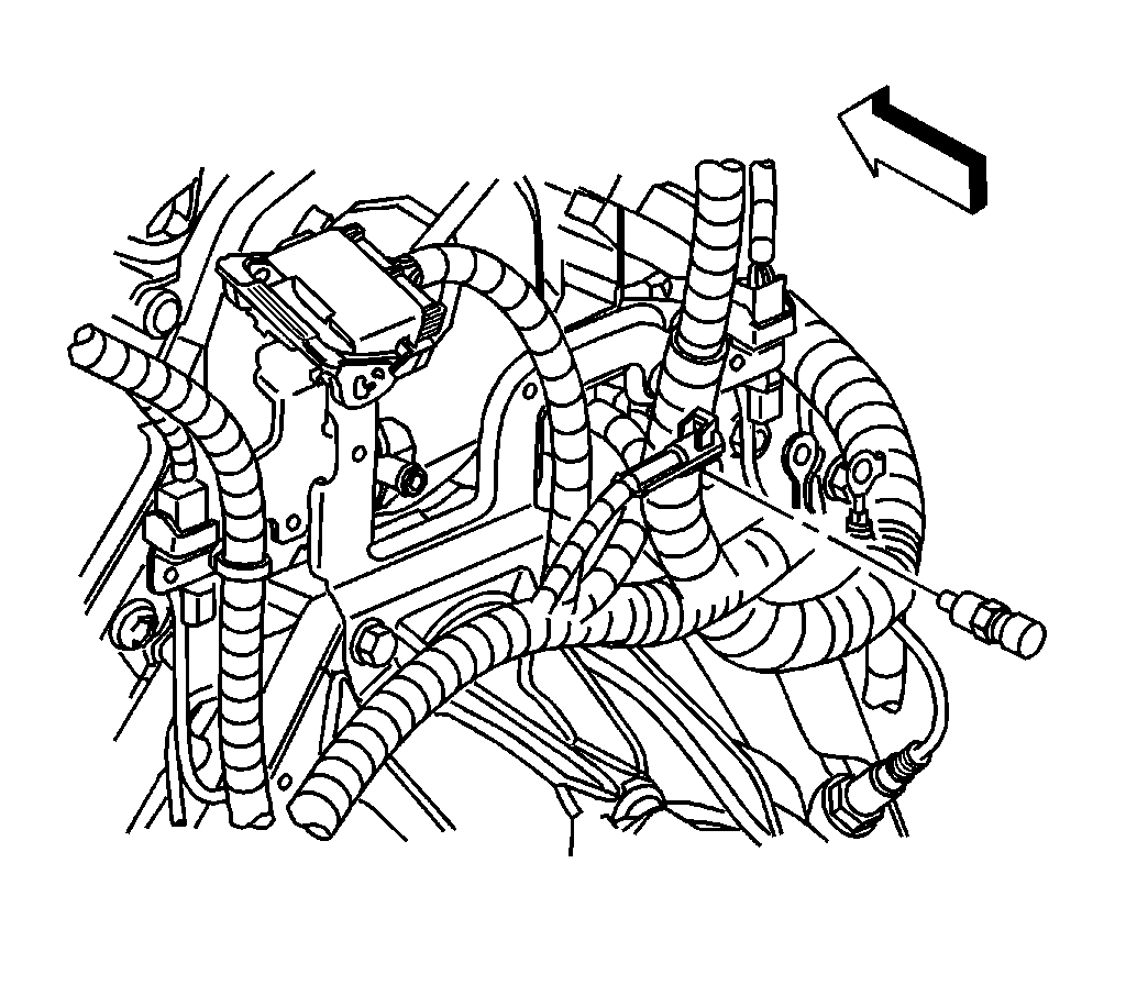

pic 5
3. Connect the ECT sensor harness connector.
4. Install the fuel injector sight shield. Refer to Fuel Injector Sight Shield Replacement (See: Fuel Injector > Removal and Replacement) .
5. Refill the coolant system. Refer to Cooling System Draining and Filling (Static Fill) (See: Cooling System > Removal and Replacement)Cooling System Draining and Filling (GE 47716) (See: Cooling System > Removal and Replacement) .
