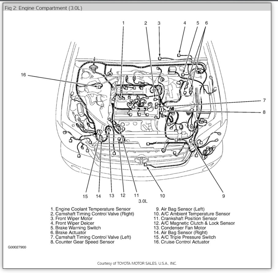

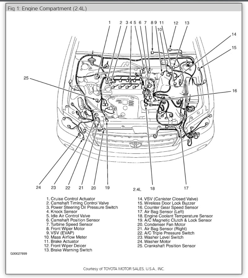

It sounds like an engine coolant sensor is going bad to me. When this sensor starts to go out it will not trigger a check engine light it will just cause problems like the one you have.
Here is a guide that will give you an idea of what you are in for when doing the job:
https://www.2carpros.com/articles/coolant-temperature-sensor-cts-replacement
Below is where it is at on your car both engines featured.
