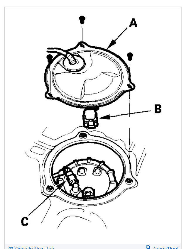

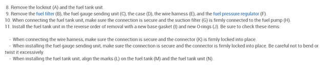

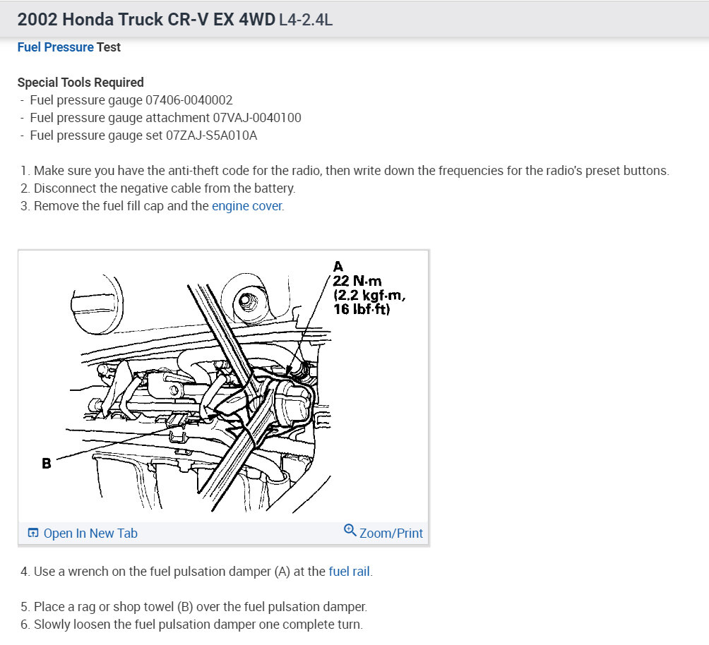

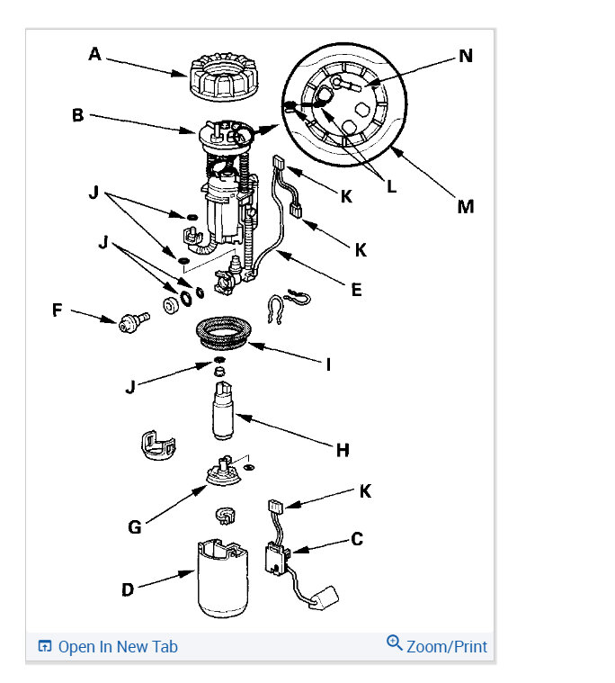

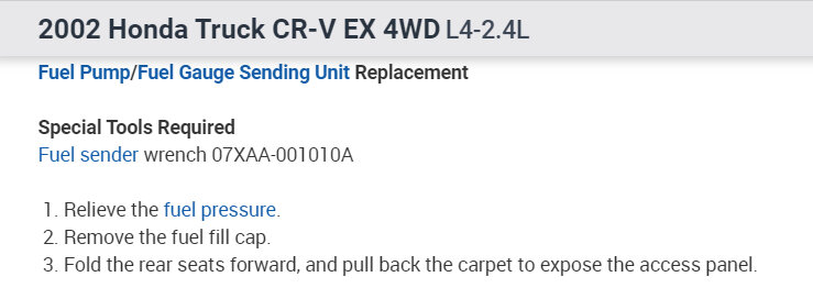

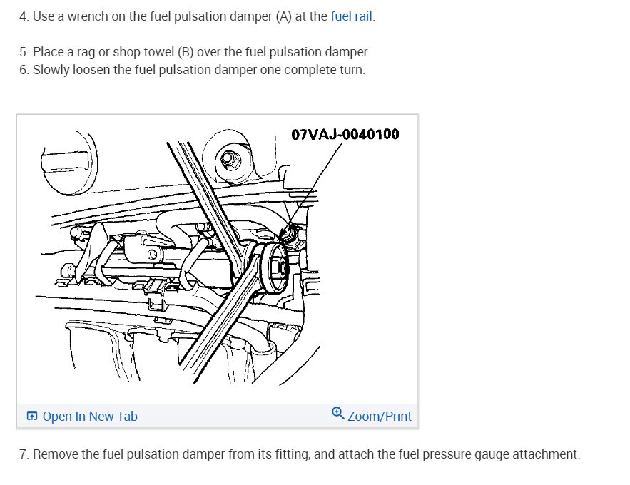

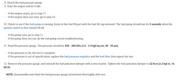

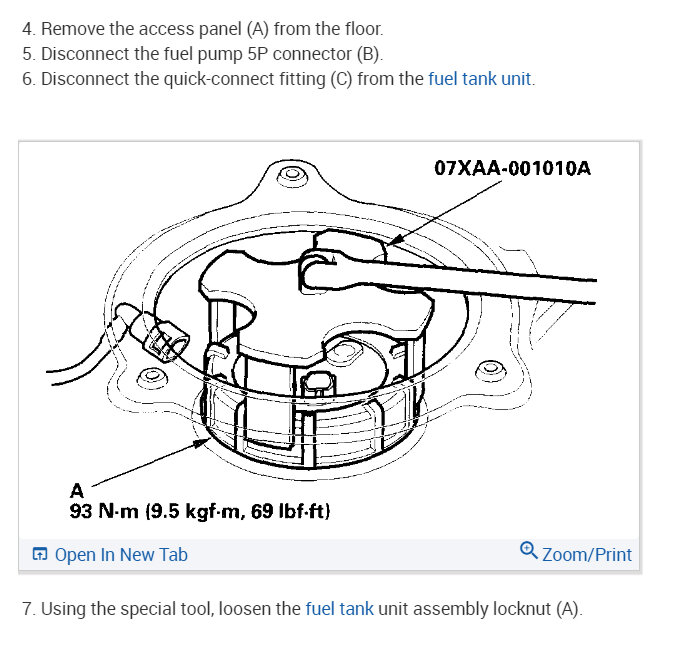

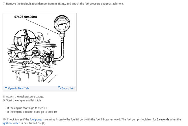

You could have low fuel pressure which is causing it. The pressure should be 330 - 380 kPa (3.4 - 3.9 kgf/sq.cm, 48 - 55 psi). Please check the images below on how to test the fuel pressure and change out the fuel pump.
