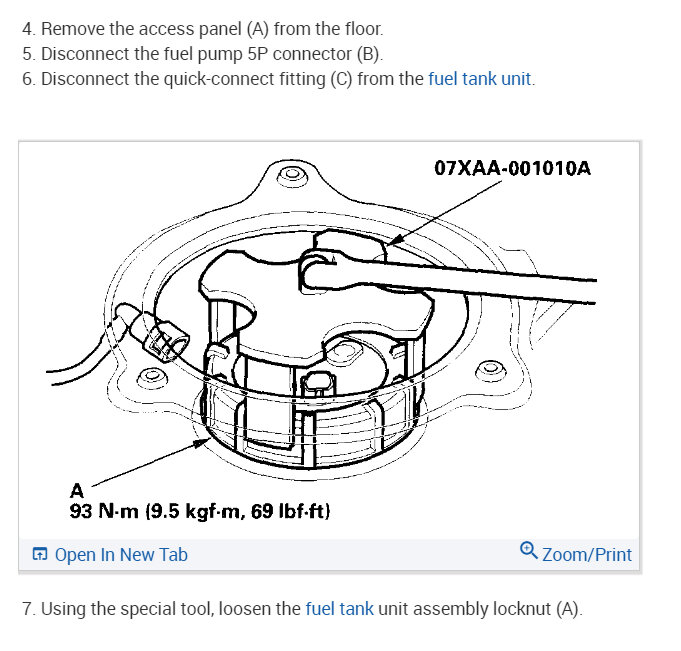

We need to run the codes first to see what's going on, also I would check the engine for vacuum leak by following these guides, please check the engine when it is cold only.
and

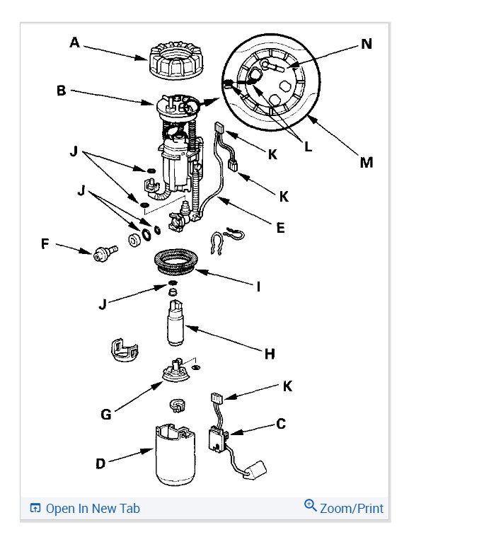

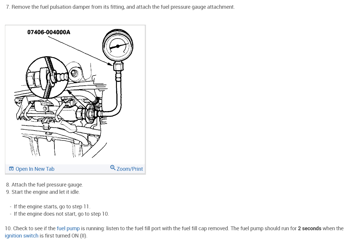

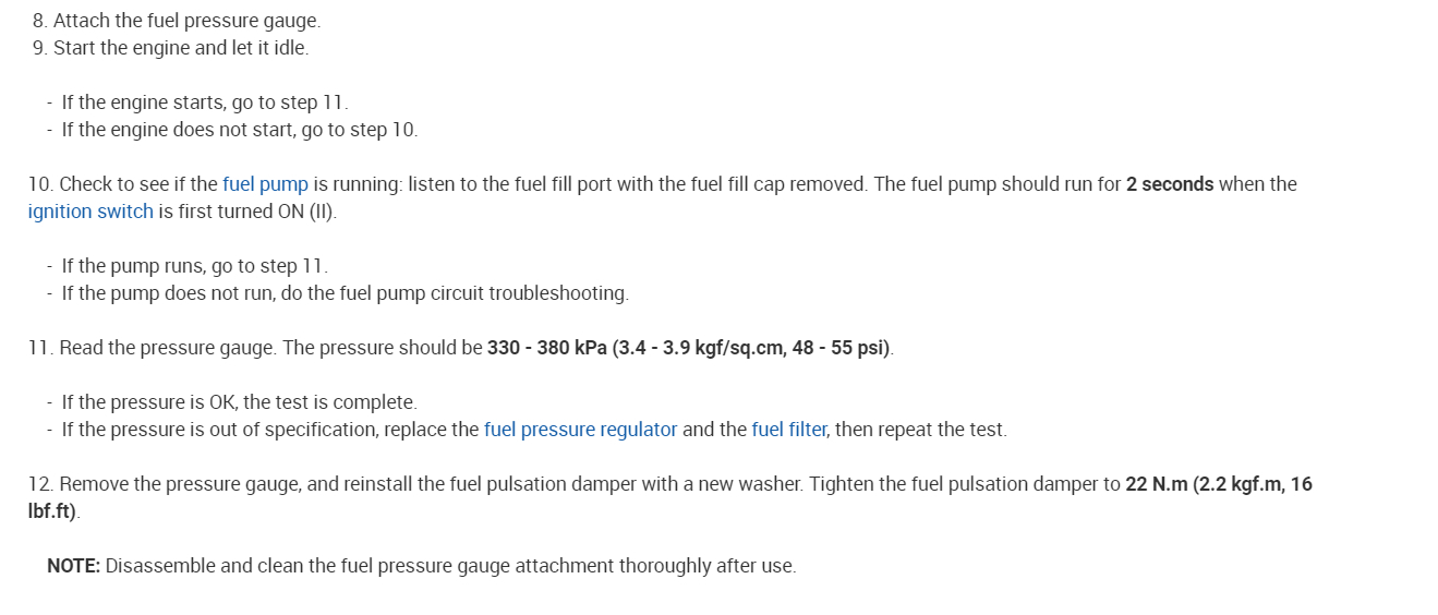

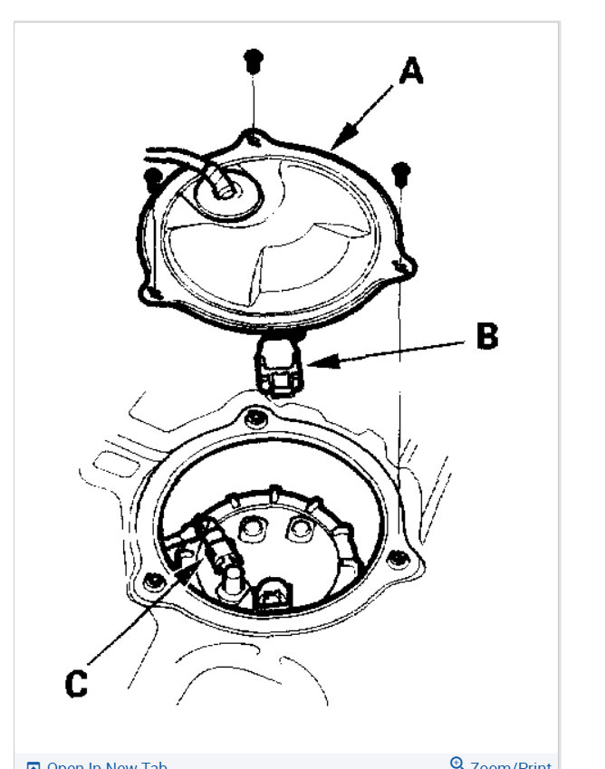

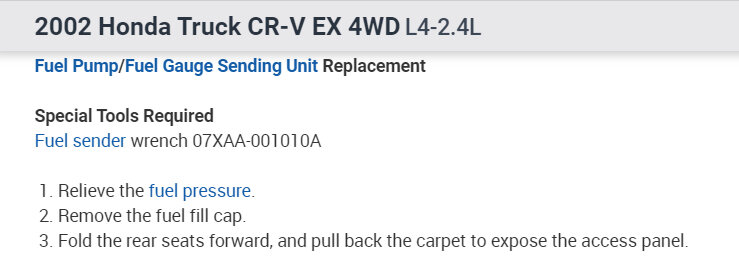

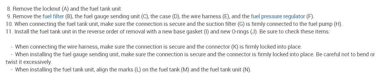

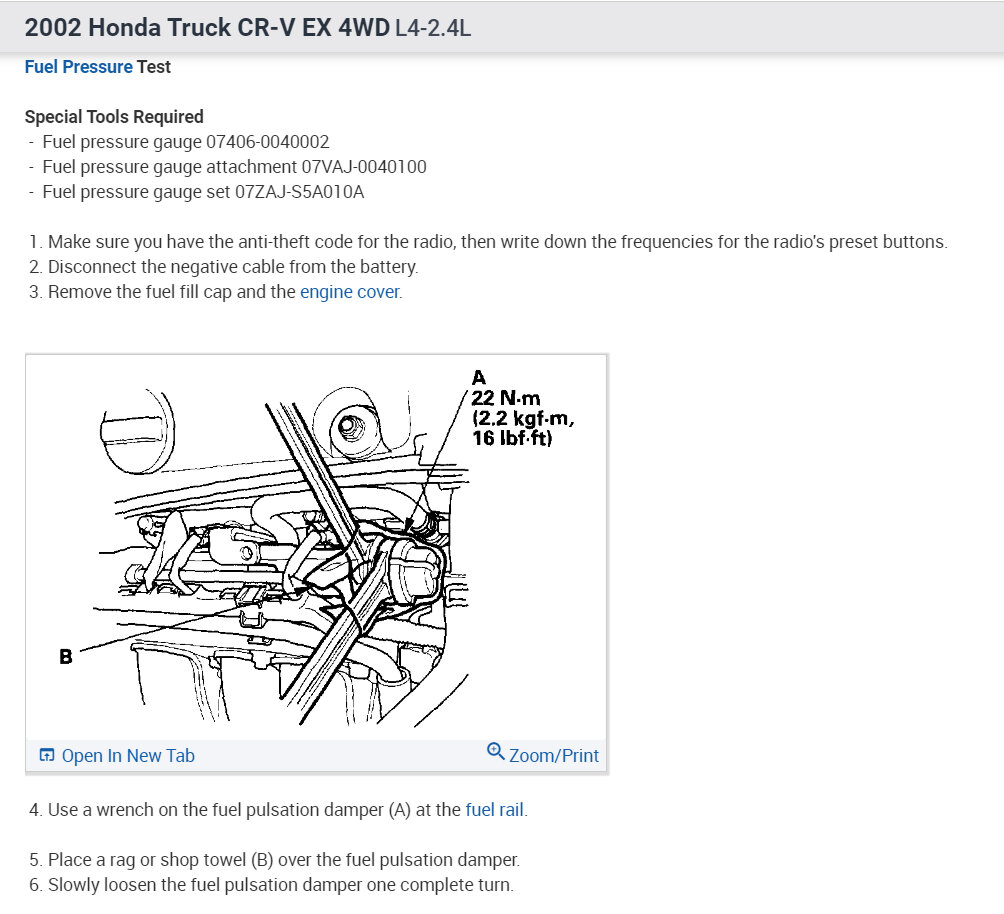

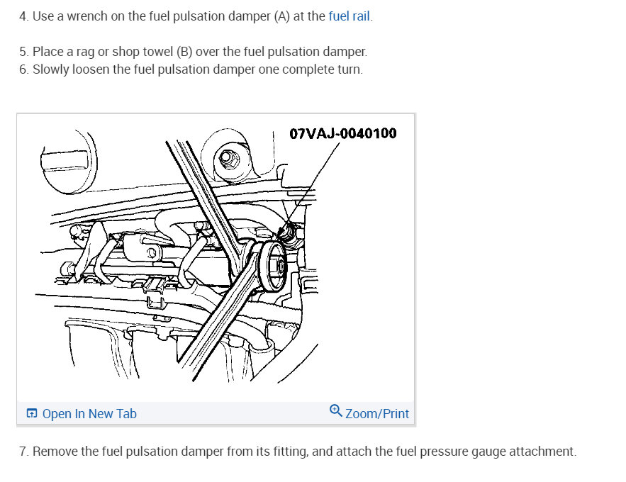

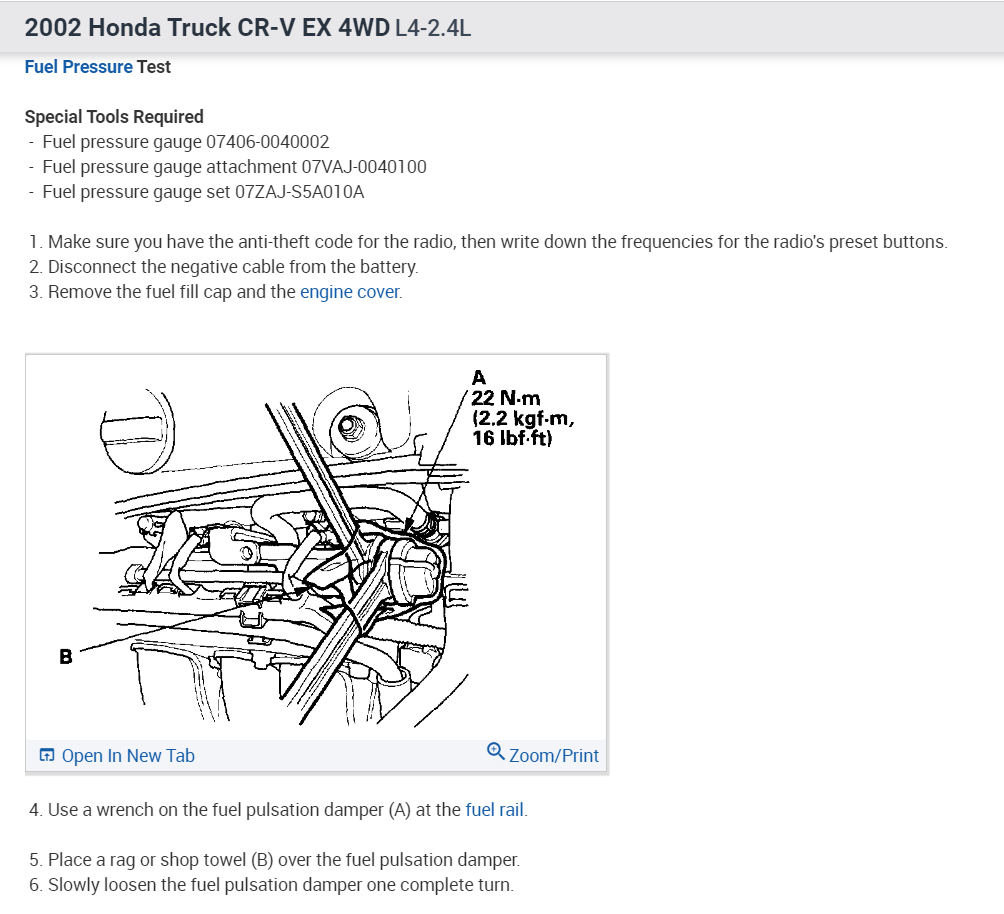

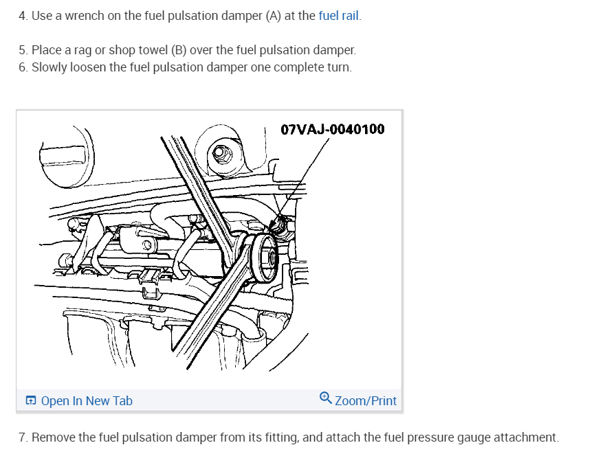

You could have low fuel pressure which is causing it. The pressure should be 330 - 380 kPa (3.4 - 3.9 kgf/sq.cm, 48 - 55 psi). Please check the images below on how to test the fuel pressure and change out the fuel pump.
