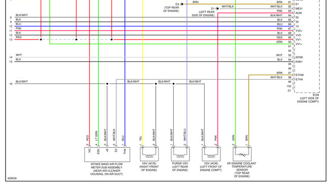

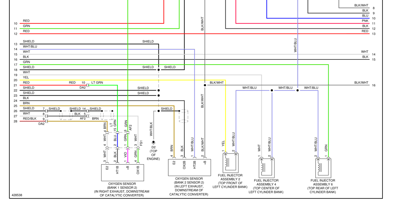

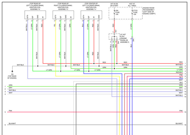

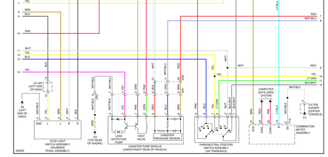

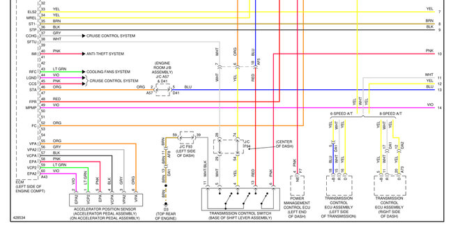

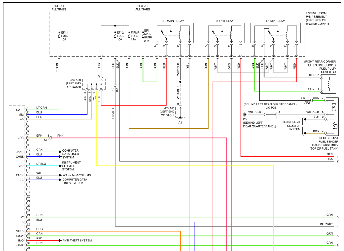

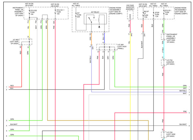

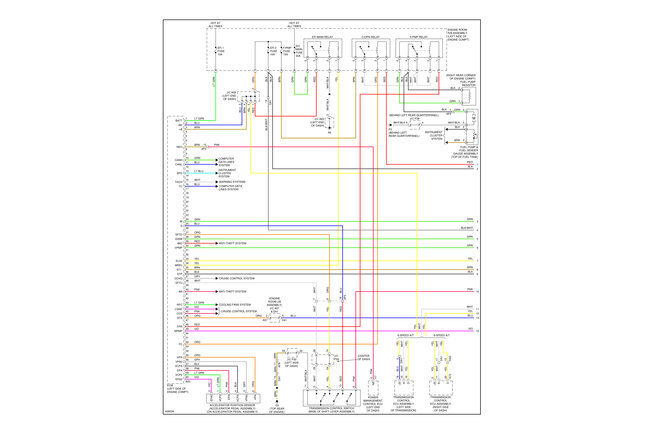

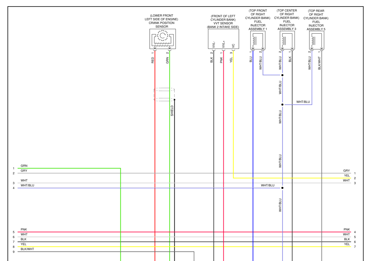

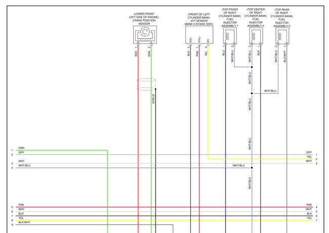

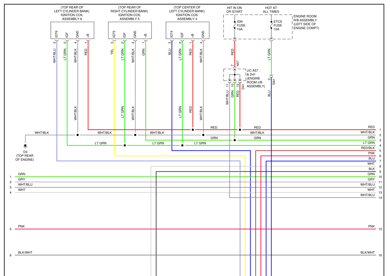

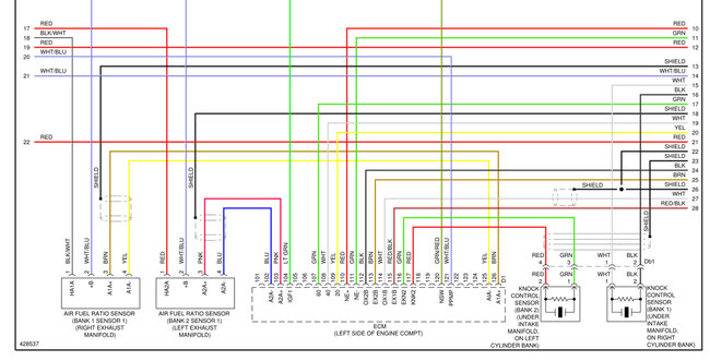

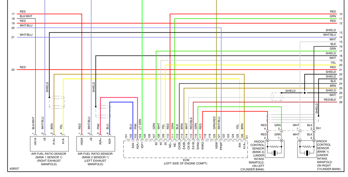

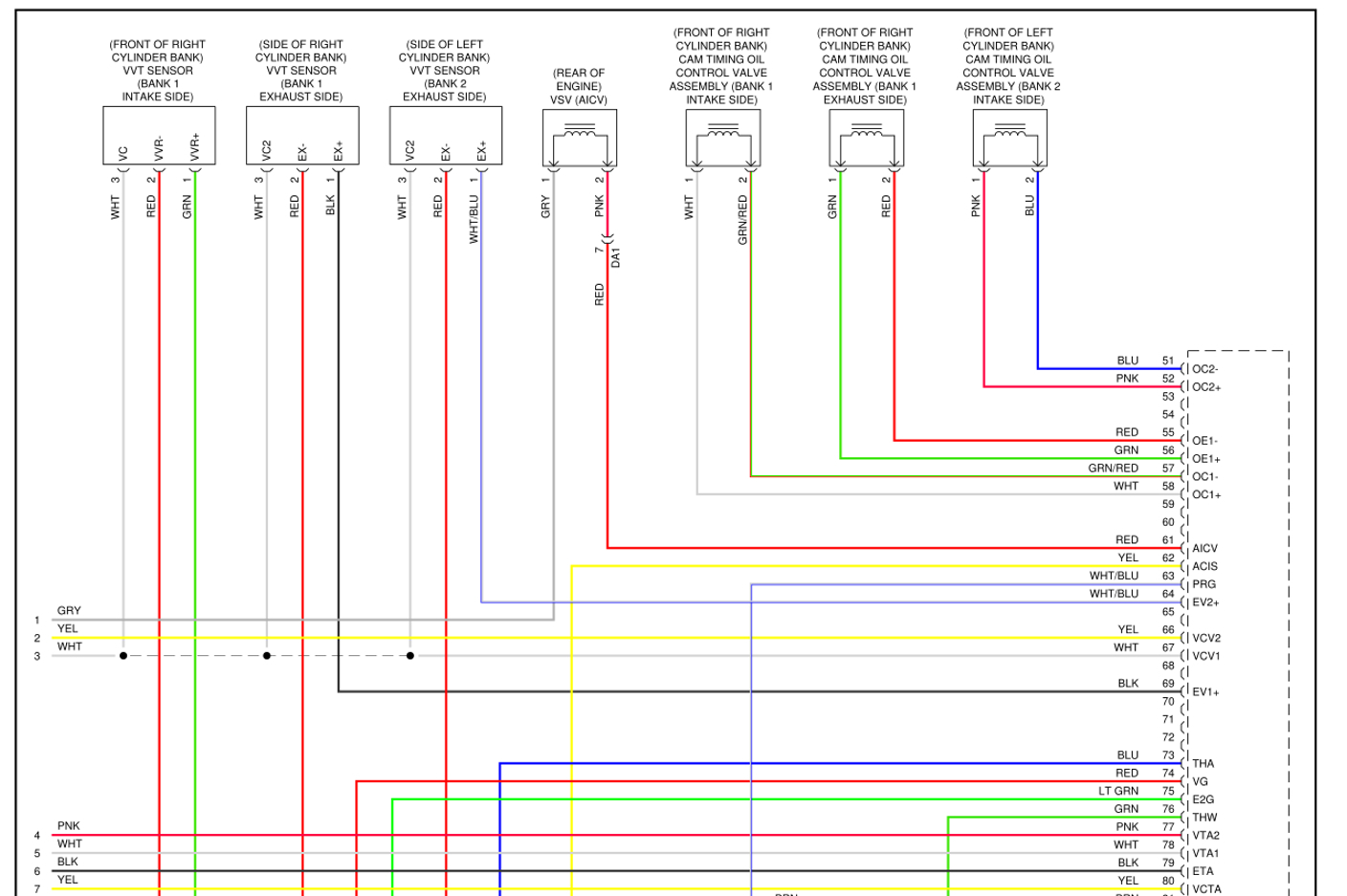

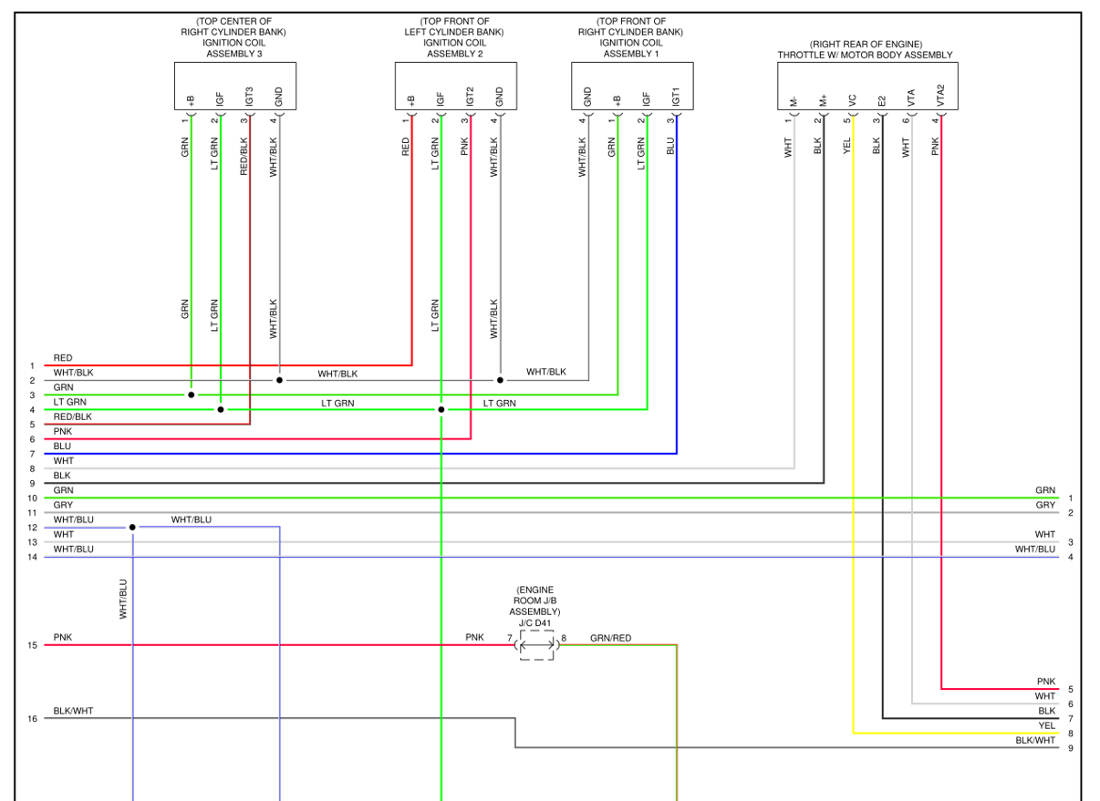

The engine is hesitating when accelerating, I have scanned the vehicle but there are no fault codes on the Engine. I have checked the spark plugs and the fuel injectors, fuel pump and they are in good condition.
Please could I get the engine performance wire diagram.

Most common causes for hesitation under acceleration/load is a high-tension issue.
This could be caused by arcing ignition coils or spark plugs.
It could also be caused by bad fuel, blocked fuel or air filter.
A good link regarding possible causes for hesitation:
https://www.2carpros.com/articles/engine-hesitates

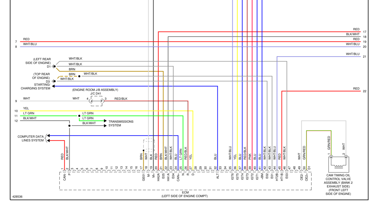

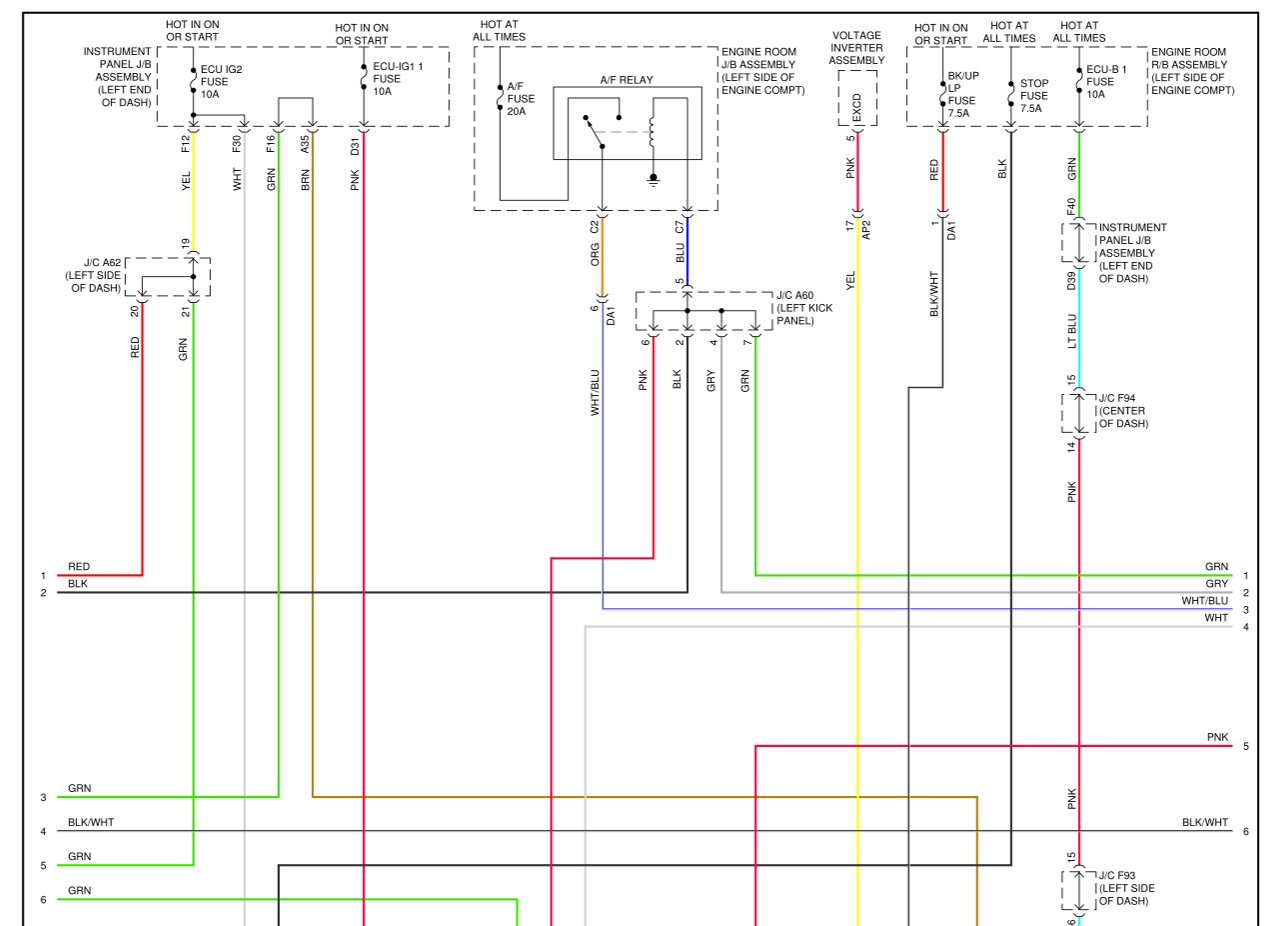

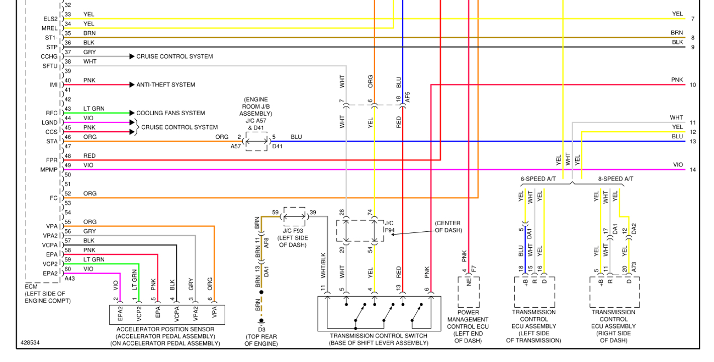

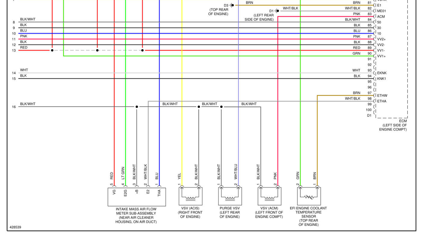

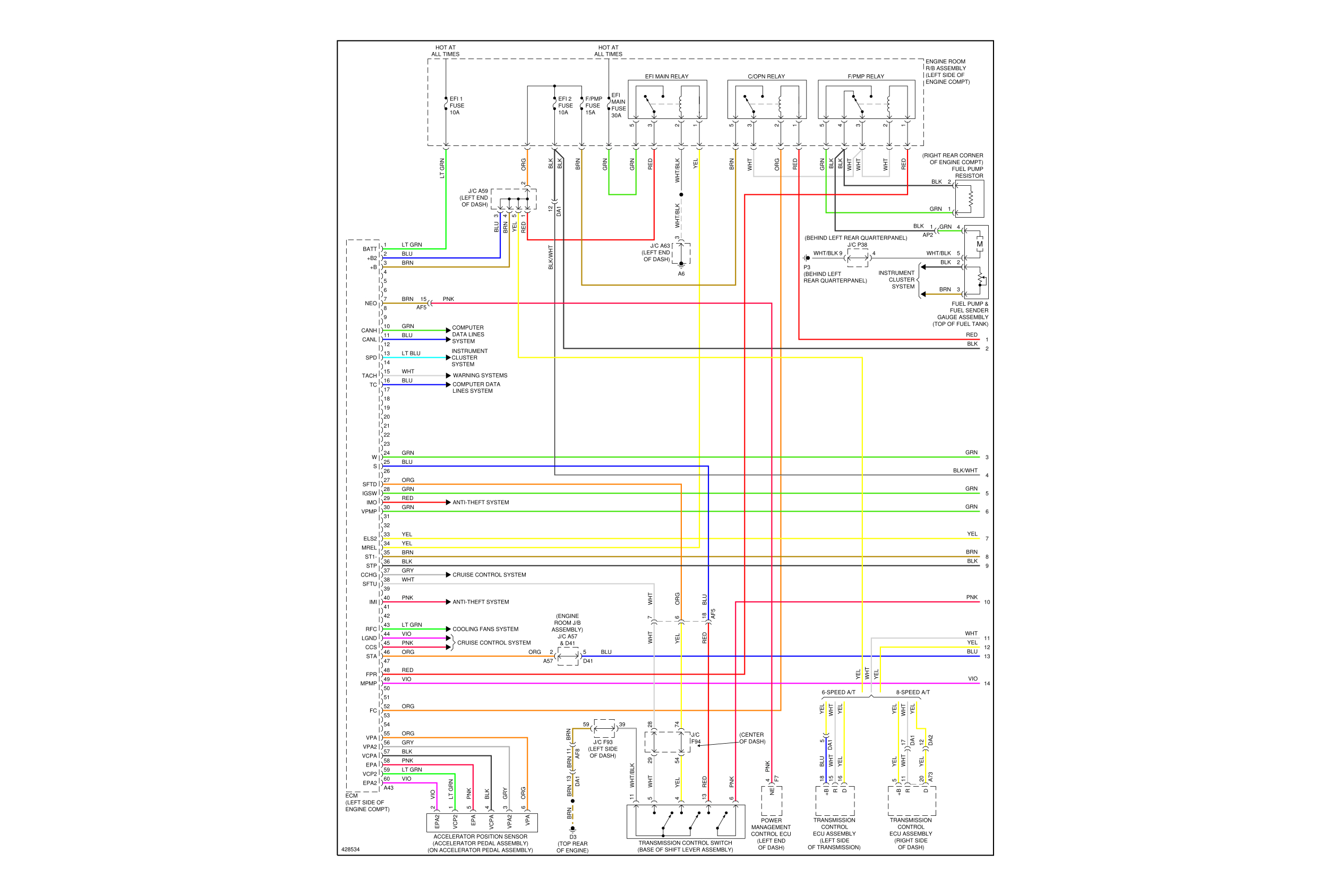

Please see images below regarding the requested diagrams.
I had to cut the images and enlarge them for better display.
Cheers, Boris
