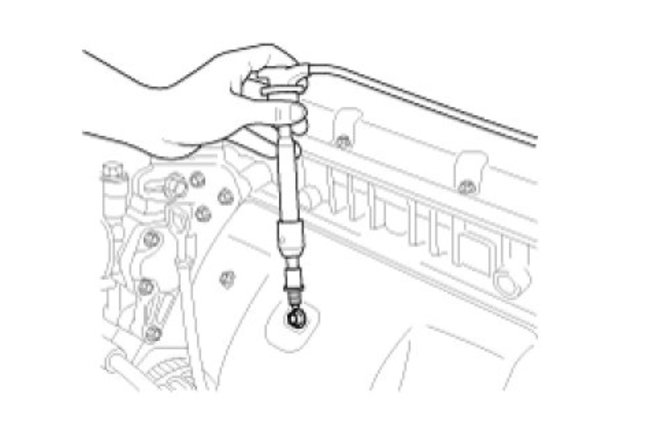

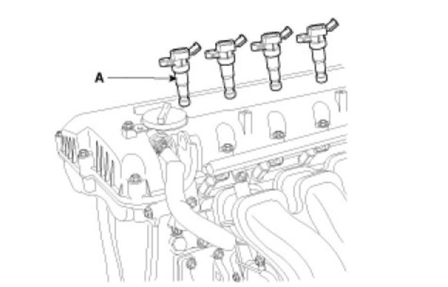

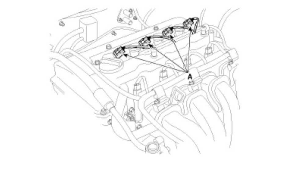

Probable causes could be ignition wiring, spark plugs and spark plug cables, I'm attaching repair guides and component location below. Let us know if you need more information.

Thanks, will go for the spark plug replacement.. as for this symptoms i notice as well when i press the gas pedal i could hear a like a misfire from the exhaust(it's not like a constant flow of the exhaust) have to press the gas pedal hard to be able to get the car moving. it's like a lack of power.

A 4 cylinder engine if it drops a cylinder because loss of spark it would definitely have low power. I feel your going to see a big improvement after the tune up. Please let us know how everything turns out.

Hi Joe, just for an update: I have replace the spark plugs as well as service the car air filter etc. now the car is running smooth no hesitation from the engine.
Many thanks for the advice.
