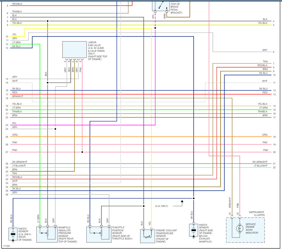

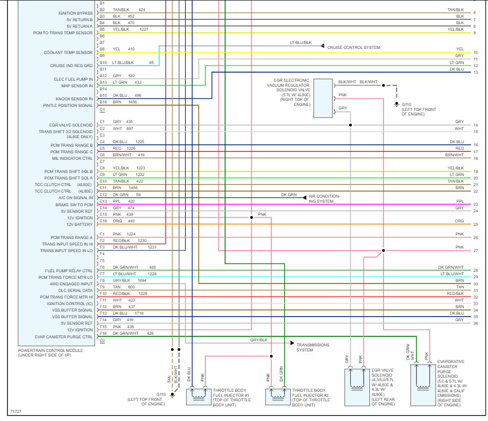

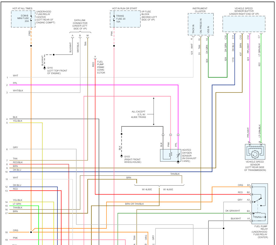

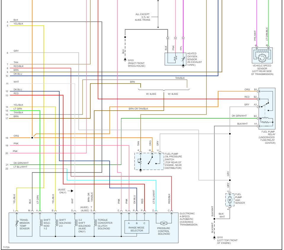

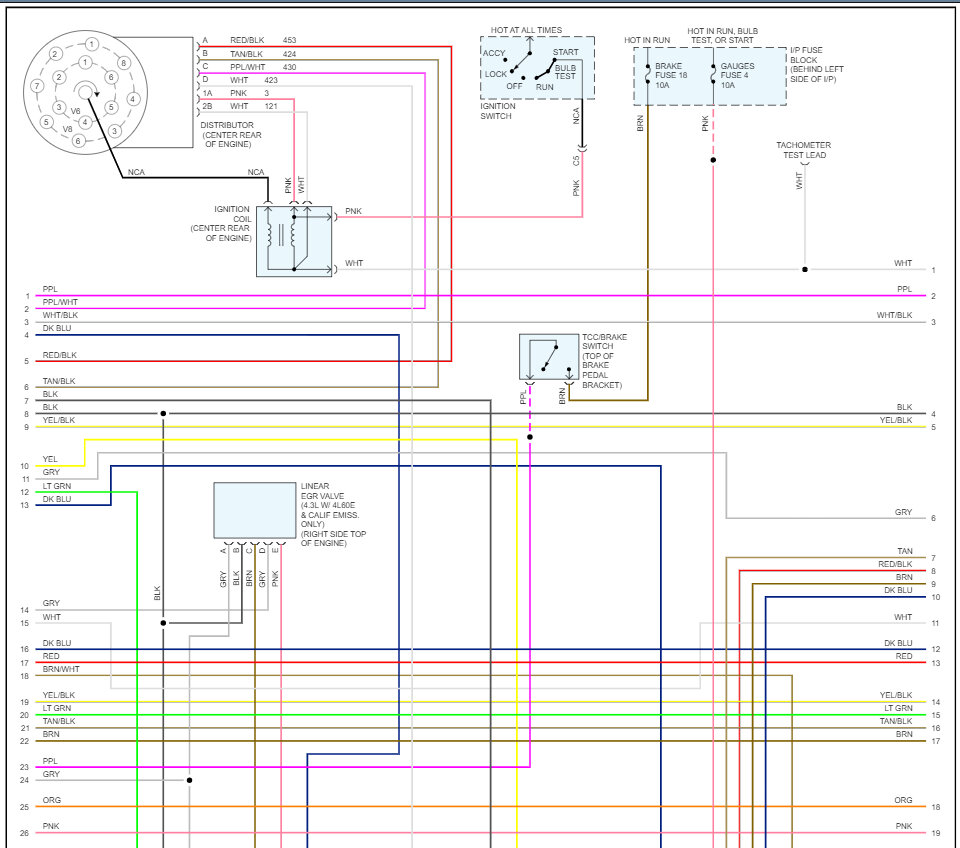

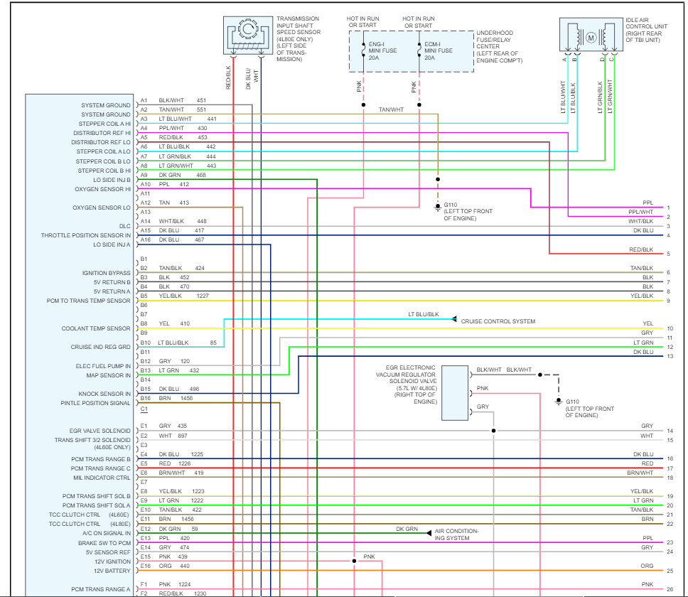

Sure, here are the engine wiring diagrams so you can see where the connectors go. Check out the images (below). Please let us know if you need anything else to get the problem fixed.
