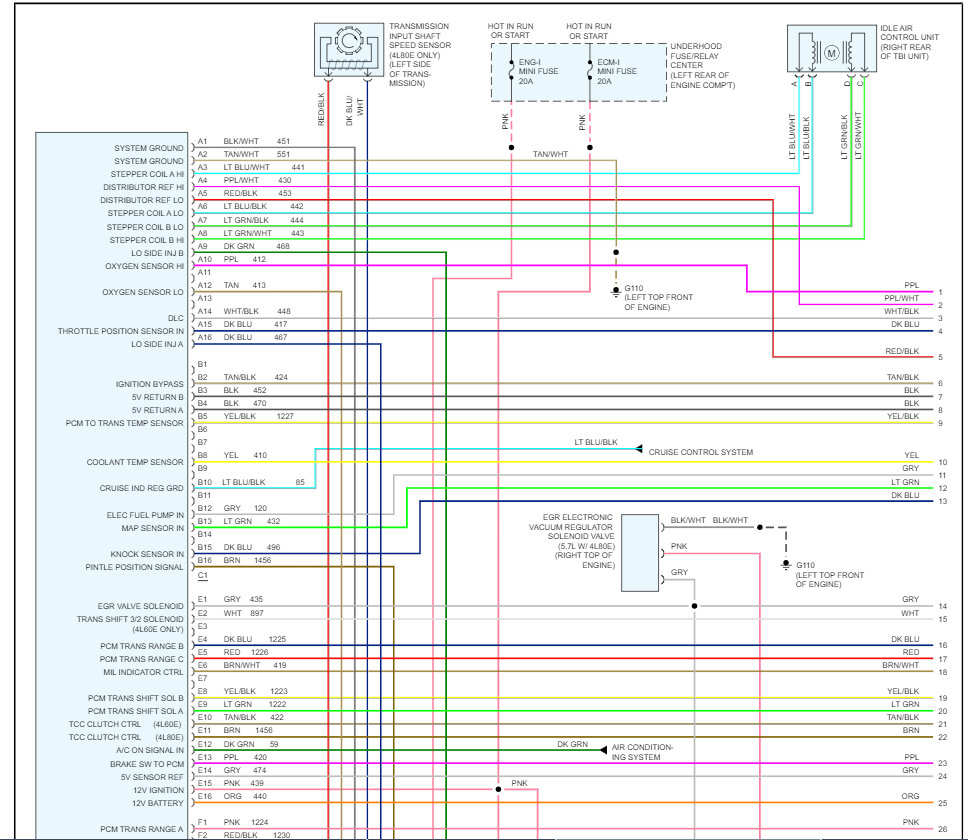

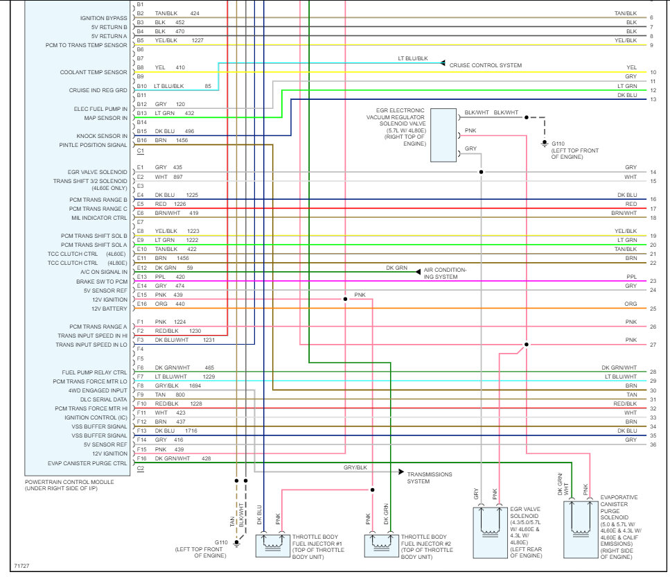

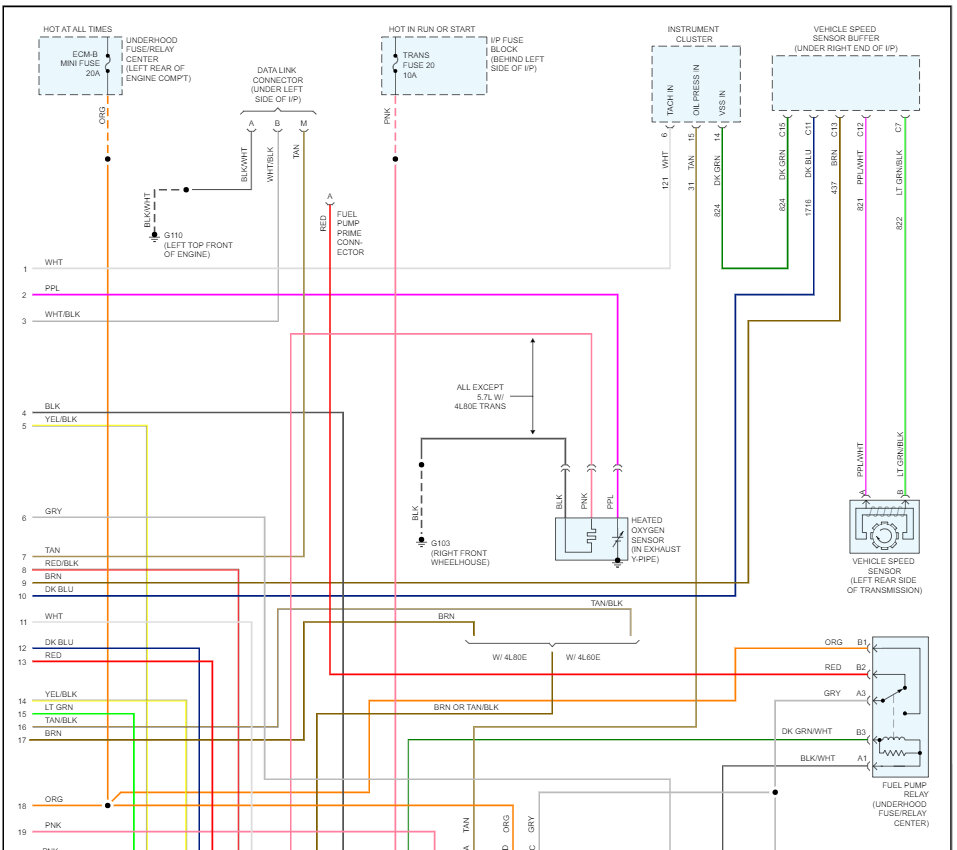

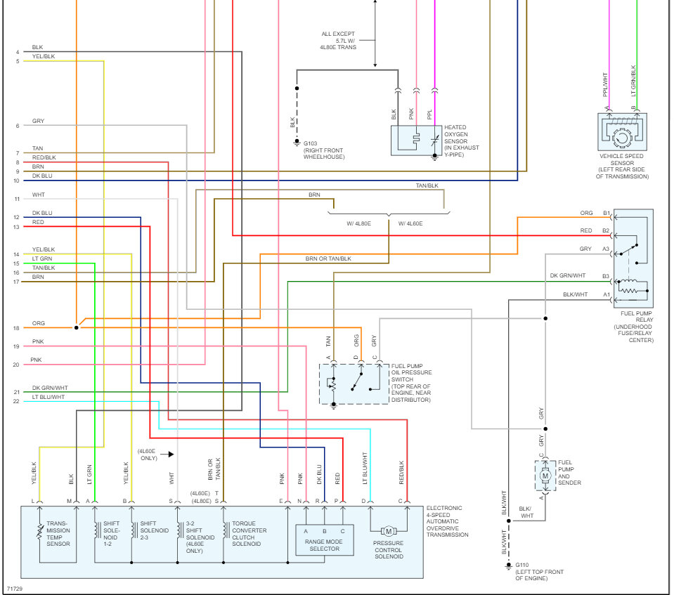

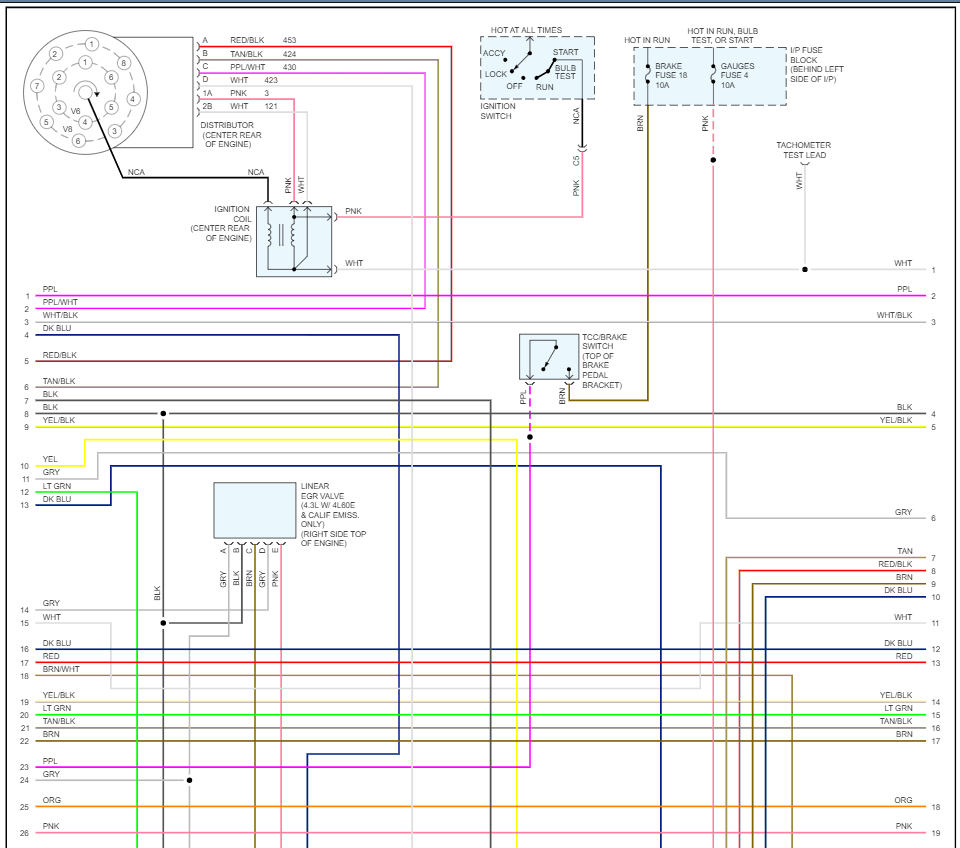

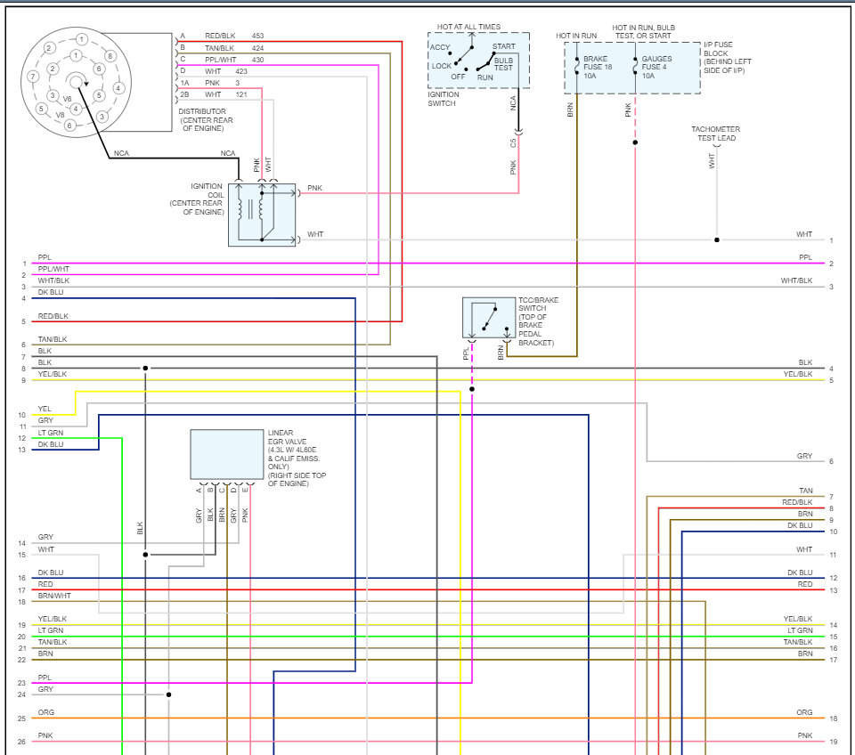

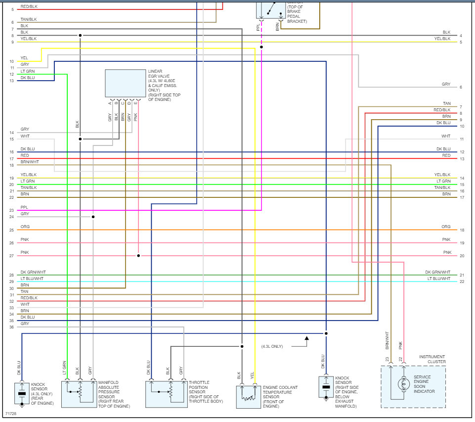

1995 Chevy c1500 4.3 tbi vortec
I took the engine harness off and swapped motors and can’t remember how the harness goes in and can’t find anything about it

Sure, here are the engine wiring diagrams so you can see where the connectors go. Check out the images (below). Please let us know if you need anything else to get the problem fixed.
