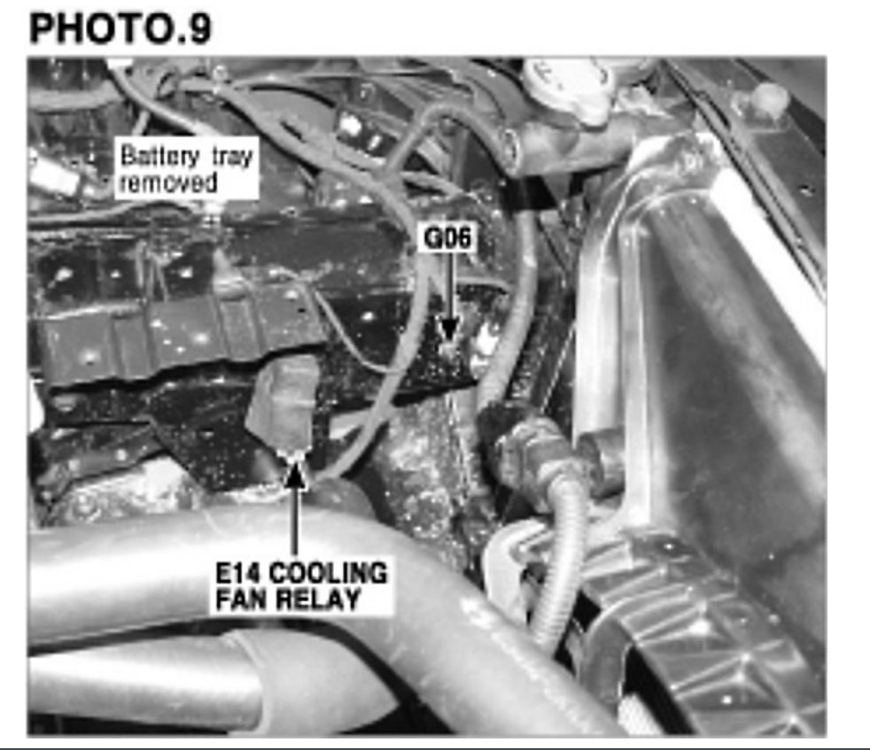

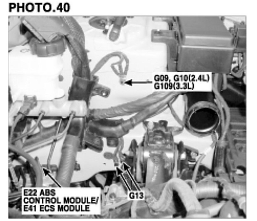

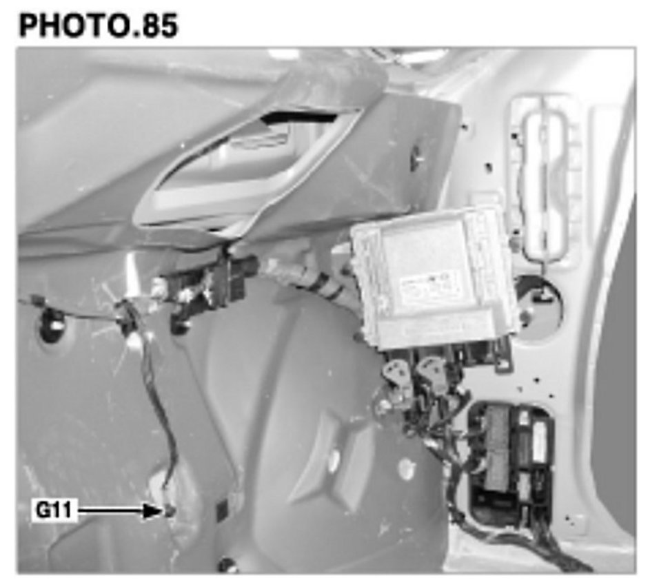

Where is the engine ground wire located?
87,720 MILES • 2.4L • 4 CYL • 2WD • AUTOMATIC
DYLAN MICHAEL
I need to know where the engine ground wire is on the car listed above.
May 2, 2022 at 10:47 AM
  • 55,852 POSTS
It looks like there are three main engine grounds, I have included the location in the diagrams below. Check out the diagrams (below). Let us know what happens and please upload pictures or videos of the problem.
