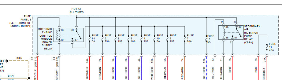

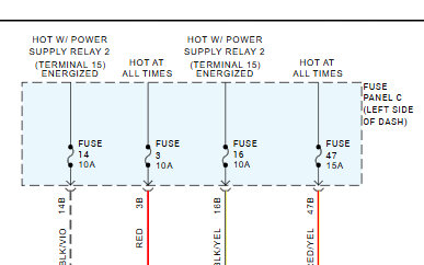

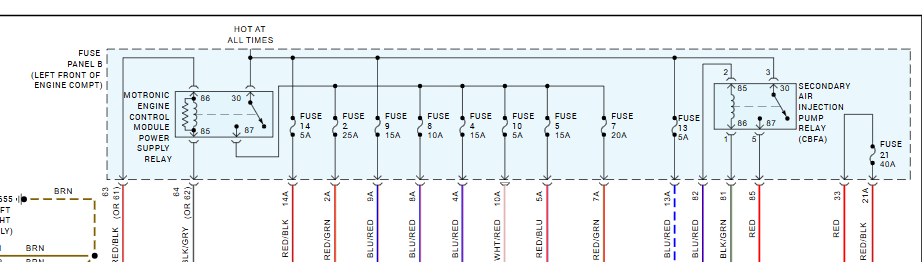

Can I get the Engine fuse diagram?
2012 VOLKSWAGEN JETTA GLI
131,889 MILES • 2.0L • 4 CYL • 2WD • AUTOMATIC
KIMBERLY DAVIS
Can't find engine fuse diagram. Do you have one?
Dec 26, 2024 at 2:40 AM
  • 55,381 POSTS
Hello Kim,
Yes, here are the fuses that run the engine and PCM. There are 14 fuses that run the system, please test the fuses with the ignition system on. here is a guide to help you as well:
Check out the images (below). Let us know how it goes.
