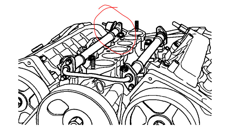

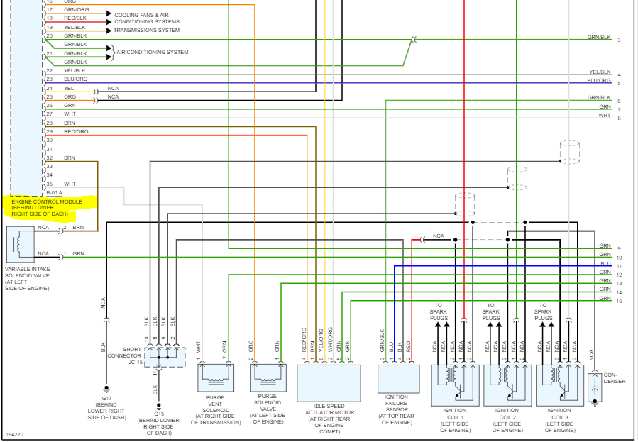

This vehicle seriously overheated and burned cylinder seal (gasket) and also blown radiator. So, it was admitted in my workshop, and I disassembled the cylinder head and replaced the cylinder gasket. I reknit the valves and replace the valve oil seal. I began to crank; it took a long time before it finally cranked. 20 minutes after it cranked and idled, I began to see black smoke and I diagnosed and detected P1520: intake manifold runner malfunction. When I went to check the location and the vehicle stall, when I tried to crank, it failed to crank, and I removed the engine oil dipstick and only to see that fuel had flooded the engine and mixed with engine oil. I checked to see if will get fuel pressure regulator, I didn't see, and I also checked to see if there is Oxygen sensor code. There was none. Then what could be the cause of this engine flooding?

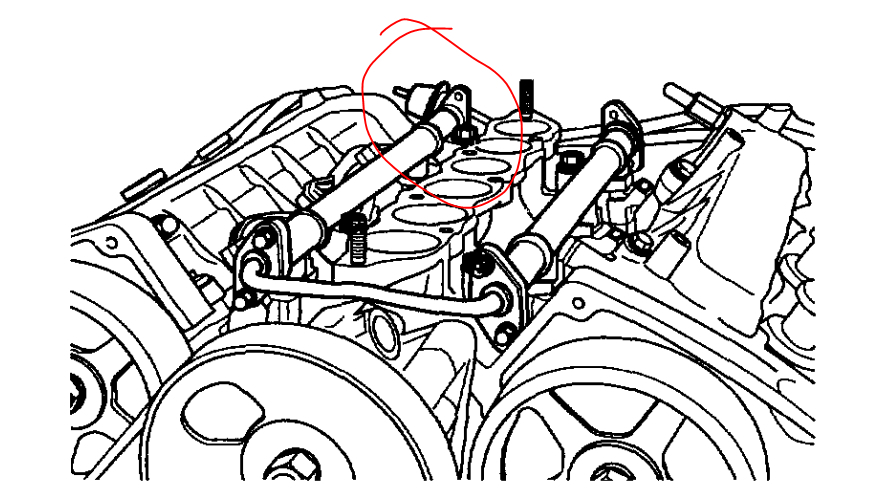

The code, P1520, isn't relevant for this year, make, and model. At least, I can't find anything in the manuals. I do realize it is a runner control code for other models.
The first thing I would suggest is to check fuel pressure. If it is excessive, then check to see if the fuel pressure regulator was left disconnected. It is under the intake manifold.
I attached a pic below and circled the regulator. If possible, see if you can see it using a mirror to determine if it is disconnected.
Let me know what you find.
See pic below.

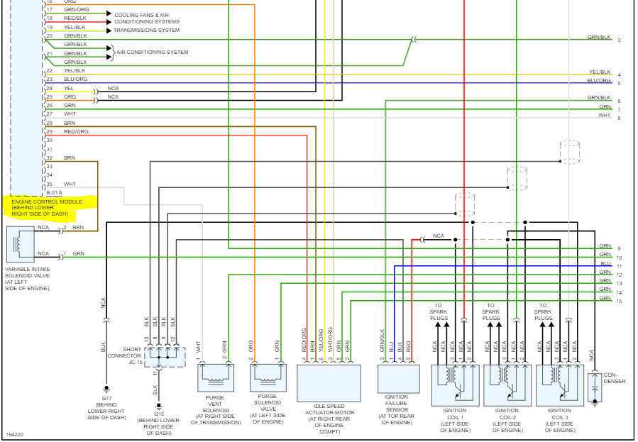

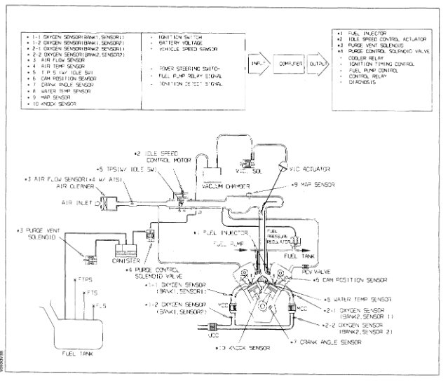

I want to ask?
1. Can it be possible for a sensor that was not equipped on vehicle to display a fault?
2. That vehicle is 2004 and that intake manifold runner is it a vacuum type of a sensor type?
3. Can I get ECM to engine sensor diagram to confirm if it was equipped?
I need your response.
Thanks
Aug 30, 2022 at 7:50 PM
  • 110,251 POSTS

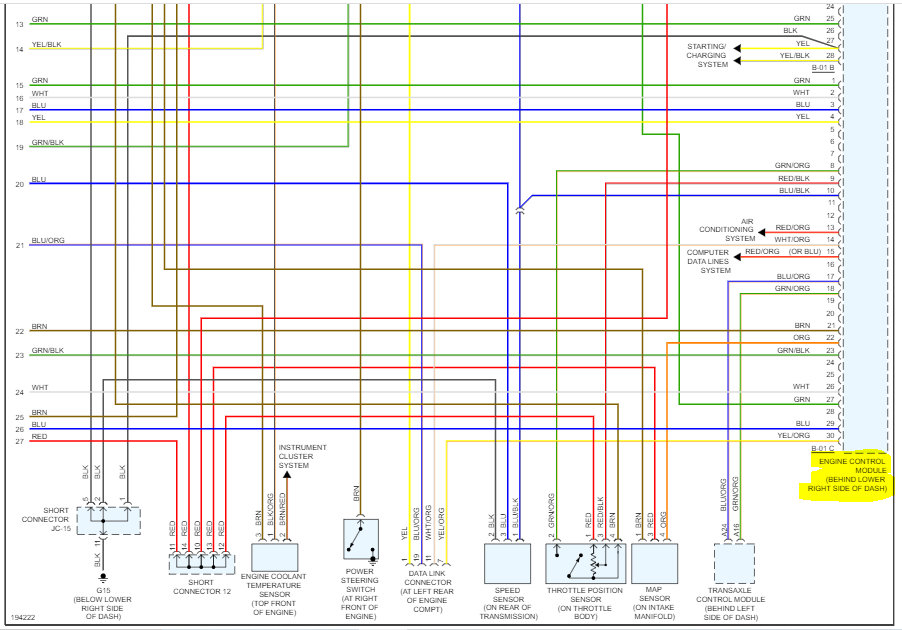

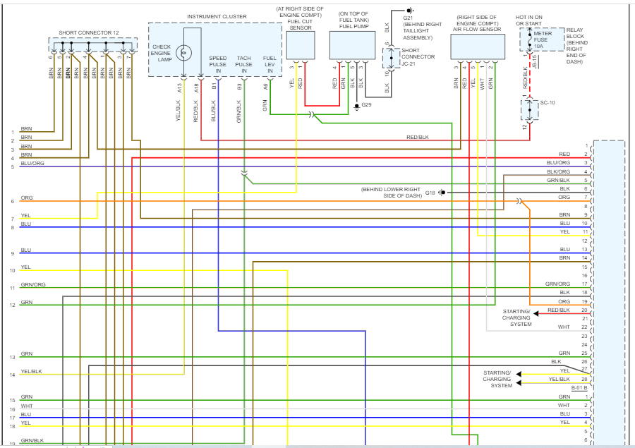

You shouldn't get a code if the vehicle wasn't equipped with a specific sensor. The runner is vacuum controlled. Low to medium speed torque is boosted with the variable intake manifold controlled by the ECM via a Variable Intake Control System. (VICS). The VICS consists of an actuator (operated by engine vacuum) and a solenoid that is turned ON (open) or OFF (closed) by the ECM (ground controlled) to allow the vacuum to operate the VICS actuator. A vacuum chamber with a check valve is fitted to ensure a stable supply of vacuum to the VICS actuator. The system is designed to direct intake airflow through long runners below 3500 100 RPM. Above 3500 RPM, the ECM activates the vacuum control solenoid, which in turn allows the manifold vacuum to operate the VICS actuator; intake airflow is then redirected through shorter intake runners.

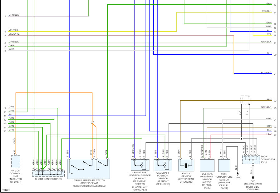

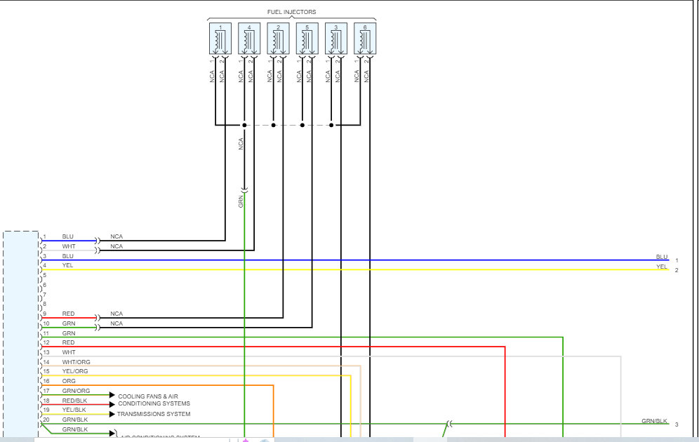

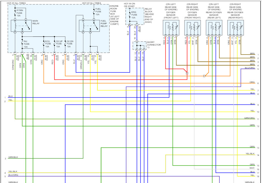

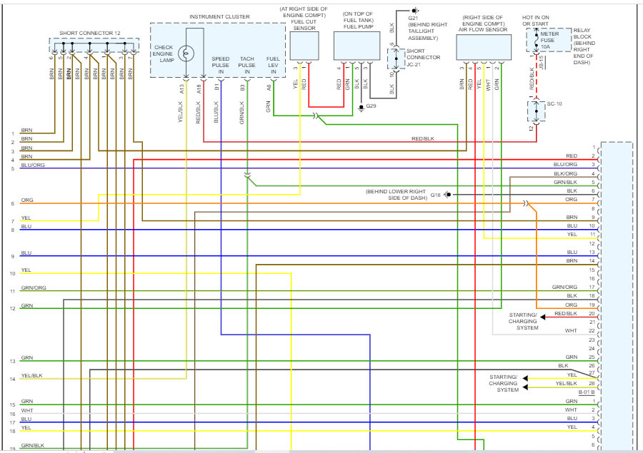

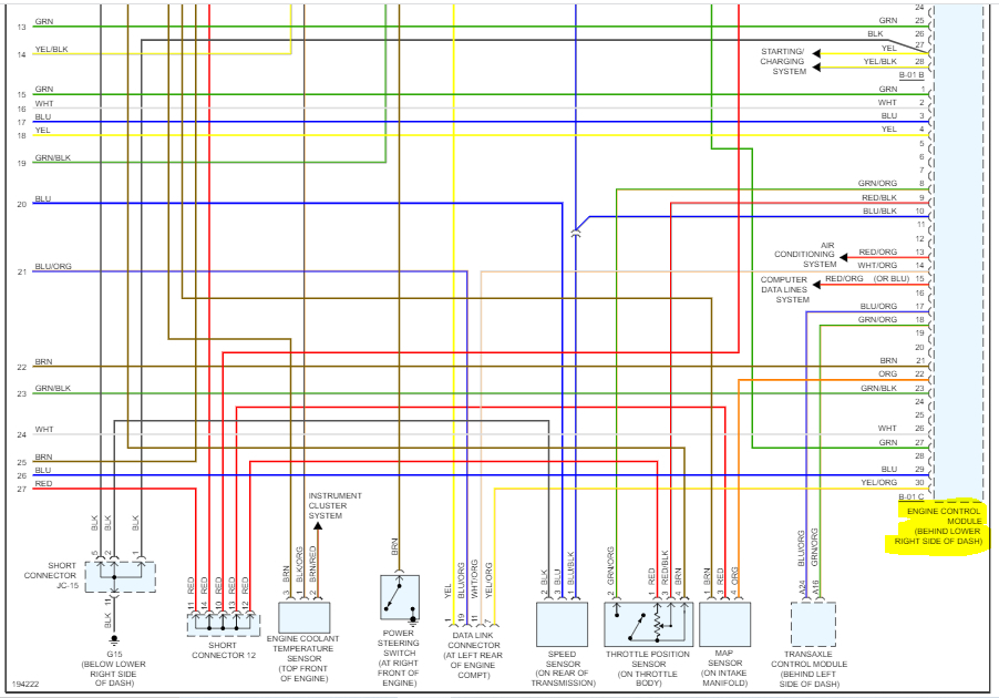

As far as the ECM schematic, I attached the entire powertrain management system circuit below. It was 3 pages long. I had to cut each pic in half to make it readable. I did overlap them for you.
Let me know if this helps.
Aug 31, 2022 at 11:02 AM

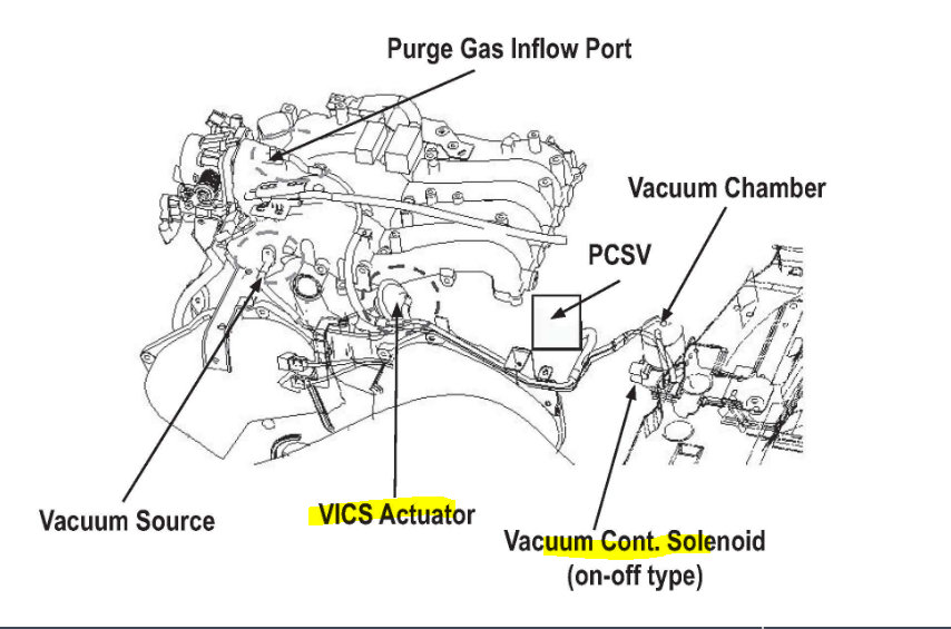

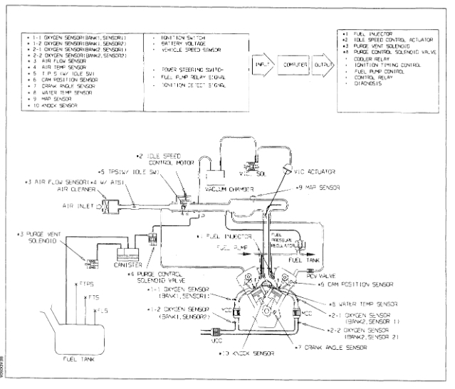

Can I see the location of VICS Actuator and vacuum control solenoid?
Aug 31, 2022 at 5:17 PM
  • 110,251 POSTS
If you take a look below, I highlighted each of them for you. Let me know if this helps or if you have other questions.
Sep 1, 2022 at 12:01 PM

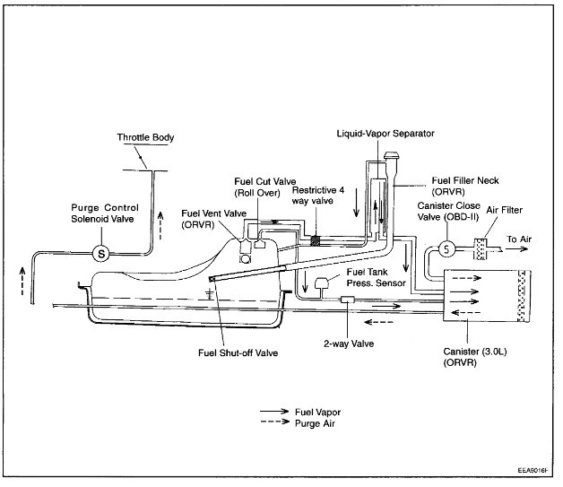

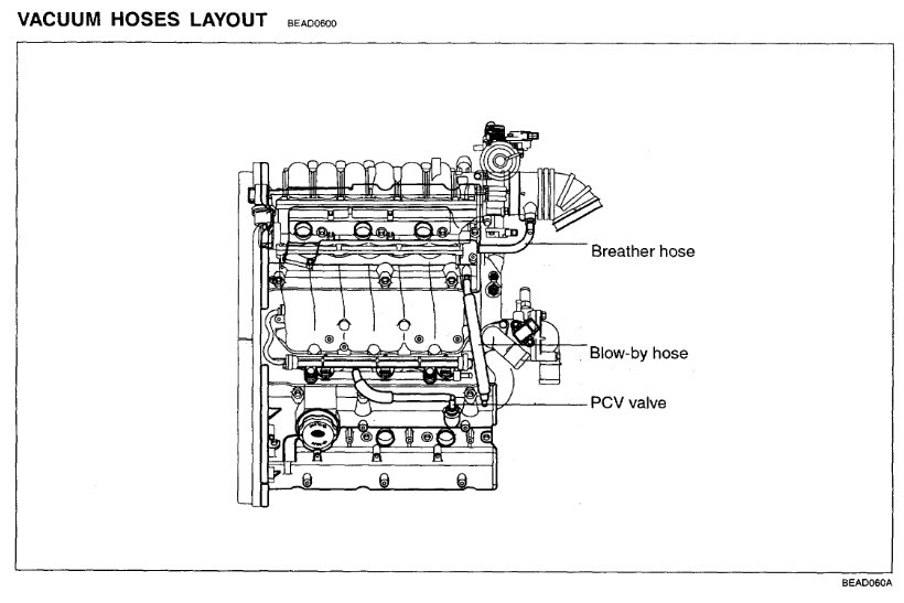

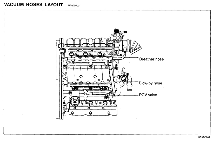

Can i get complete vacuum diagram of this vehicle to check the correct routing?
Sep 28, 2022 at 6:09 AM
  • 110,251 POSTS
I attached everything I have specific to this vehicle. Take a look through them and let me know if they help. Also, here is a link you may find helpful:
