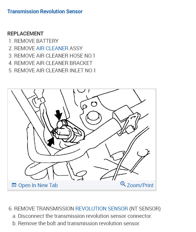

Good evening, sir,
The vehicle transmission, when it is upshifting from gear 1 to 2, it upshifts properly, from 2 to 3, the engine flares up before it upshifts. I have replaced the valve body with solenoids but the problem still persists, the are no codes on its memory.
What could be the cause?

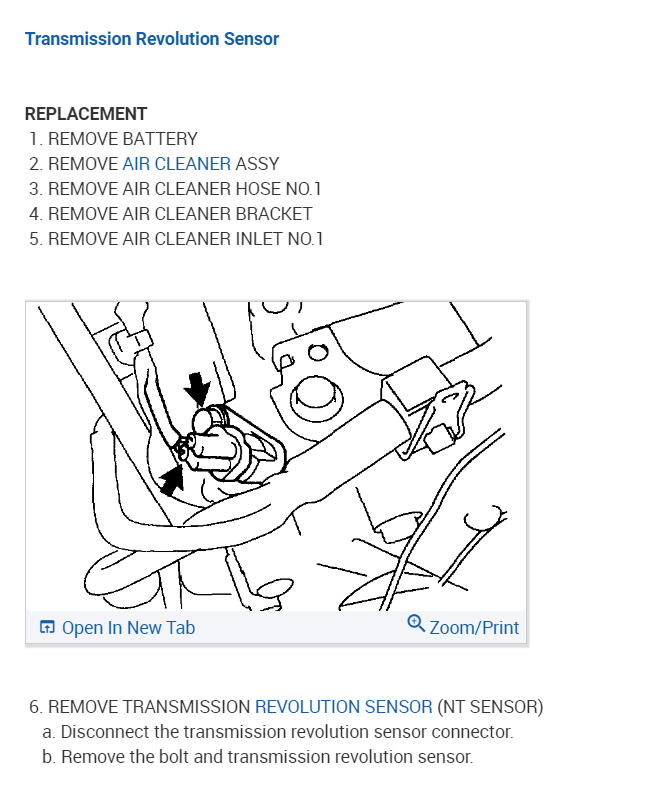

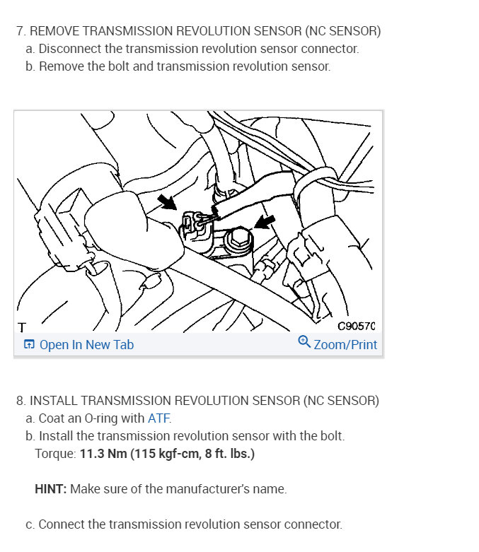

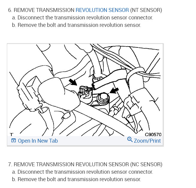

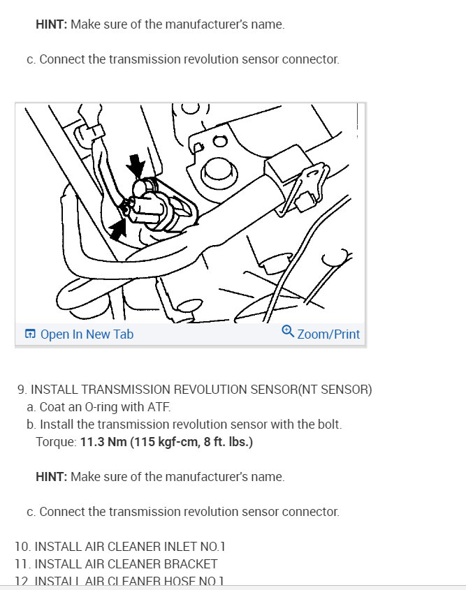

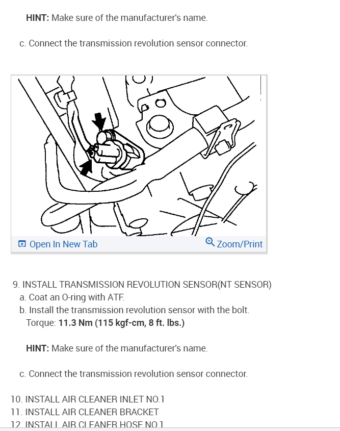

It sounds like the revolution speed sensors is off and needs to be replaced. Here is the location and how to replace it in the diagrams below. Check out the images (below). Please let us know what happens

For the revolution speed sensor, is there no way that it could be tested if it functioning or not before replacement?
Oct 22, 2022 at 11:39 AM
  • 55,267 POSTS
Not really because it could be the valve is off slightly, if you get the part from Amazon, you can return it if it does not fix the issue.

Check the wires on the speed sensor, it is on the passenger's side of the transmission.
Here is a repair guide to help:
Let us know how you make out; we are here to help you.
