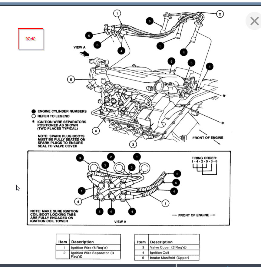

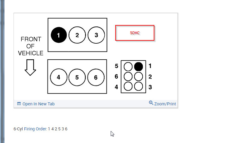

Just need to know what the engine firing order is for my car listed above SE model.

I am attaching the info below for your review. I was not sure if you had the 3.0L SOHC or DOHC engine so I provided both.
Please let us know if you have other questions. Thanks
