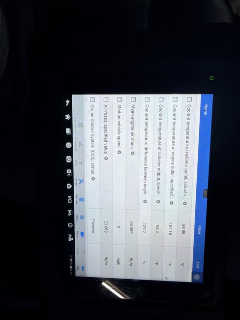

I just finished installing a motor on this car and still need to put back the bumper and few other things, but all connectors are back on. When I started the car the fan was on high, started adding coolant to the reservoir since there is no radiator cap, got about a gallon in. Will it change once the thermostat opens to let water flow around? temp gauge shows temperature is climbing normally, didn't keep it on long just wanted to make sure everything is running fine before I tighten all bolts back on. is there a way to bleed it/?

The best method after an engine replacement is a vacuum-fill tool, because it evacuates the air and pulls coolant throughout the system and yes, once the thermostat opens the system can be completely filled and that can be why there is no heat. I would would try to get the cooling system full before looking at the sensors. Do not let the engine sit and idle waiting for the thermostat to open while that warning is present. The temperature gauge can look normal even when there is an air pocket around part of the engine.

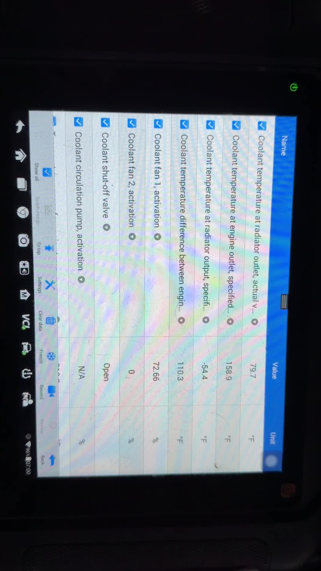

Just did a vacuum fill. I got heat now. Fan still on high with no codes related to it

turned out that the ambient temp sensor needed to be connected, now all is good. thanks

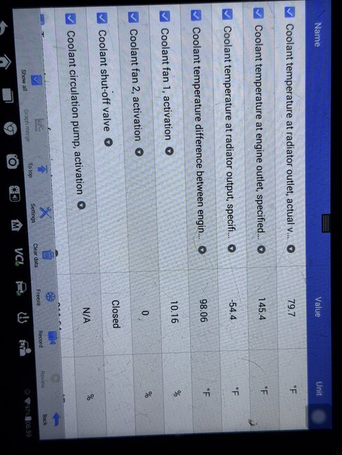

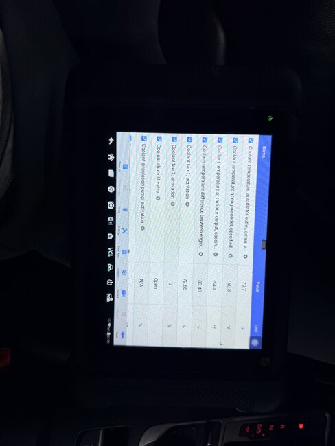

Much better after water pump replacement but still goes up to 235 while driving before coming down. At idle fan is not on high anymore and temp around 225. Waiting on thermostat and thank god they changed the design where it is now on top on passenger side super easy to replace, hopefully it will make a difference too

Nice work, yep the thermostat should help, but 235 might be normal before the fan kicks in. FYI.
