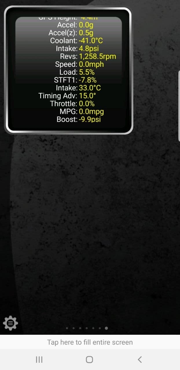

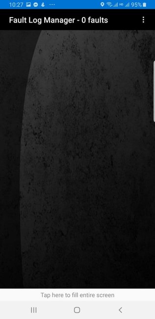

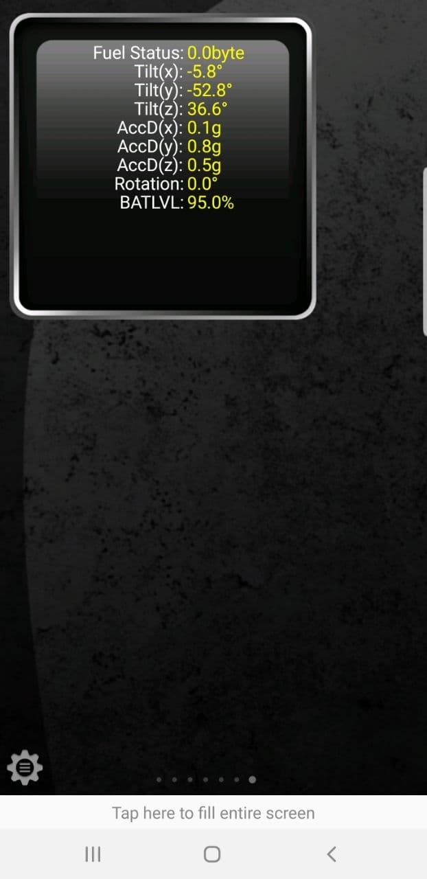

PHALSOTHY
  • 41 POSTS

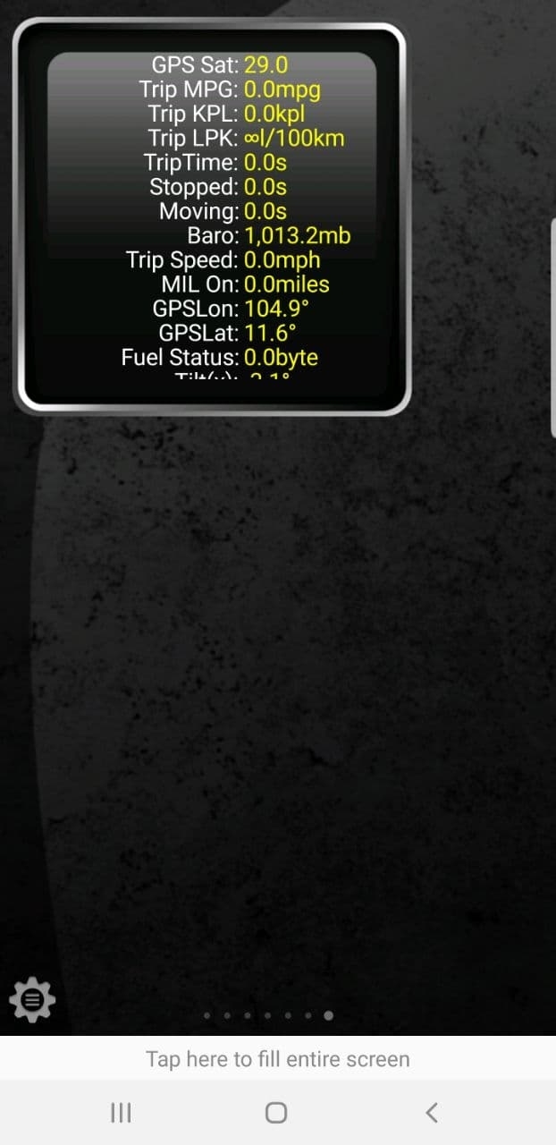

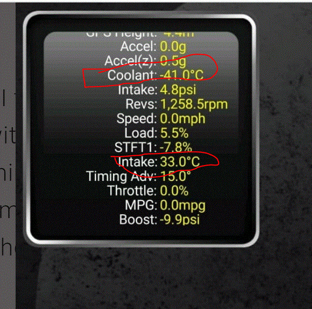

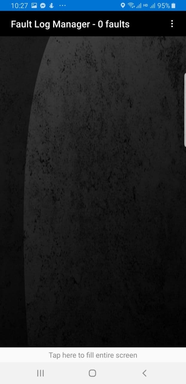

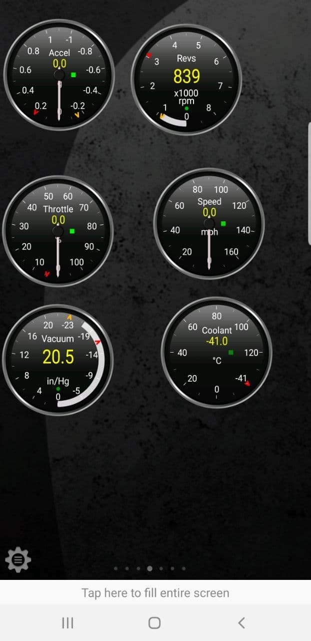

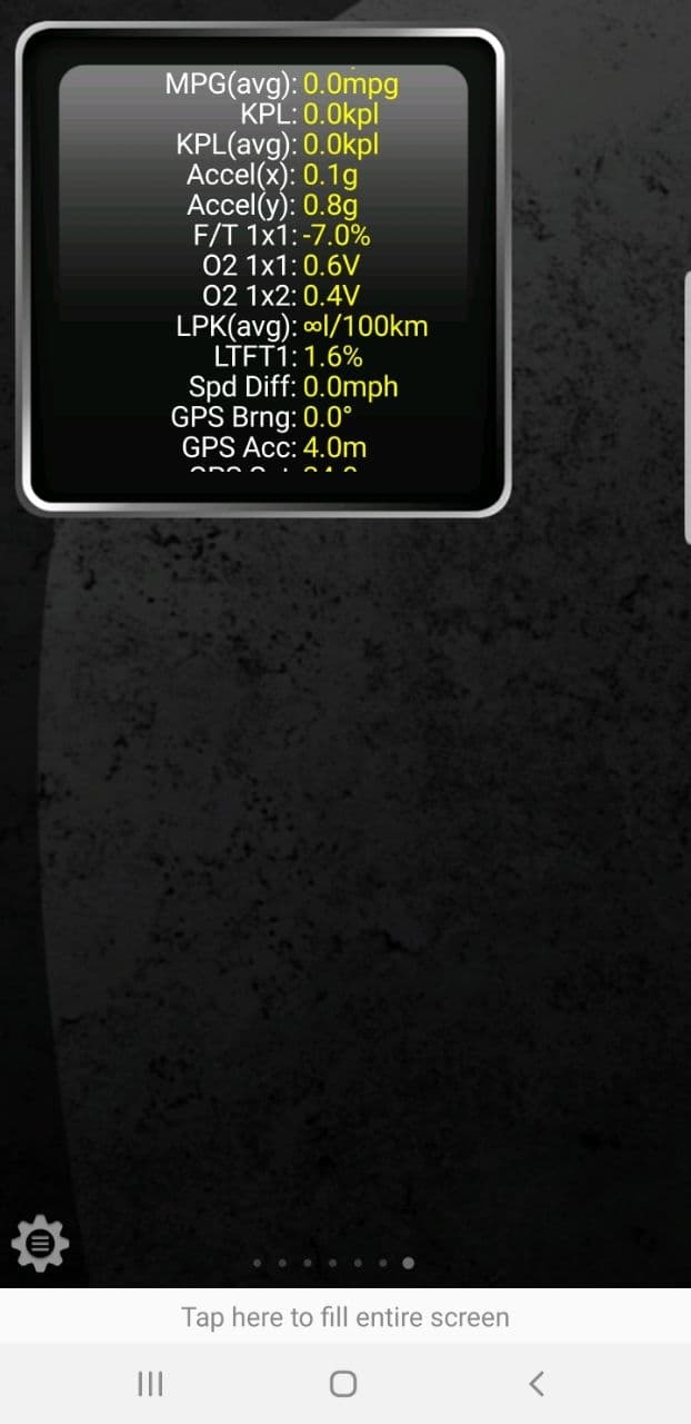

Hi, Mr. Joe, I have a mini scan tool and I try to check this is what I get. But actually I have test with idling my car with no air con turn on and wait if the engine fan running and yes the fan running as normal. So i thought may be the coolant temperature might be working normal but my scan tool not support with my car. Scan tool and result attach in photos.
Sothy.
Nov 12, 2020 at 11:58 AM
  • 110,251 POSTS
I attached a copy of one of your pics below and circled two temperatures.
Was it -41° Celsius? Also, it shows 33°Celcius is the temperature of the air entering the engine. That is a really big difference.
Let me know if it was actually that cold when you checked this.
Nov 12, 2020 at 12:04 PM
PHALSOTHY
  • 41 POSTS
Hi, Mr. Joe. Thank you.
Actually here is 27-29 C, and I don't know why it doesn't change the temp, it is stuck at -41C even if try idling for about 10mn. And wait until the engine fan running as normal.
Sothy
Nov 12, 2020 at 12:17 PM
  • 110,251 POSTS
That is the likely problem. It is telling the computer it is -41°C and the computer is making the fuel mixture extremely rich so the engine can run under those extreme conditions. Basically, the engine is getting too much gas because it thinks it is that cold.
Replace the sensor and let me know if that takes care of the problem.

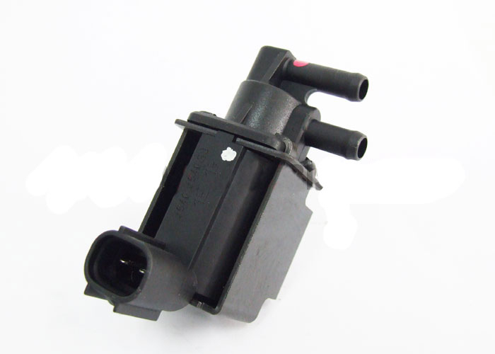

Can I ask you little out of topics? I just wonder what is purge control valve or solenoid use for? I just found out that my car was plug in the wrong tube for many years.

As far as the purge valve, it is a component of your Evaporative Emission Control (EVAP) system. This system restricts the fuel vapor in the fuel tank from escaping into the atmosphere. Basically, it allows the vapors to be stored in what is called a charcoal canister to be burned by the engine when it is actuated to do so.

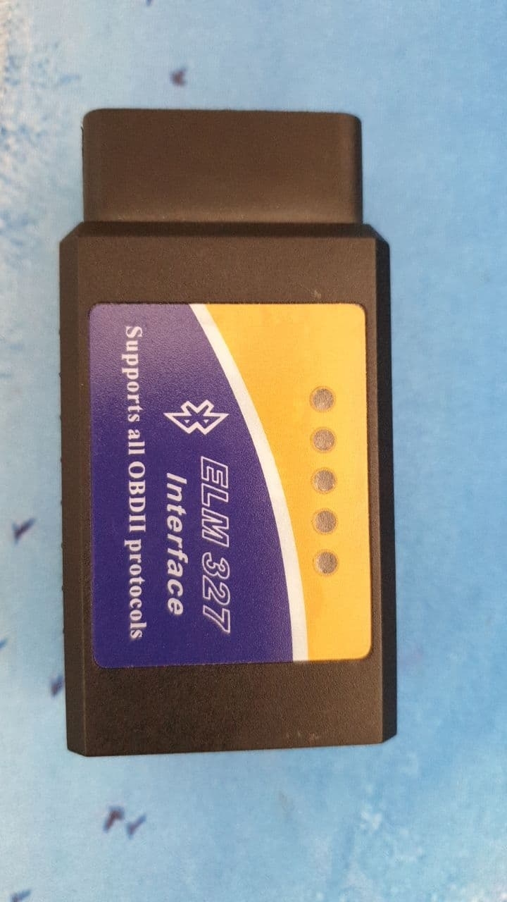

PHALSOTHY
  • 41 POSTS
Good Morning Mr. Joe,
The problem seem to come again after few days, The same problem just came up yesterday and the characteristic is the same but fuel consumption back to normal. what should I do or check again thank you for your help. Oh anyway I just found out that my obd2 Bluetooth not fully supported it say I need version 1.0 obd2 and what I have is 2.1 obd2.

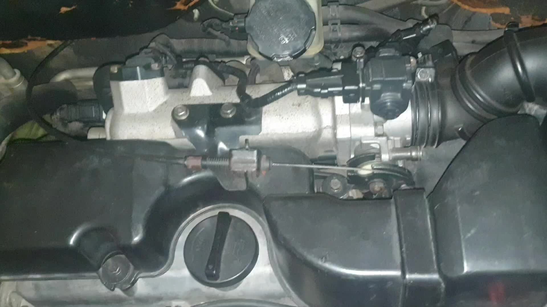

PHALSOTHY
  • 41 POSTS
Thank you for your help. Sensor and vacuum I have ask mechanic he said working okay. But as I have a friend who use to drive this car he said may be the Idle air control actuator might be failing but that just he thought.
Thank you,
Sothy
Nov 20, 2020 at 1:44 PM
  • 110,251 POSTS
The IAC is responsible for maintaining engine idle speed. Some can be serviced. Since you don't have any trouble when it warms up, that may indicate it isn't bad.
Here are a couple links you may find of interest. Note that the IAC is located on the throttle body. The first link explains how to service and the second how to replace (in general).
https://www.2carpros.com/articles/idle-air-control-valve-service
https://www.2carpros.com/articles/how-to-replace-an-idle-speed-control-motor-iac
