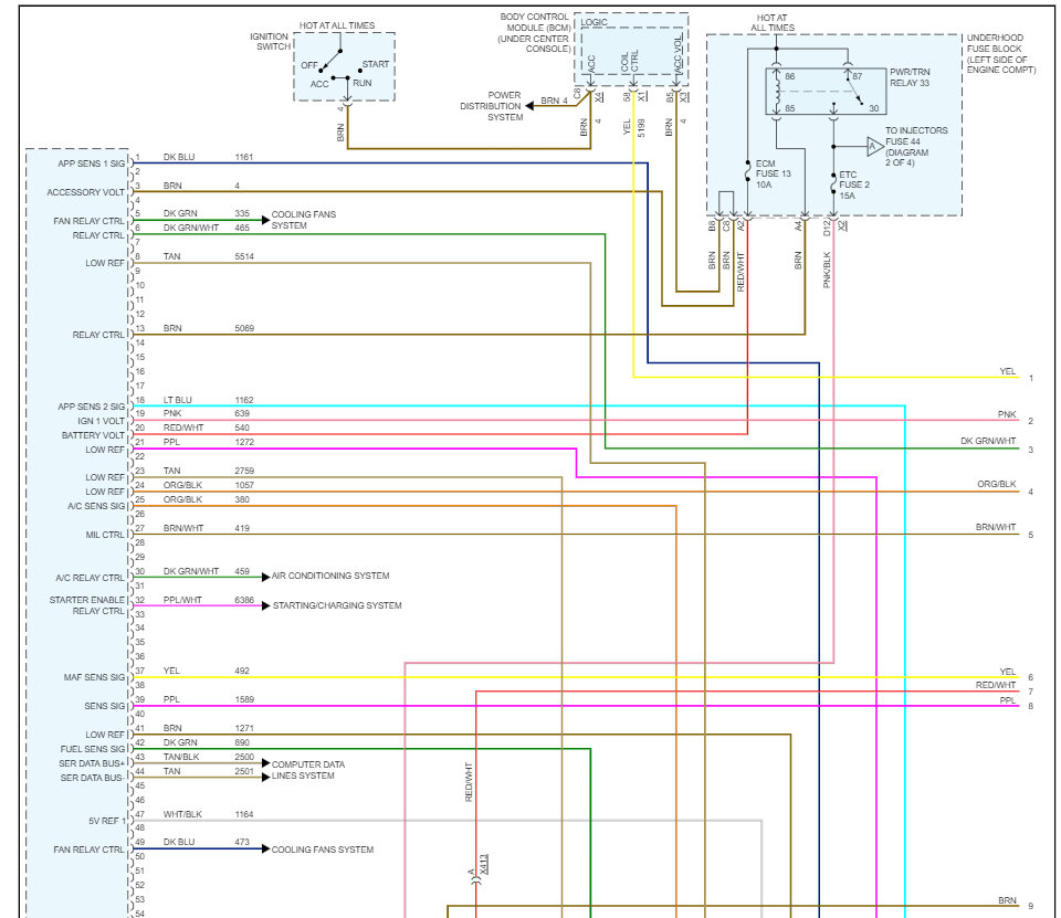

Hello, engine electronics lamp is up. My car listed above is for the European market!
Error displayed is:
P0013 - Camshaft Position Actuator "B" Control Circuit/Open (Bank 1).
Could it be a timing chain problem or just an Exhaust fumes solenoids?

Hello Srdjas,
This code is a connection code issue, so most of the time the camshaft oil control actuator valve will short out and cause this code. I would check the electrical connector first and fi okay replace the valve, here is the location so you can check it out. Check out the images (below). Please let us know how it goes.

I have replaced exhaust solenoid. Engine light is gone, but error P0013 cannot be deleted!?
Oct 17, 2023 at 8:06 AM
  • 55,743 POSTS
P0013 - Camshaft Position Actuator "B" Control Circuit/Open (Bank 1). is a circuit error so if it is not the camshaft oil control actuator valve check the pins in the connector. If not here is a guide to check the wiring to the PCM and the engine wiring diagrams so you can see which wires to test:
