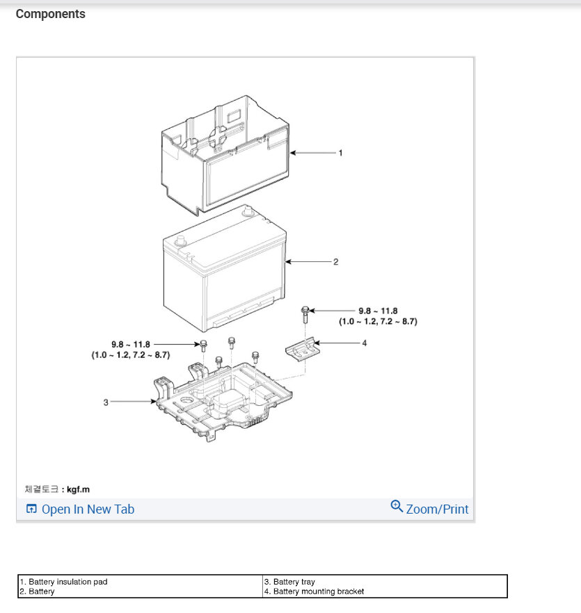

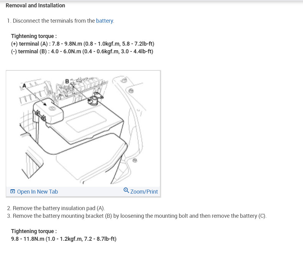

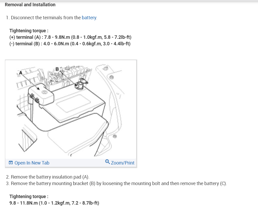

I would recheck the battery because this sounds like the battery has an internal short. Also, we should run the codes to see if any come up. Also, check the battery cable connections. If you can upload a short video of what the car is doing, I can tell for sure what's going on.

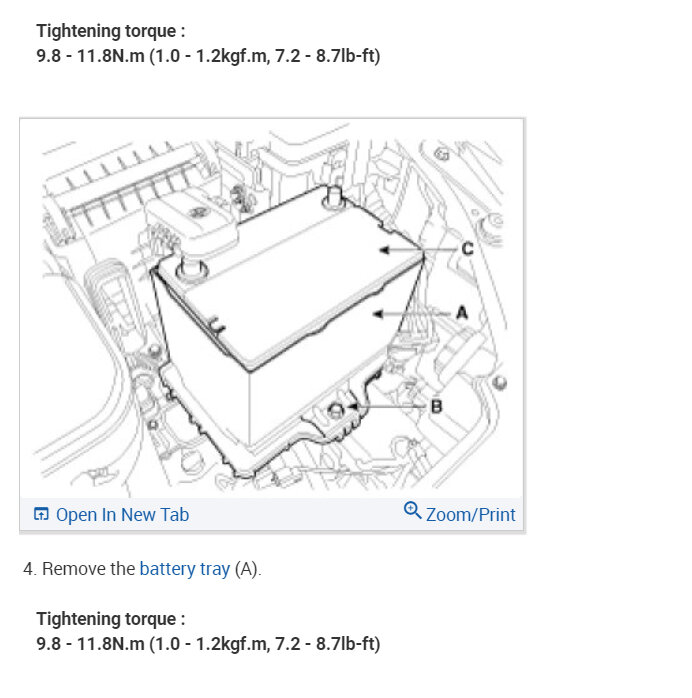

It does sound like a connection problem, I would recheck the battery because an internal problem can come and go with batteries.
Dec 20, 2022 at 2:44 AM
RKILBURG06

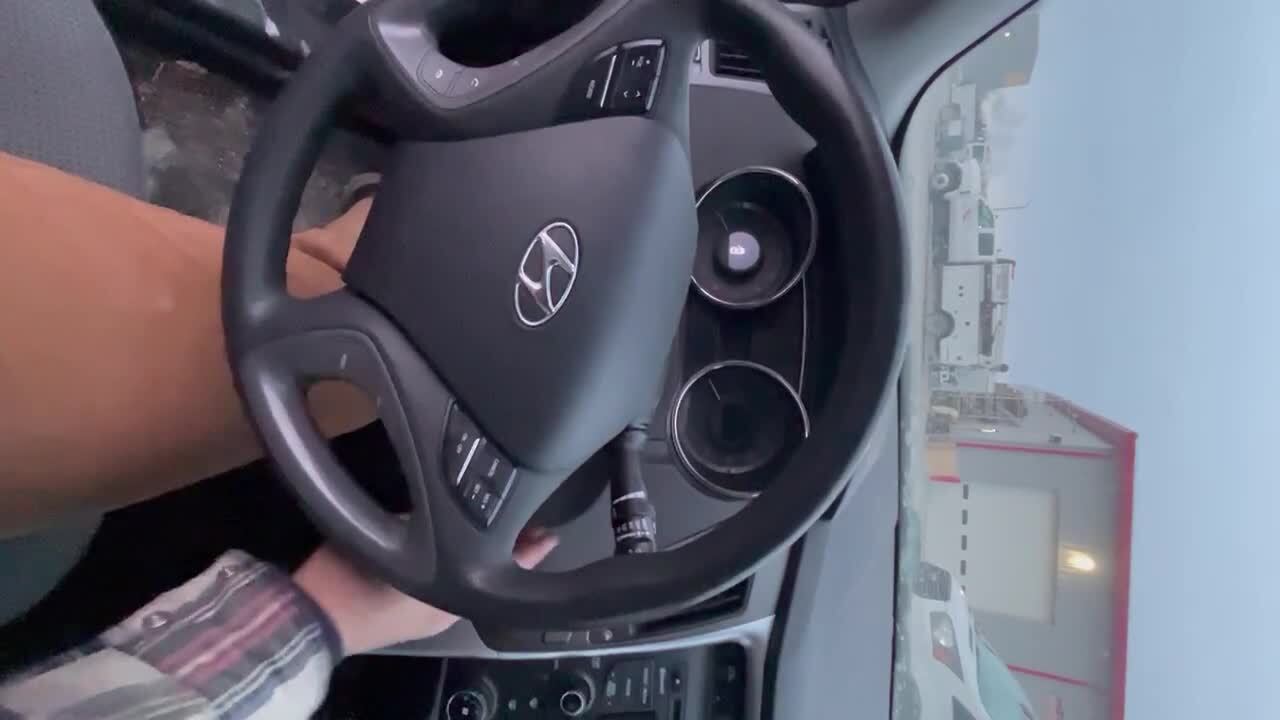

The second test came back as a bad battery, so I replaced it. It resolved the lights flickering and draining issue. However, I still cannot start. You can hear where it stops and grabs. My thought is 1) if the camshaft position sensor isn’t letting a full rotation? 2) the engine is locked up 3) the starter is coincidentally bad. Thoughts?
Dec 20, 2022 at 11:08 PM
  • 55,433 POSTS

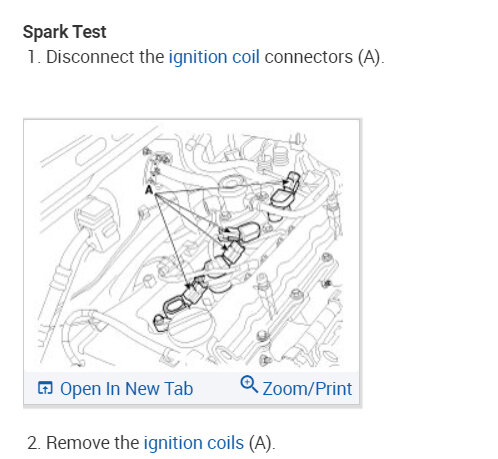

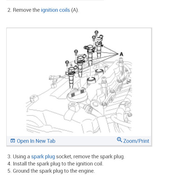

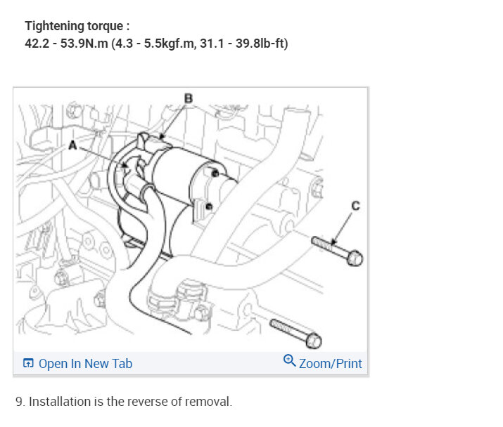

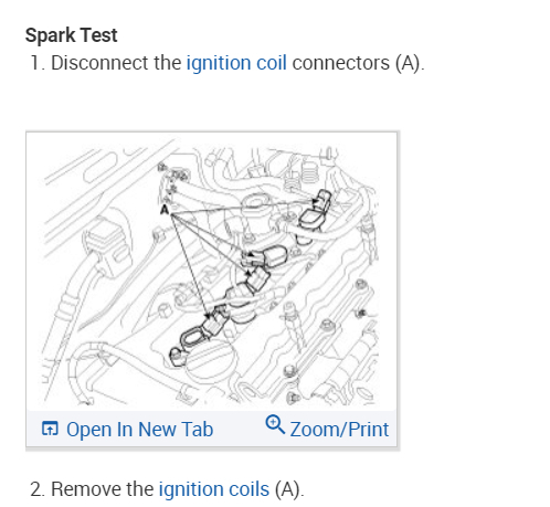

Thanks for the video. I would remove the spark plug and then crank the engine over to see if coolant had filled one of the cylinders. When you crank the engine over stand back in case coolant shoots from the engine spark plug hole. If okay, I would replace the starter.
https://www.2carpros.com/articles/how-to-change-spark-plugs

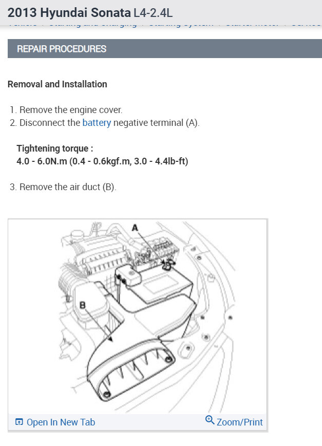

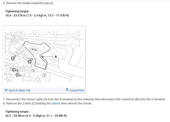

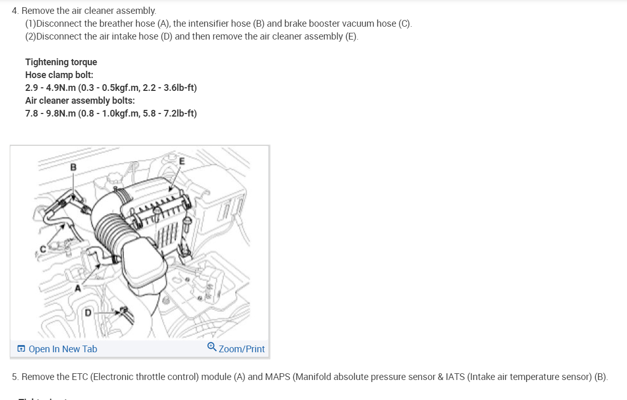

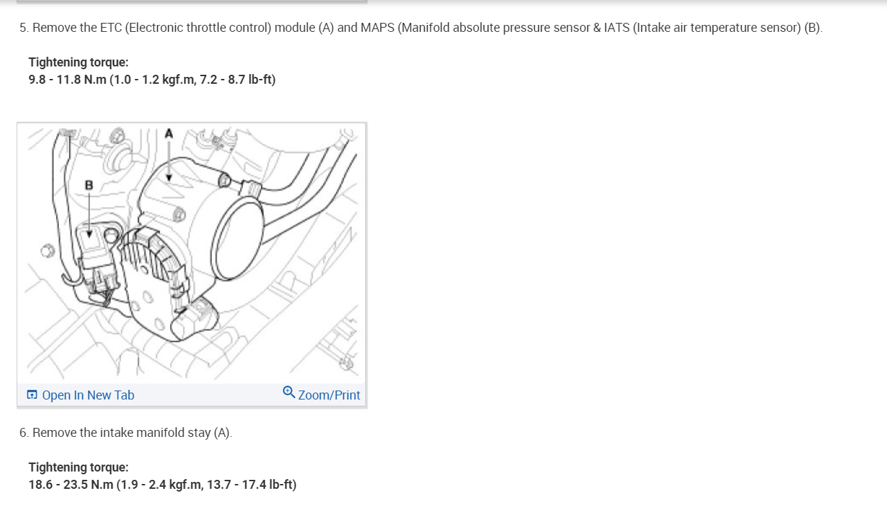

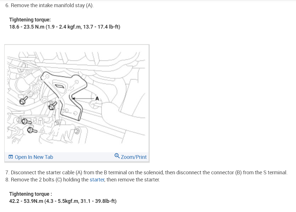

Here is how to change out the starter in case you need it. Check out the images (below). Please let us know what happens.
