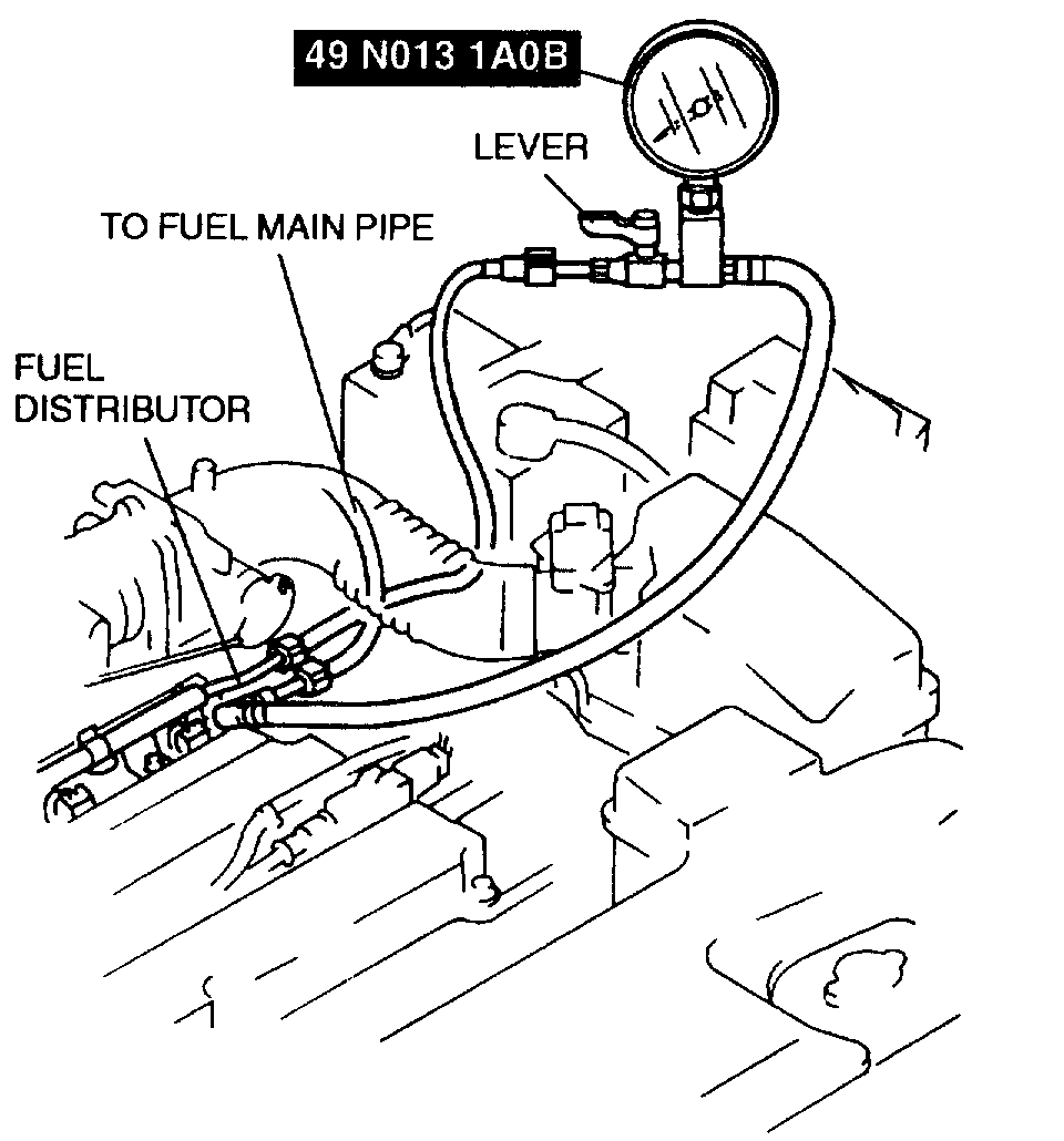

My daughters van has an issue that it will start up fine and drive fine up to a point then once it is it shuts off. for example going into the store, coming out it will not start unless you put the pedal clear to the floor. Also when idling there is a hesitation briefly when you press on the pedal.

When you hold the pedal to the floor, it allows air to enter the engine, but it also shuts down the fuel injectors. With that in mind, it sounds like it is flooding after it sits which can be the result of high fuel pressure, leaking injector, and so on.
Is the check engine light staying on? If it is, you need to scan the computer to identify diagnostic trouble codes are stored in the system. Here is a video that shows how that is done:
https://youtu.be/b2IJGfImVvw
I realize most people don't own a scanner. However, most parts stores will do it for you free of charge. So have that done.
Next, we will need to check fuel pump pressure to make sure it is within the manufacturer's specs. Here is a link that shows how that is done:
Here are the directions specific to your vehicle. The attached pictures correlate with these directions. Also, the manufacturer's specs are included in the directions.
FUEL PRESSURE INSPECTION

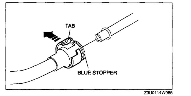

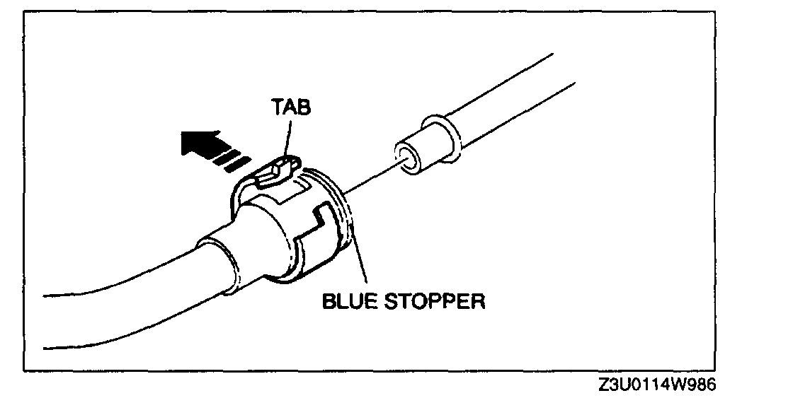

2. Disconnect the quick release connector from the fuel tank as follows.
Picture 1
2. Lift the tab on the locking coupler until the fuel line can be released.
3. Pull the fuel hose straight back.
NOTE

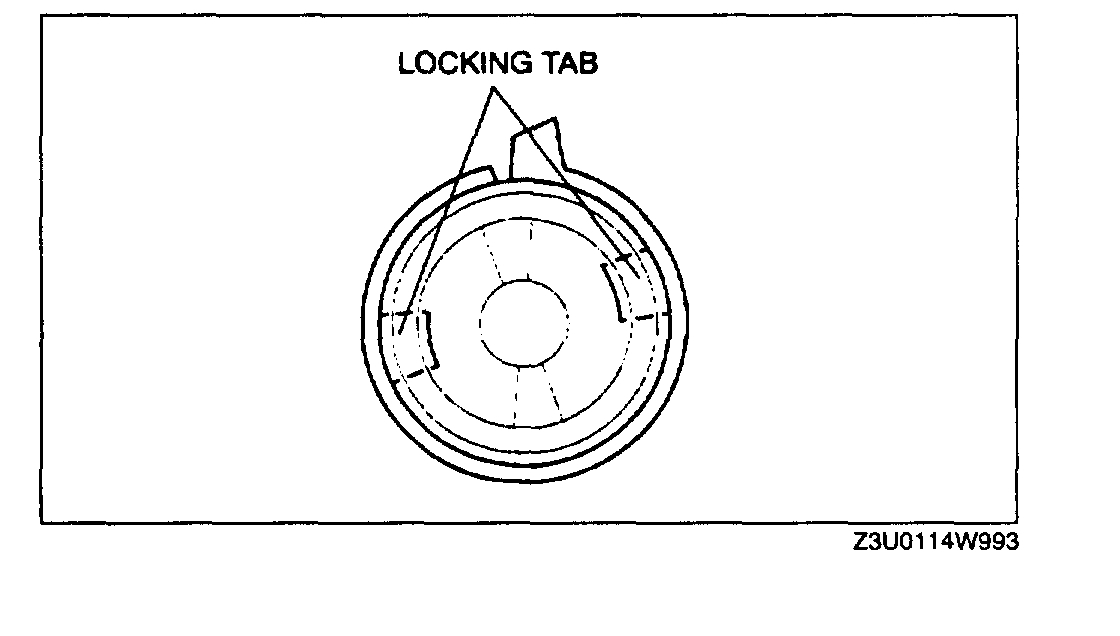

The stopper may be removed from the quick connector.Take care not to loose it. Reinstall it to the quick release connector before reconnecting the fuel line.The locking coupler has two internal locking tabs witch retain the pulsation damper pipe. Be sure that the tabon the locking coupler is rotated until it stops to release two internal locking tabs.
Picture 2
3. Push the SST quick release connector into the fuel distributor and fuel main hose into the SST until a click is heard.
Picture 3
4. Turn the lever on the SST as shown.
5. Connect the battery negative cable.
6. Verify that selector lever is in N range.
7. Start engine and let it idle. Measure the fuel line pressure
