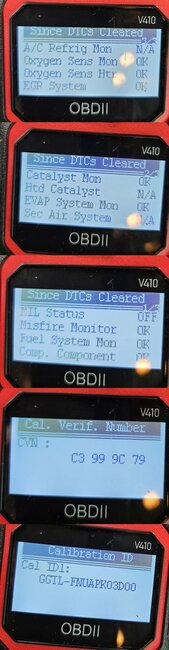

I got another reader because my old one would not exit. Anyway. Here are the pics off the new reader

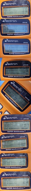

Replaced the fuel pressure control valve - no change. Will get the smoke machine. My friend has a better reader. Going there on 7-14 and will upload pic of reader findings.

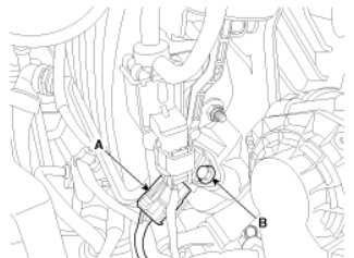

Can you get the long and short fuel trims so we can see what the computer is doing? It sounds like the MAP sensor is weak, also can you pull the spark plugs to see what color they are? Here is the location of the sensor so you can check it out.

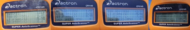

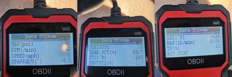

Yes new o-ring used. No sign of exhaust leakage. Here are pics of the reader. Note the two which show the TRIMs LT ST reflect the ST changes but not the LT.
Aug 6, 2025 at 6:54 AM
  • 55,398 POSTS
I am sorry I cant read any of these they are two small. Can you break them up please?
Aug 7, 2025 at 10:55 AM
MIKELINE
  • 12 POSTS
I put four in a row. I hope that helps
Aug 7, 2025 at 11:31 AM
  • 55,398 POSTS
Thanks you, okay it was like I thought, the PCM is thinking the system is lean, here are choices for the cause and a guide as well.
