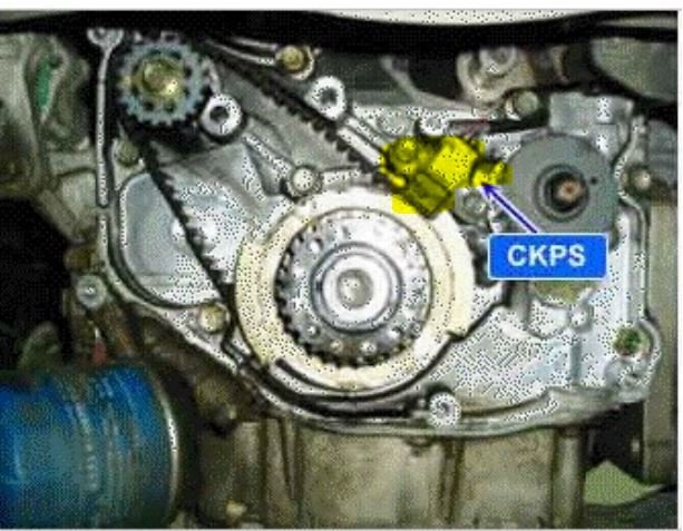

Vehicle cranks, starts, and runs fine for approximately 4-7 seconds and then shuts off. Will not continue to run. You can hear the fuel pump come on and run each time the switch is turned on. Everything else works fine except the engine just will not continue to run.
Tuesday, October 1st, 2019 AT 4:46 PM
28 Replies
  • 110,077 POSTS
Welcome to 2CarPros.
It could be a few things. For example, although you hear the pump, it may not be producing enough pressure. Or, there could be an issue with the crankshaft position sensor which would lead to loss of ignition spark.
We need to be sure where the problem is coming from because the crank sensor is behind the timing belt cover and isn't a quick one to replace.
Take a look through these links. The explain what the crank sensor does, symptoms of a bad one, and in general how one is replaced.
https://www.2carpros.com/articles/how-a-crank-shaft-angle-sensor-works
__________________________________
Next, if you feel that the sensor isn't the issue based on symptoms, check to see if the fuel pressure is within spec. Here is a link that explains how that is done.
Here are the manufacturer's specs for pressure:
Fuel Pressure
Vacuum hose disconnection .................... 330 - 350 kPa (47 - 50 psi) at Curb Idle
Vacuum hose connection .................... 270 kPa (38 psi) at Curb Idle
If the vehicle doesn't restart right away and you have to wait, check for ignition spark. If there is none, then suspect the sensor is bad.
___________________________________
I attached a picture of the crankshaft position sensor so you can see where it is located. Let me know if any of this helps or if you have other questions.

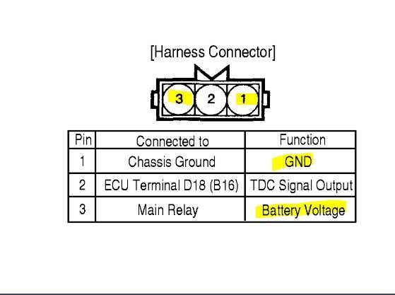

Thank you for your answer, however after checking all of the above except replacing the crankshaft position sensor (since the car starts and runs perfectly for the 3-5 seconds, I couldn't believe it was that sensor since it was getting fire). After the car starts and runs a few times, I get a 340 code thrown. That is the camshaft position sensor and I have replaced it with a new one. I also replaced the connector since the old one came apart. However when replacing the sensor connector with the new one I could not remember exactly which wires went where. The original plug had three wires. Two black and one pink, but the replacement had three black.I tried to put them back the way I thought the had been, but I still get the 340 code, no matter how I switch them around. Could you tell me how to test them and tell which wire goes where on the sensor plug. At this time I have the pink one in the middle of the plug, but have no idea whether it's correct or not or whether the black ones are correct either. I've tried to check the wires to determine which of the black one is the ground, but haven't had any luck. One more question. When splicing the new connector wires to the original wires, can you just twist the wires together until you know which is correct and then solder seal them. Will they still make a good enough connection to determine if they are correctly connected to keep from taking them loose every time it throws the code? I know this is a long post, but I am down to my last vehicle to drive and it is a 35 year old S-10 with about 400,000 miles on it and could die at any time. Any help would be deeply appreciated. Thanks, Jay
Tuesday, November 5th, 2019 AT 6:16 PM
  • 110,077 POSTS
I attached a picture for you. It shows the plug orientation and what each pin should have. You will need to check the wires to determine which is ground (check for continuity to ground) the power and the last is the signal wire. this guide can help

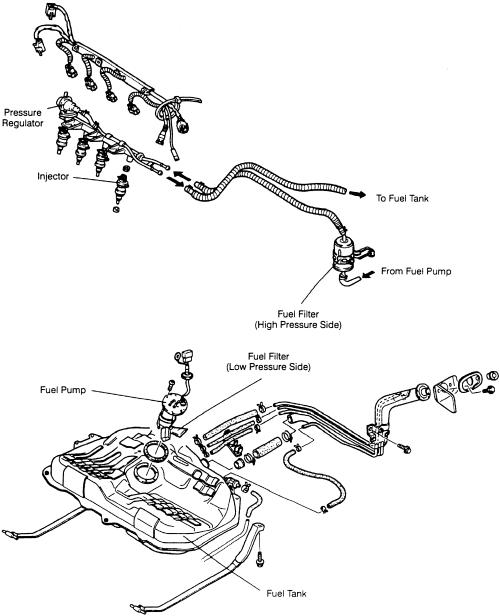

The car will stall and most of the time compression start right back up. Sometime it won't compression start and I have to pull over let it set a few minuets and it will start and away I go. After 10 miles or so it will run fine and I will not have any more problems until the car cools down completely. I get no check engine light when this happens.
Monday, September 7th, 2020 AT 2:27 PM (Merged)
  • 110,077 POSTS
When the engine doesn't start, you need to check to see if there is both spark to the plugs and proper fuel pressure to the engine. My guess is the fuel pressure will be low, but you have to check to be sure.
Do that and let me know what you find. If you need directions, see our homepage under the DIY section. There are both directions and a video to help you.
JOSEPHAHOESCHE
I can not find a fuel pressure test port on my Kia Optima, from what I found online it may not have one.
  • 110,077 POSTS
Then it would have to be checked at the fuel filter.
