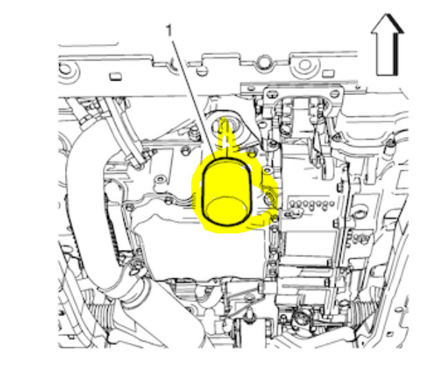

Recently driving the vehicle when the "engine power has been reduced" indicator came on. Couple of days later, while driving, car hesitated while driving and started to slow down and more i increased on the accelerator., the more the power reduced, and it eventually cut off. Open the hood, and there was oil all over the lower part of the engine. Checked the level and it showed there was oil on the dipstick but approx. One quart low. Keep in mind there was oil that had shot all over the lower engine, but no big amount on the ground under. Now when ignition switch is turned, engine doesn't not turnover, but instead a whining sound is heard for approx. Three to four seconds then nothing.

Would it be possible for you to record it so I can hear the whine you are referring to and a couple of pics of the oil? That would really be helpful.
Since you saw oil low on the engine, first, check the oil filter which is at the front of the engine to make sure it is tight and not leaking. See pic 1

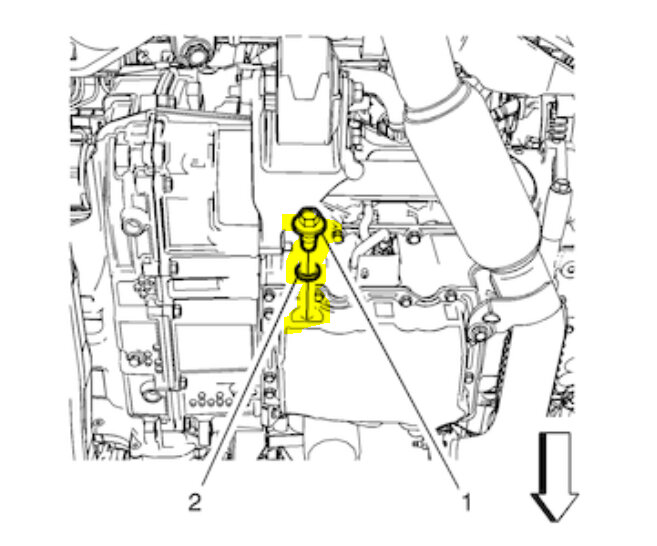

If that is good, on the back side of the engine is the oil drain plug. Make sure it is tight, See pic 2 below.
Let me know. Also, if you could record it cranking and upload it, that will likely be very helpful,

I listened to it. It has little to no compression. I suspect the timing chain has jumped time. Now for the worse news. This is an interference engine. Basically, there isn't enough room between an open valve and the top of the piston if the timing is off. As a result, they hit and internal damage to the engine occurs. I believe that is the knock I heard when you first started cranking the engine.
