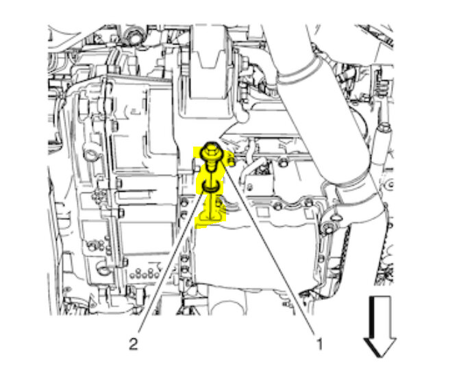

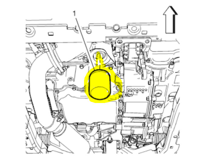

Recently driving the vehicle when the "engine power has been reduced" indicator came on. Couple of days later, while driving, car hesitated while driving and started to slow down and more i increased on the accelerator., the more the power reduced, and it eventually cut off. Open the hood, and there was oil all over the lower part of the engine. Checked the level and it showed there was oil on the dipstick but approx. One quart low. Keep in mind there was oil that had shot all over the lower engine, but no big amount on the ground under. Now when ignition switch is turned, engine doesn't not turnover, but instead a whining sound is heard for approx. Three to four seconds then nothing.

Since you saw oil low on the engine, first, check the oil filter which is at the front of the engine to make sure it is tight and not leaking. See pic 1
If that is good, on the back side of the engine is the oil drain plug. Make sure it is tight, See pic 2 below.
Let me know. Also, if you could record it cranking and upload it, that will likely be very helpful,
