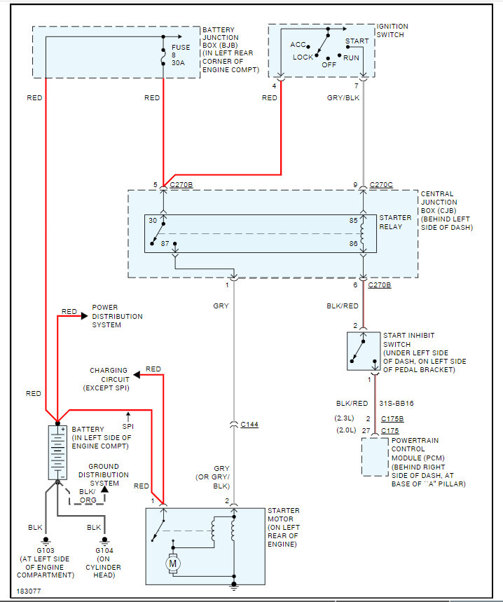

engine does not turn over with key?
2004 FORD BANTAM
256,754 MILES • 1.3L • 4 CYL • FWD • MANUAL
SHAUN LOTTERING
engine does not turn over with key. I opened the ignition relay and pushed the points together. the engine swings but does not start. could it be a faulty relay.
Jan 26, 2015 at 1:22 AM
HMAC300
  • 48,601 POSTS
we don't have that model in U.S. but try resetting security system if no manual look online
Jan 26, 2015 at 1:26 AM
  • 55,433 POSTS
This is the same a as a ford focus, I would check the floor mat to make sure you can push the clutch pedal in completely, please go over this video which will help
https://youtu.be/lXLJbuAZ4CE?si=TG58cVeApCMS9ln_

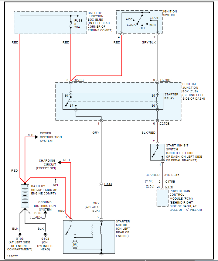

Here is the starter motor wiring diagrams so you can see how the system works. Check out the images (below). Please let us know what happens.
