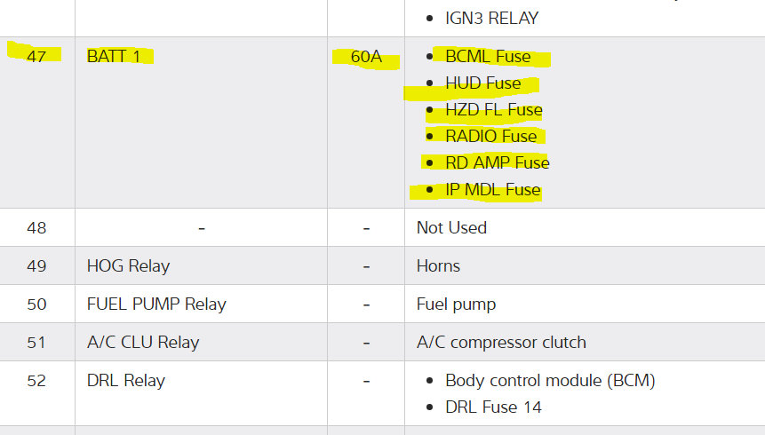

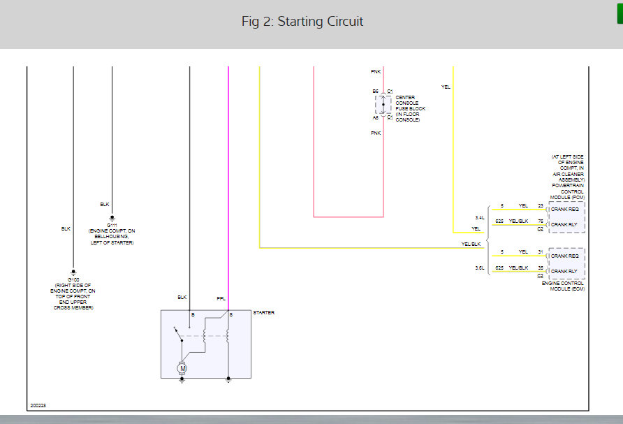

I replaced the front bearings on my vehicle. I had been getting a traction control needs service and the ABS light was on too. Both front bearings had play so replaced both.
After replacing I took vehicle for test drive bearings sounded much quieter. The traction control needs service and the ABS light were still on. Got back to the house unhooked the neg cable to reset computer 10 minutes hooked back up tried to start. nothing. Check engine light is on brake light is on and the line for my gear selector is not there gauges don't work assuming cause gas gauge not registering. nothing when I try to start. Left key on and jumped at relay starts up then shuts off.
Jul 22, 2019 at 1:44 PM
SCGRANTURISMO
  • 4,897 POSTS

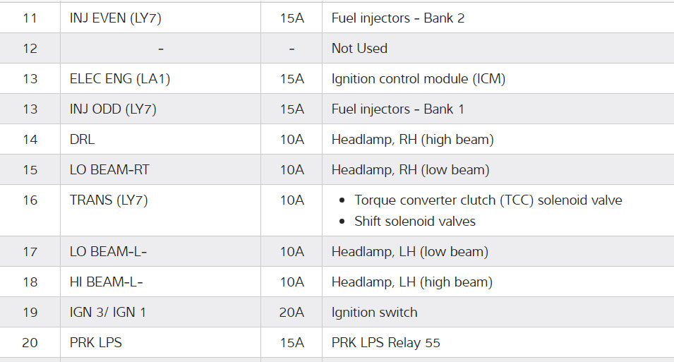

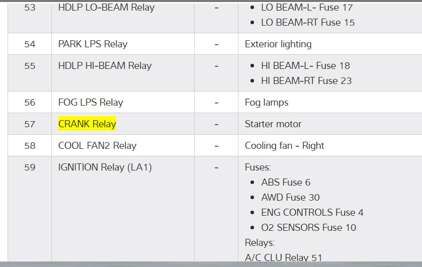

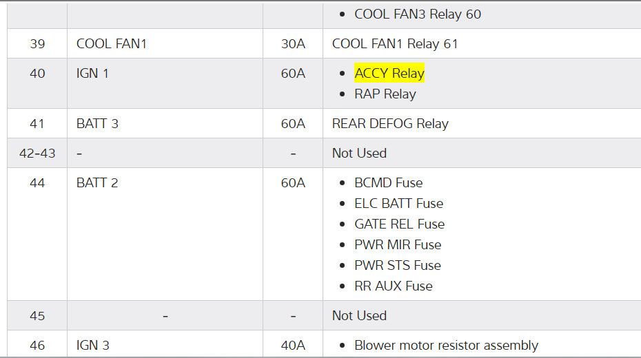

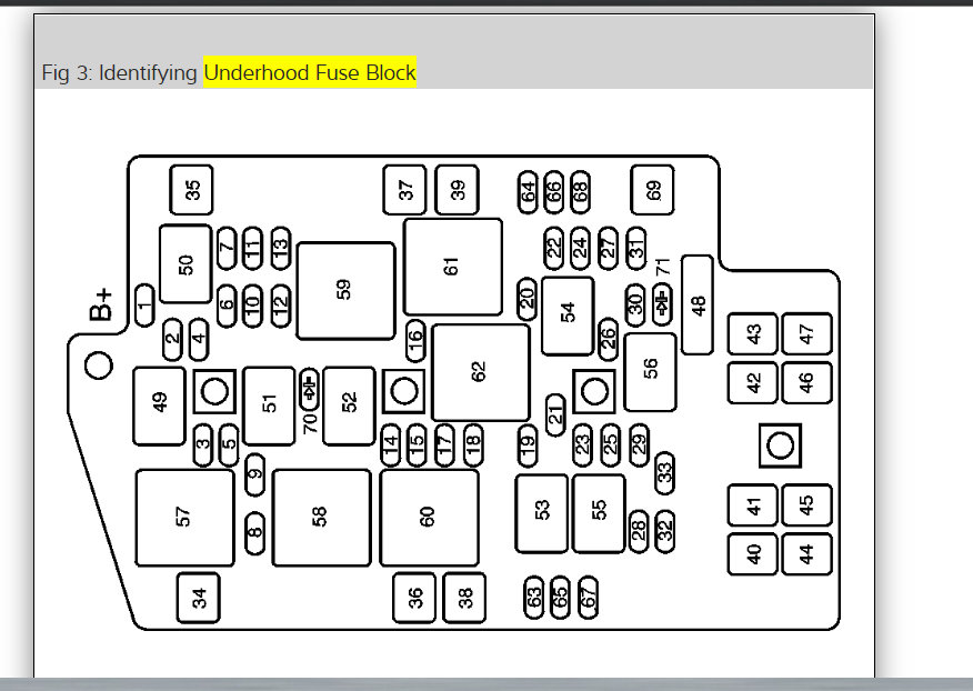

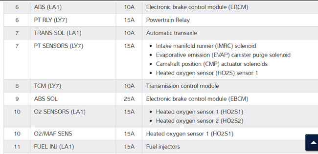

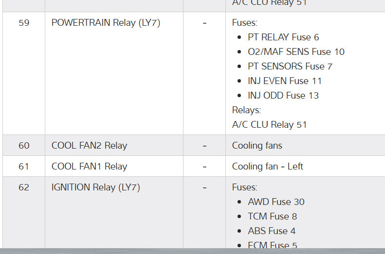

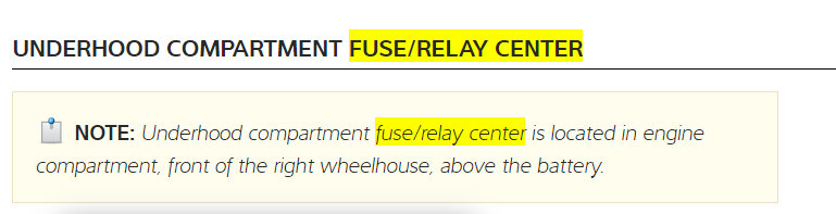

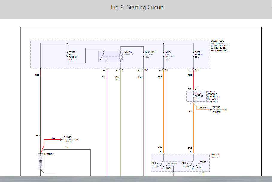

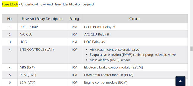

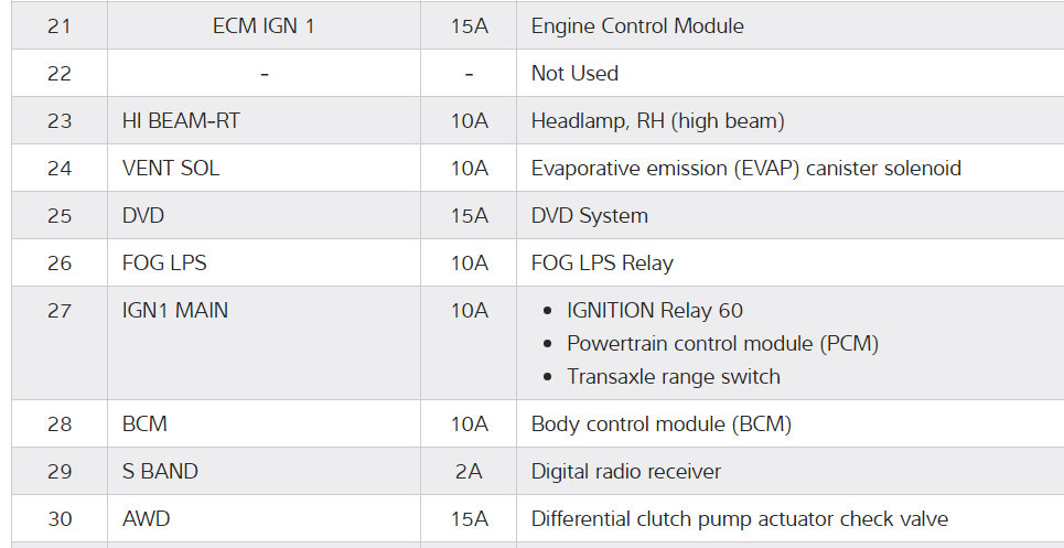

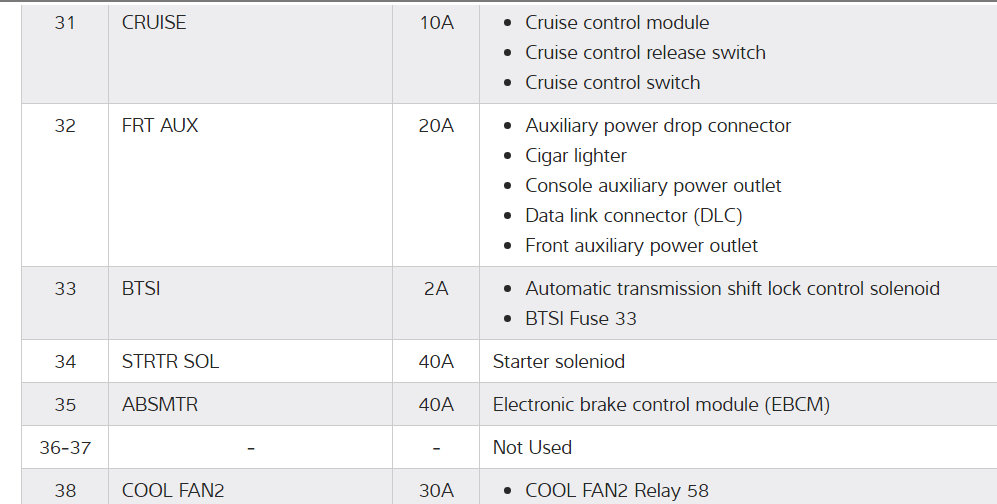

This could be a problem with fuse #47 BATT 1(60A) in the Under hood Compartment Fuse/Relay Center located in the engine compartment above the battery. In the diagrams down below I have included a wiring diagram of your vehicle's Starting Circuit, as well as a diagram of the fuse box and a callout as well. Here is a link for you to go to if you are unfamiliar with how to test a fuse:
Please go through these guides and get back to us with what you are able to find out.
