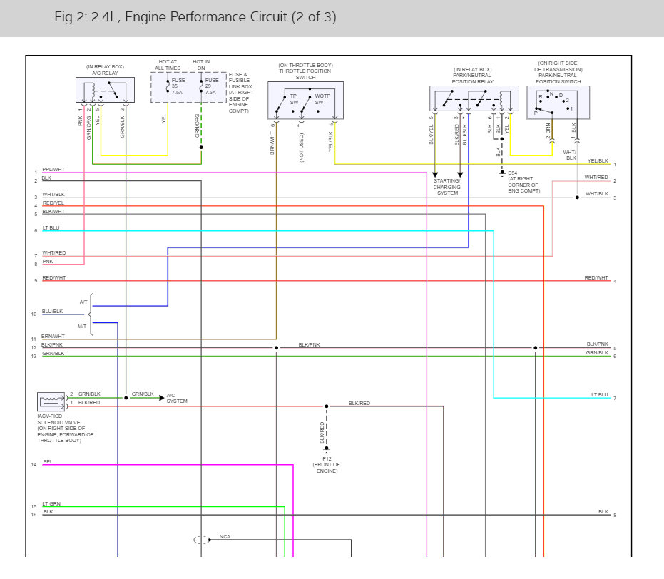

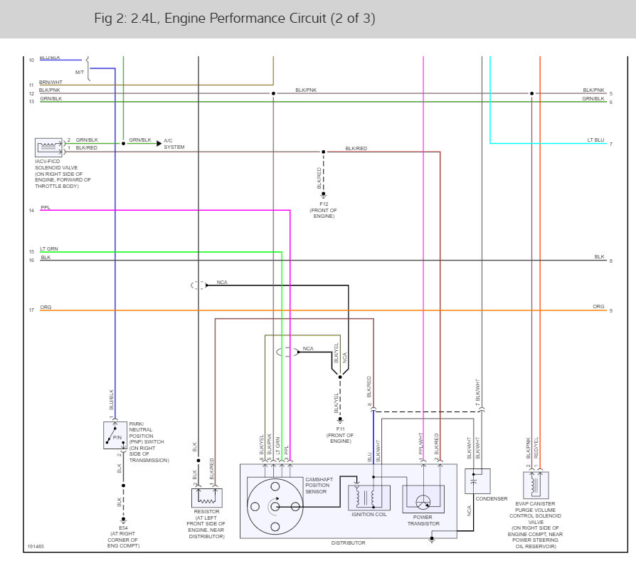

Had a problem with the distributor wiring harness. The six pin that plugs into the distributor. Some how the wires touched each other and shorted the distributor. There is also a 2 pin plug that fits on the distributor. any idea which is the positive?

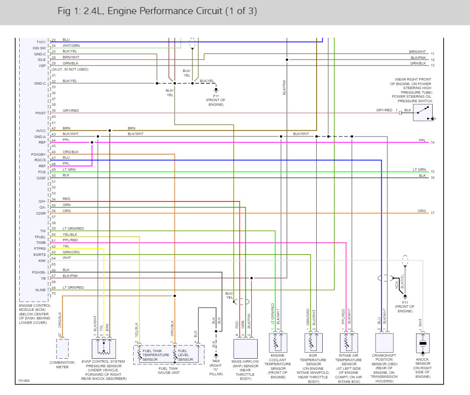

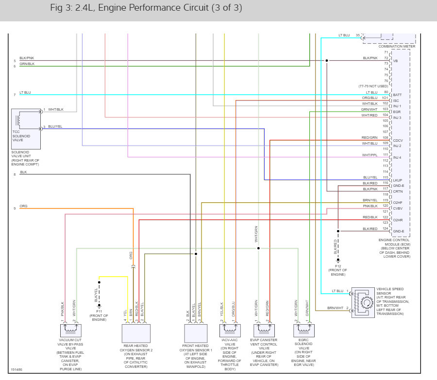

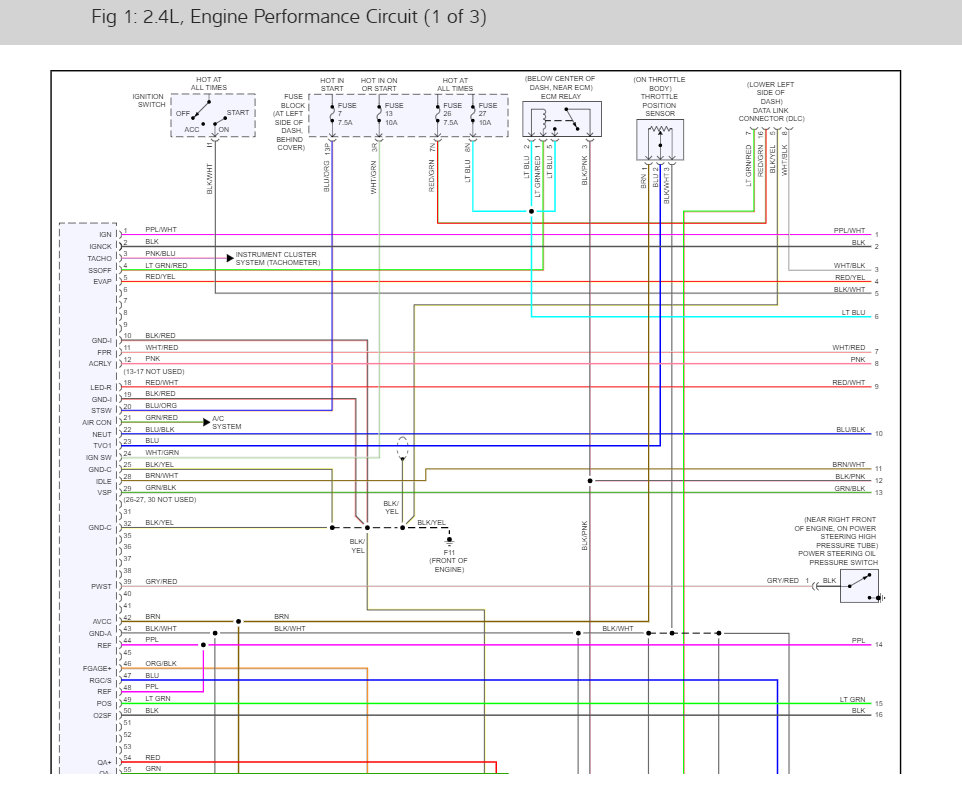

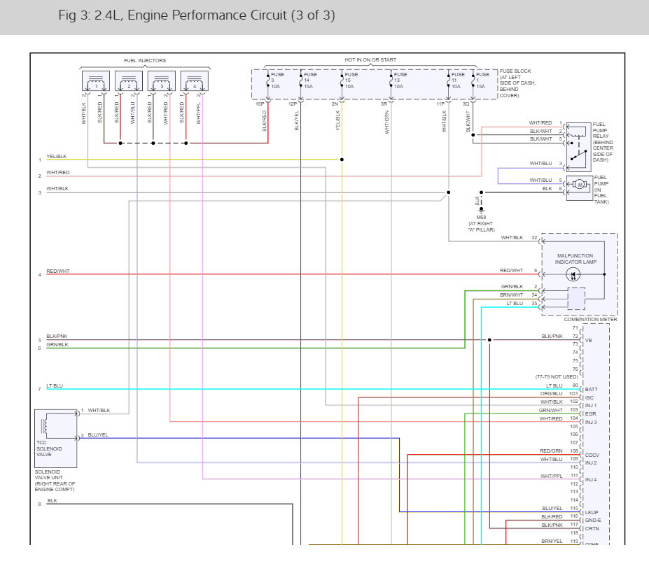

Here is a guide to help you test the engine and distributor wiring and the engine wiring diagrams below so you can see which wires to test and how the system works.
