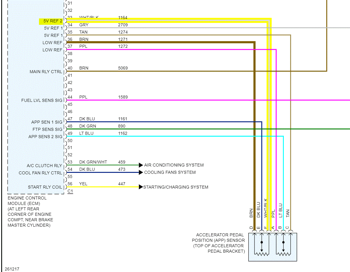

Just put in new clutch then put car back together and now I am getting an engine disabled message on dash.
Getting codes p0107, p2101, and p0651.
It is not a key security issue.
Mar 29, 2022 at 12:30 PM
  • 110,194 POSTS
Looking at the codes, the first thing I would suggest checking is the gray wire between the PCM and the throttle pedal position sensor. So, go to the TPP sensor and disconnect it.
Using a voltmeter or multimeter, check for a 5v reference.
The PCM is in the left rear of the engine compartment, so the wire may have been damaged, pinched, or disconnected.
Let me know what you find.
See pic below.
