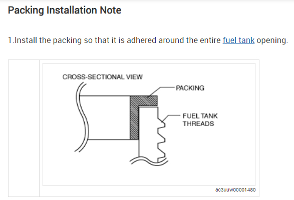

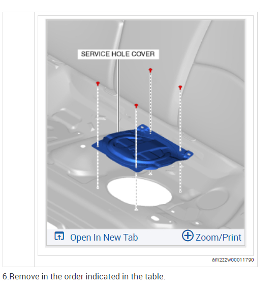

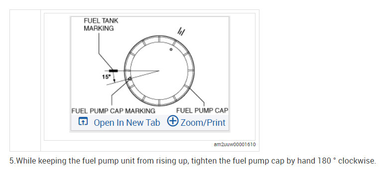

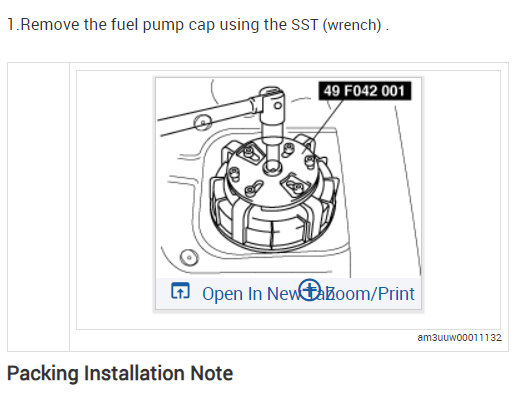

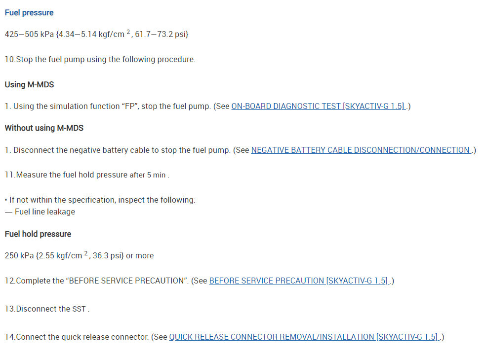

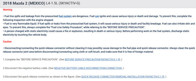

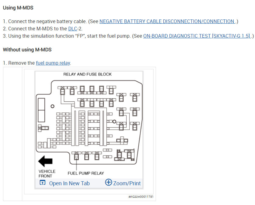

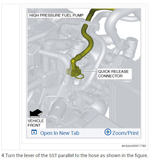

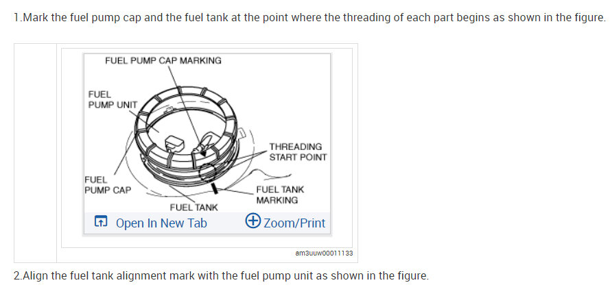

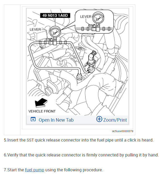

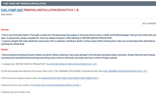

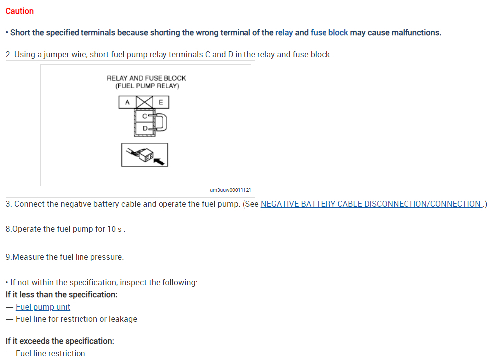

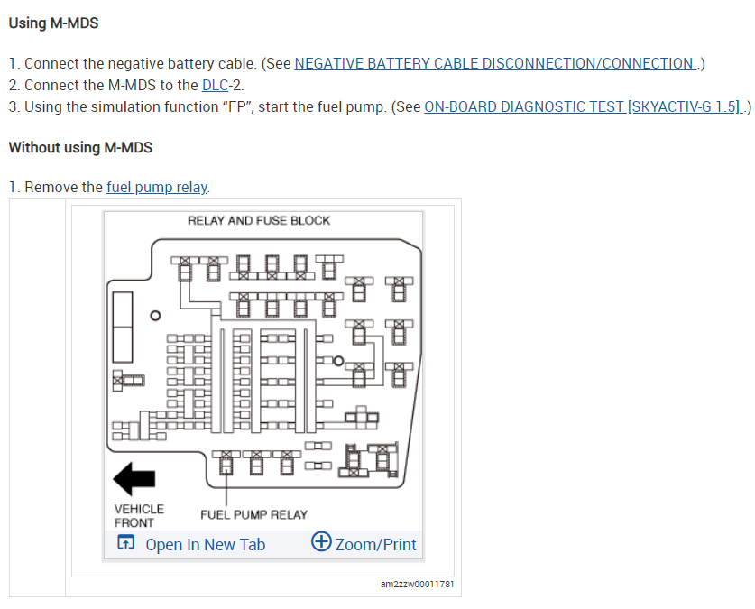

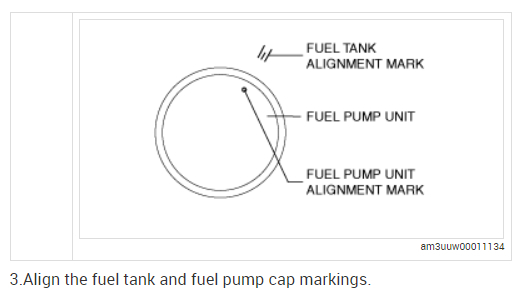

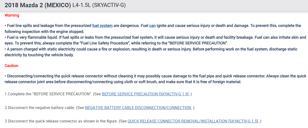

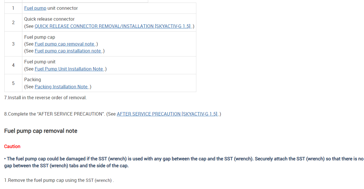

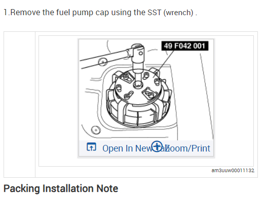

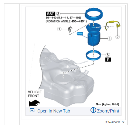

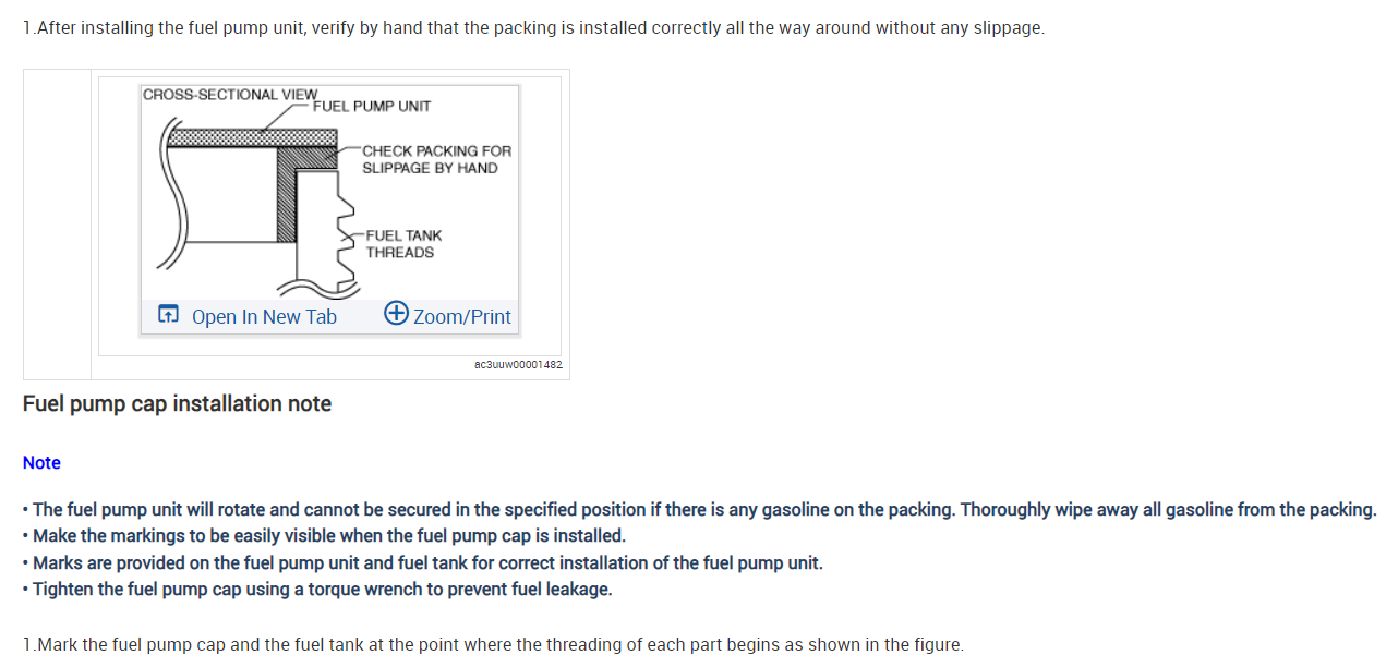

Yep, I have seen the fuel pump cause this issue. What happens is the fuel pump motor can bind at times and cause the fuel pressure to drop which will cause stalling and rough running after the restart. I would say to do a fuel pressure test which may help but may not be definitive due to the duration of the stalling event.
Please go over this guide and I have included instructions below for your car:
Also, please go over this guide which can give more information on the problem you are having:
https://www.2carpros.com/articles/engine-stalls
Fuel pressure:
425-505 kPa {4.34-5.14 kgf/cm 2 , 61.7-73.2 psi}

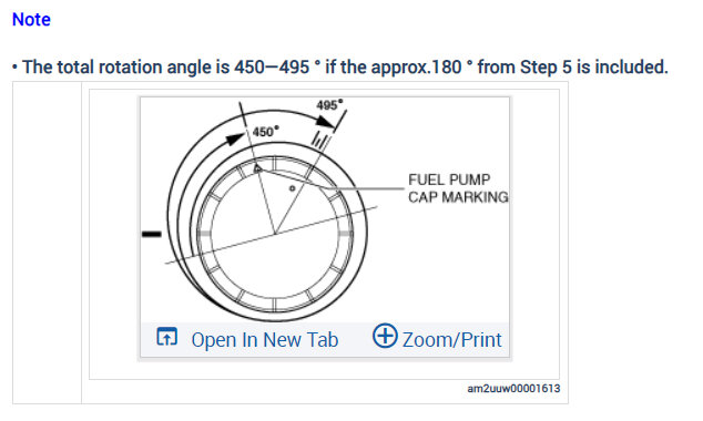

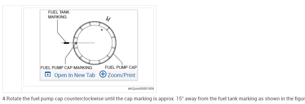

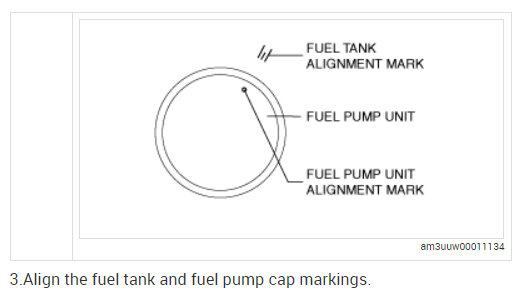

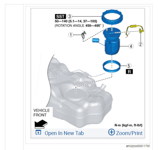

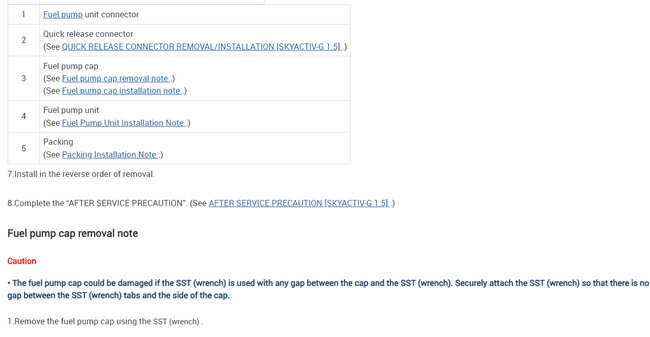

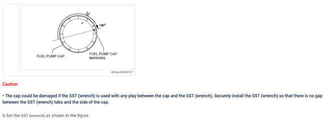

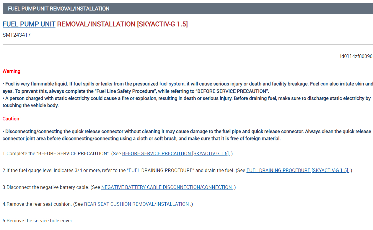

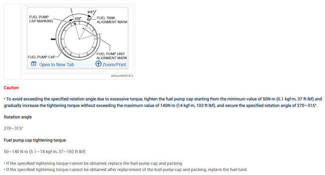

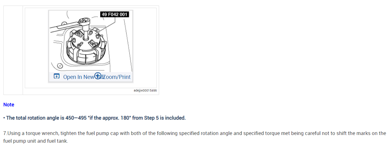

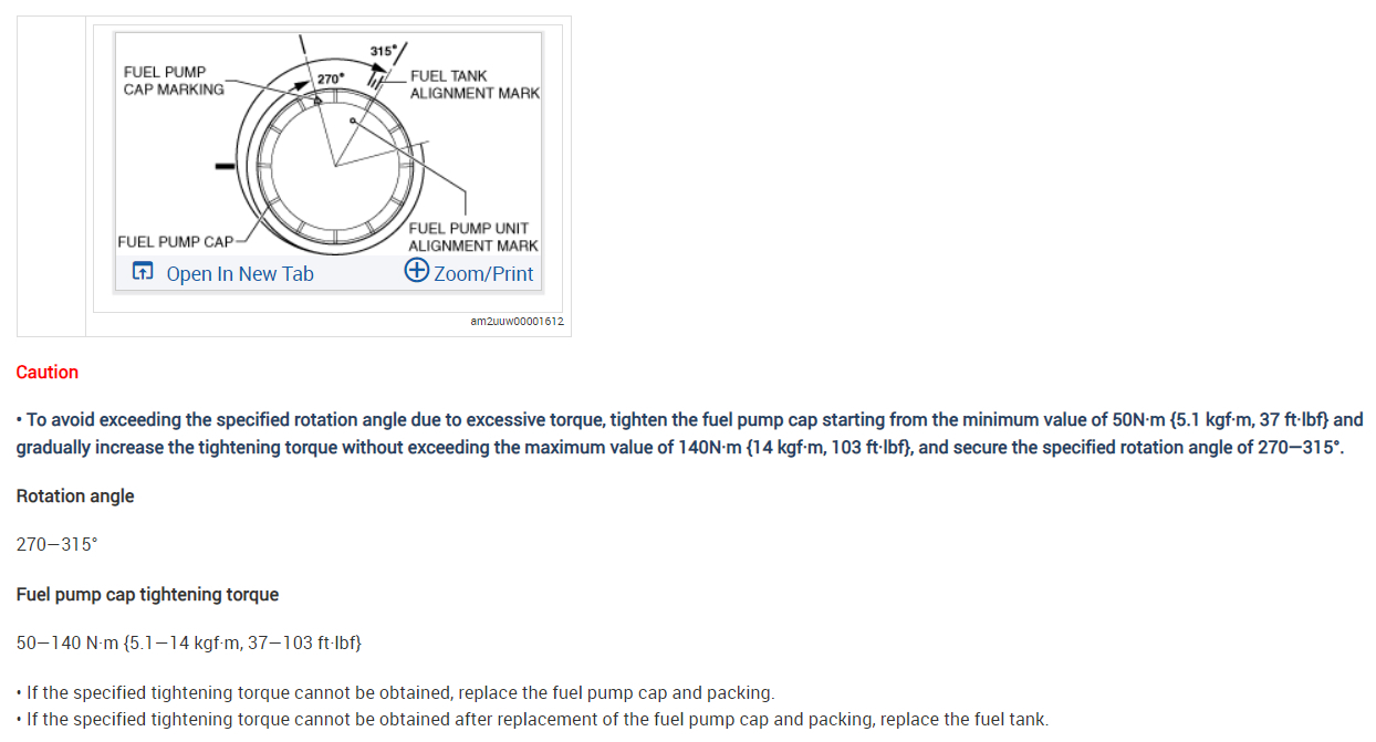

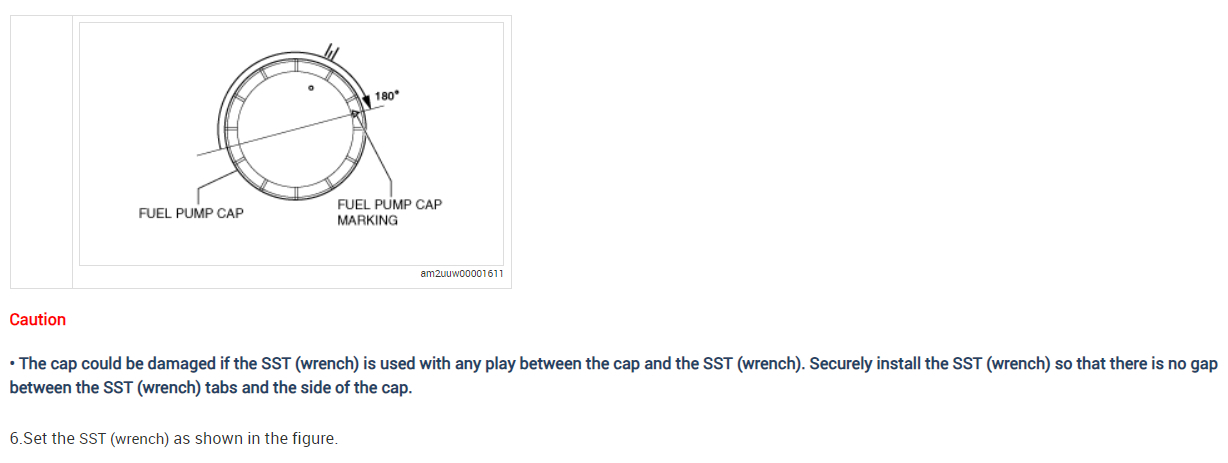

Luckily the low-pressure fuel pump has a trap door, so you don't need to remove the fuel tank. I have also included how to change the fuel pump out (low pressure) in case you need it. Check out the images (below). Please let us know what happens.
