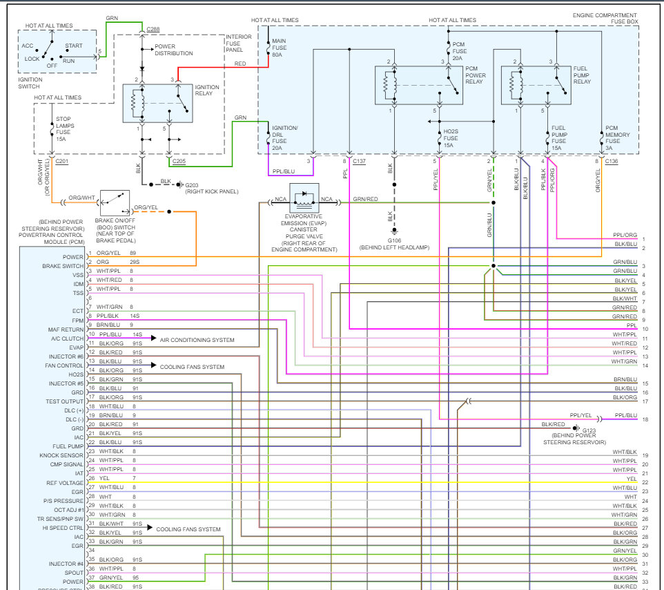

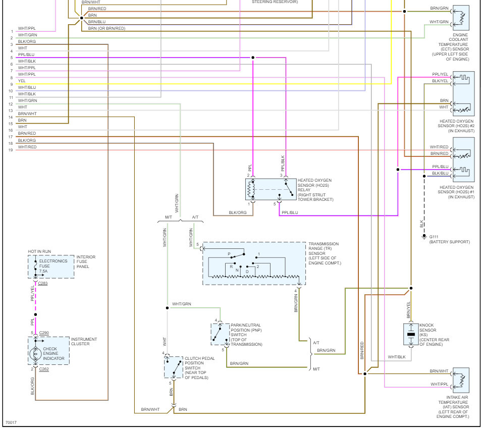

After the engine idles for about 25 minutes, it shuts off and will not restart. The PCM/ECM is very hot to the touch. I can smell unburned gas when I try to restart.
Apr 3, 2023 at 4:58 AM
  • 55,691 POSTS

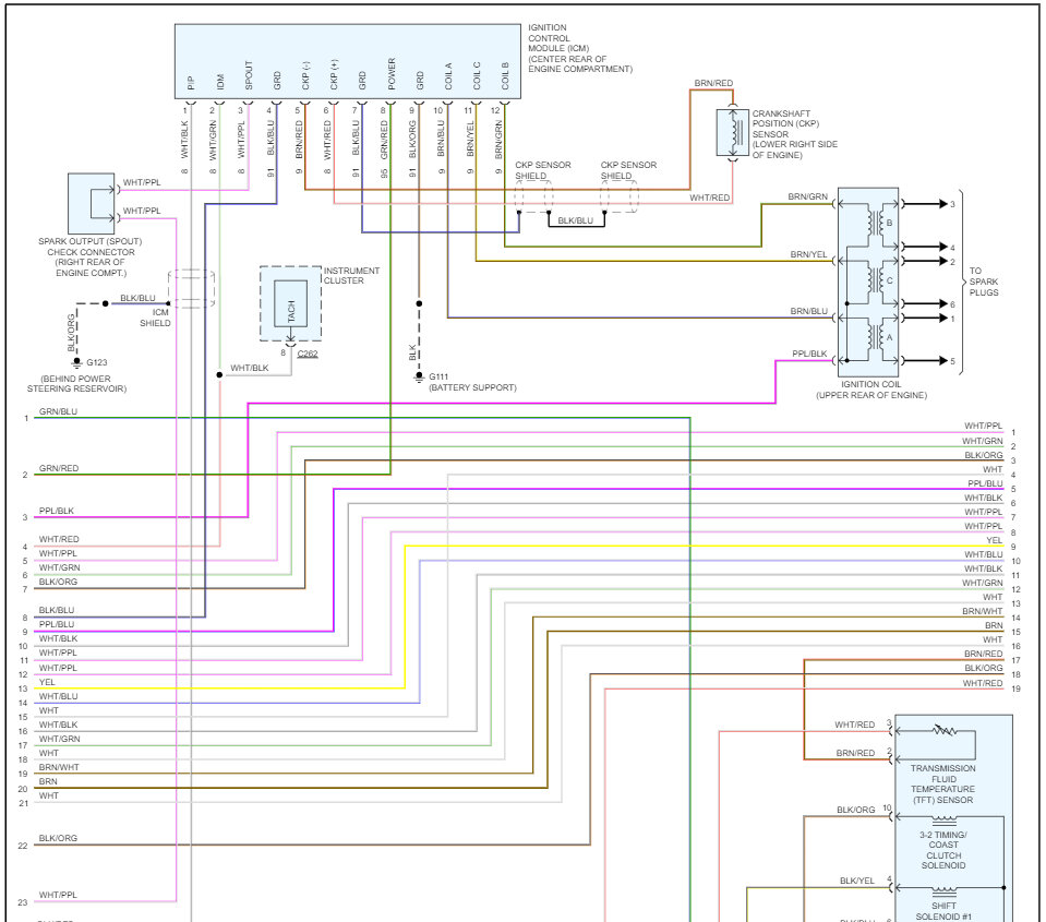

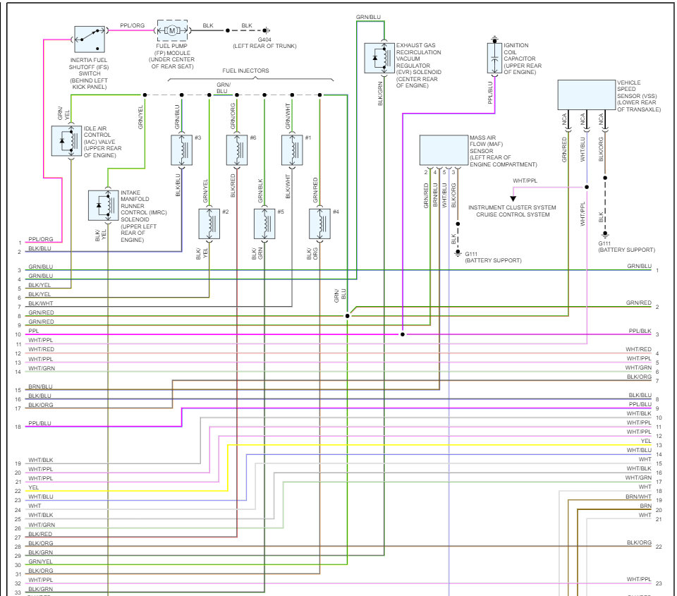

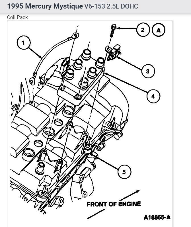

The PCM should not be hot, it sounds like you have a shorts injector, ignition coil or a bad ground to the PCM, can you see if the coil is hot as well, if so, I would replace it with a new one. Check out the images (below). Please let us know what happens.
Apr 3, 2023 at 8:41 AM
QFONG
  • 92 POSTS

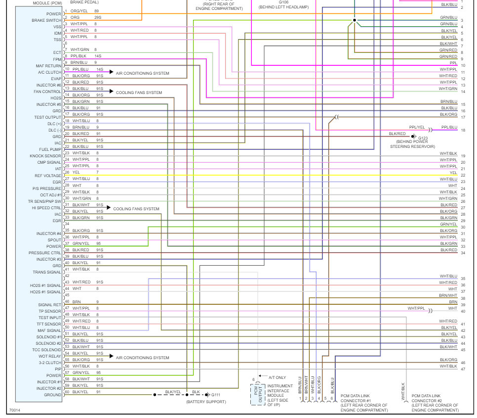

The PCM should be grounded from terminals 20 and 60, is that correct? The coil pack is new. It was warm but it sits right over the bank 1 exhaust manifold. I will investigate tomorrow.
Apr 3, 2023 at 10:36 AM
  • 55,691 POSTS

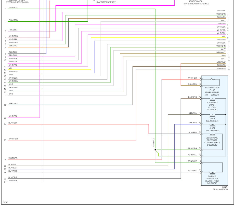

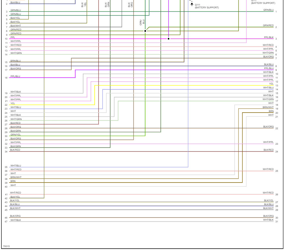

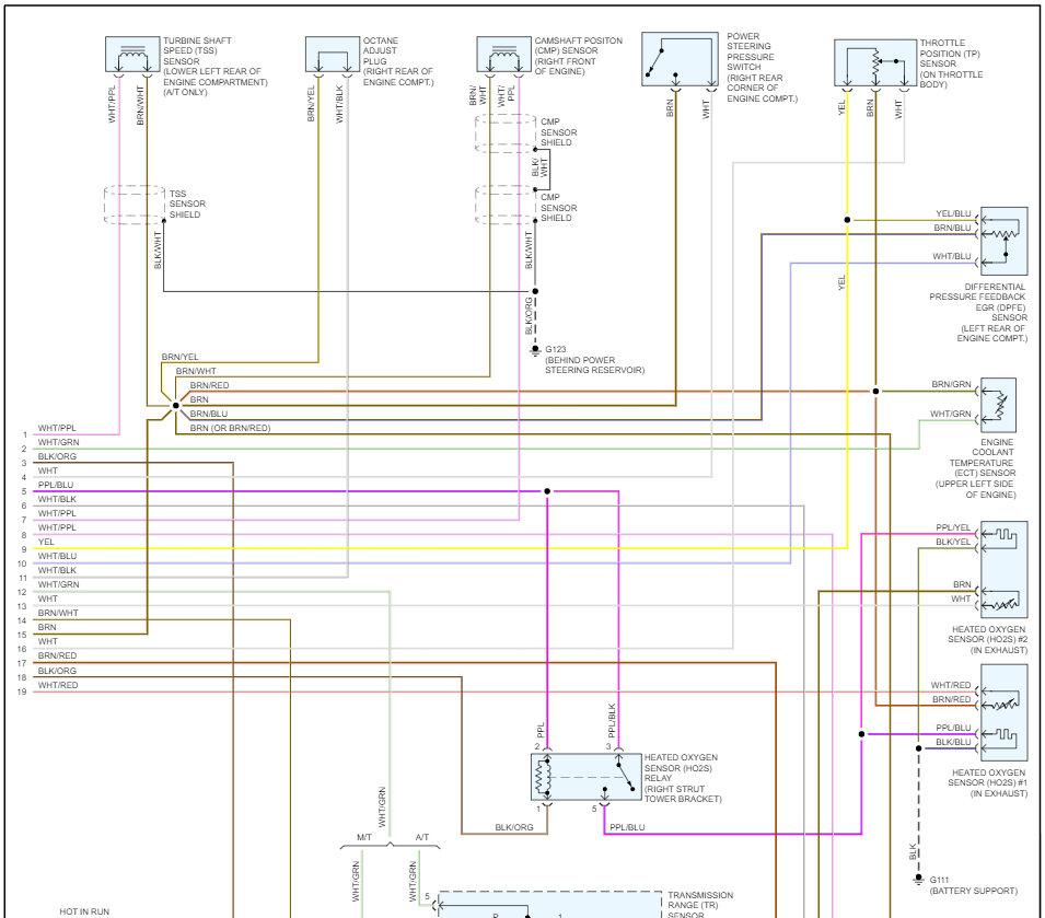

Here are the PCM wiring diagrams so you can see which wires are power and which are grounds.
This guide can help you check:
