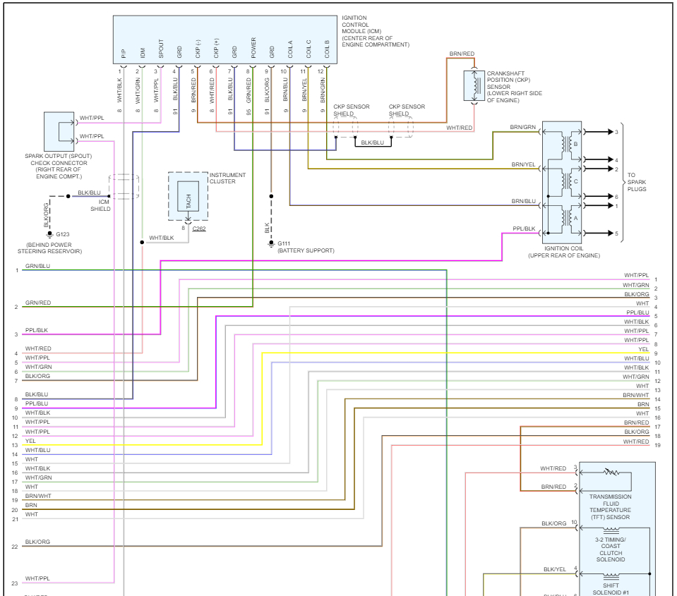

After the engine idles for about 25 minutes, it shuts off and will not restart. The PCM/ECM is very hot to the touch. I can smell unburned gas when I try to restart.

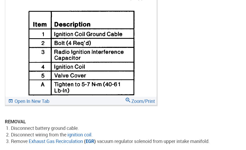

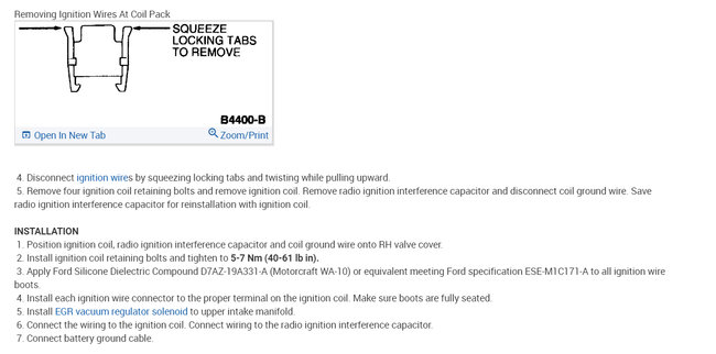

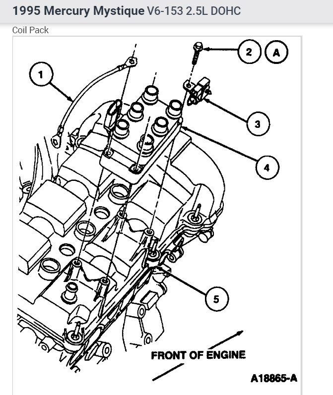

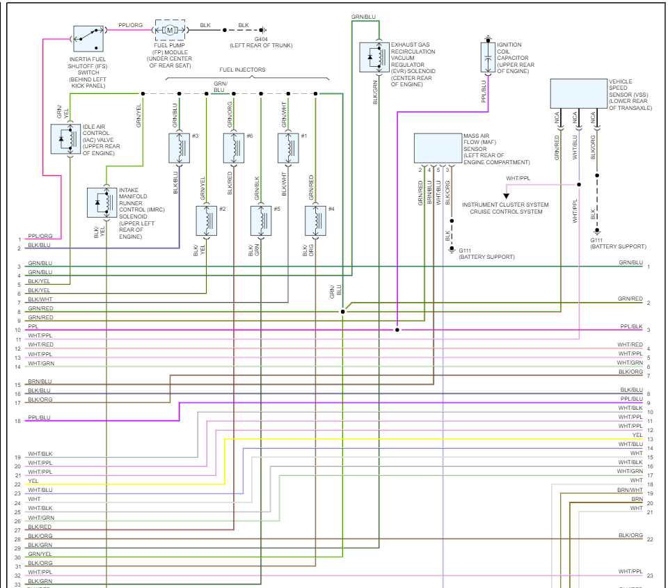

The PCM should not be hot, it sounds like you have a shorts injector, ignition coil or a bad ground to the PCM, can you see if the coil is hot as well, if so, I would replace it with a new one. Check out the images (below). Please let us know what happens.

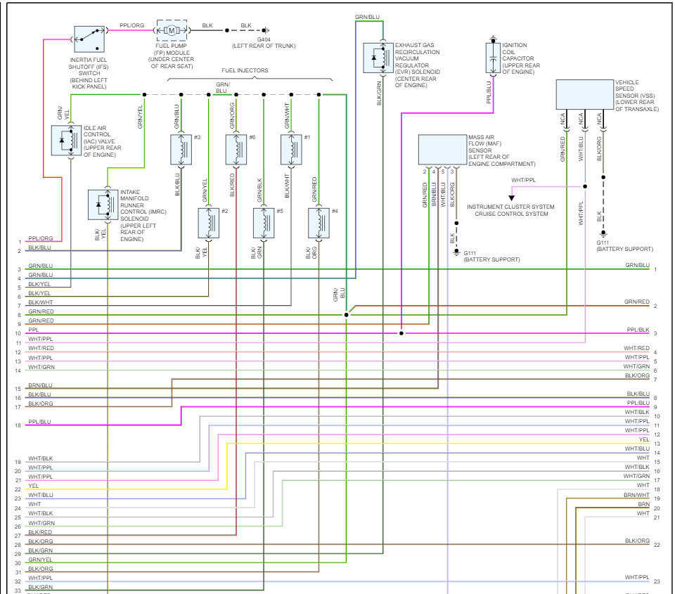

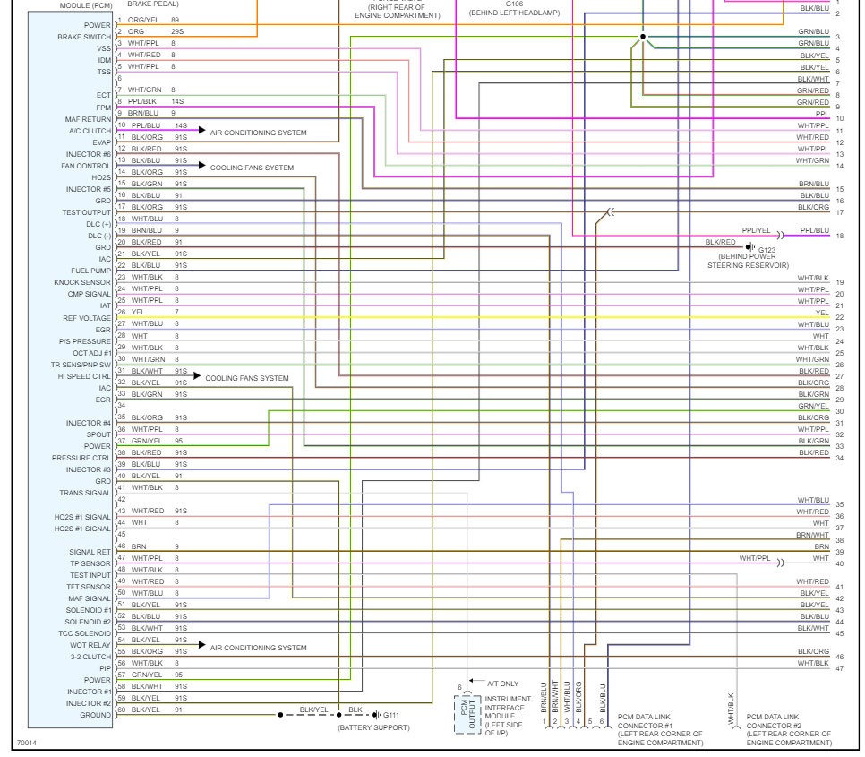

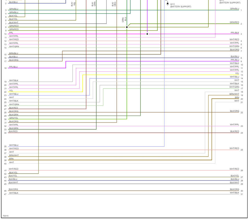

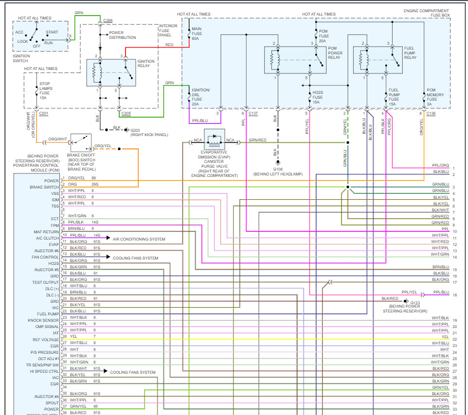

The PCM should be grounded from terminals 20 and 60, is that correct? The coil pack is new. It was warm but it sits right over the bank 1 exhaust manifold. I will investigate tomorrow.

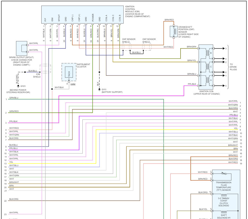

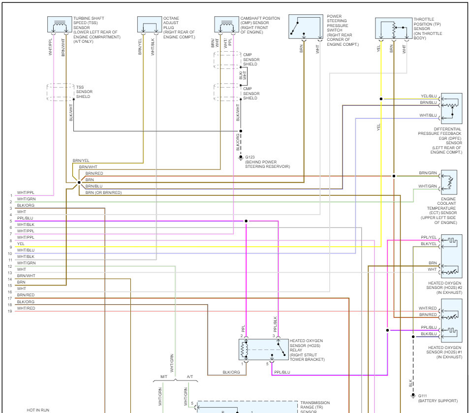

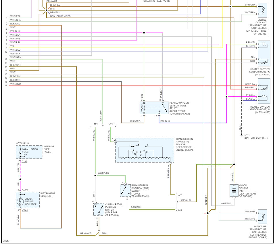

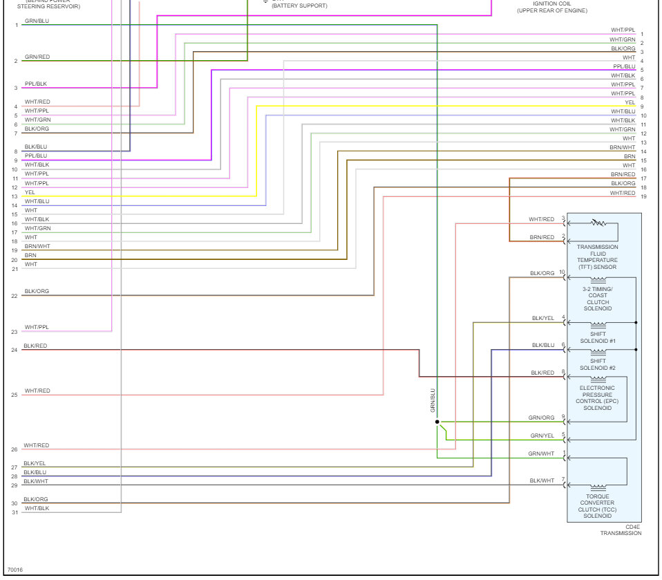

Here are the PCM wiring diagrams so you can see which wires are power and which are grounds.
This guide can help you check:
