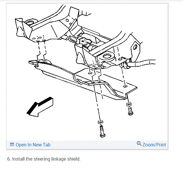

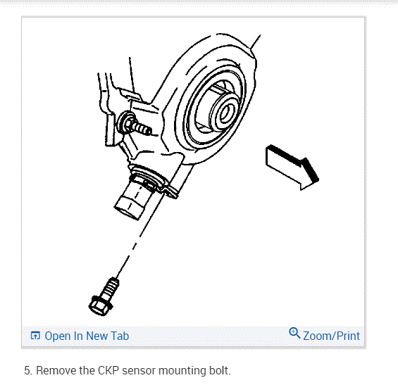

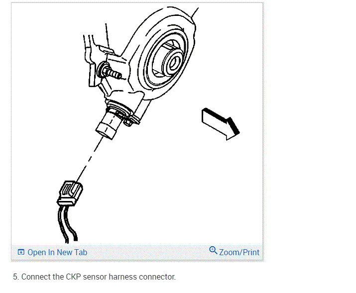

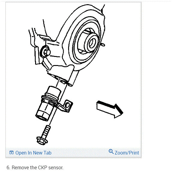

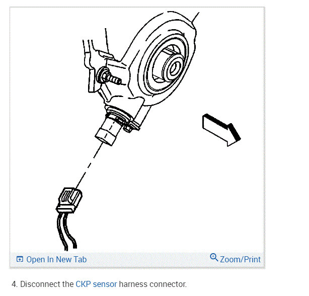

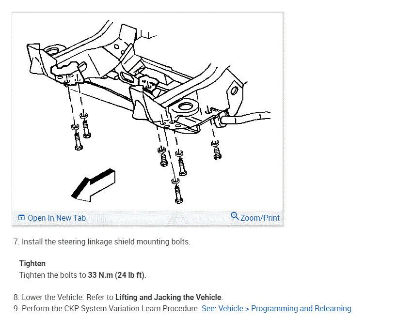

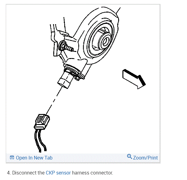

The engine will shut off out of nowhere when it's hot outside, but when I put it in neutral it will start again but once I put it in gear it will shut off again. It will start up right away but shuts off again. If I wait 15 to 20 minutes it will go.
Jul 2, 2022 at 9:19 AM
  • 110,244 POSTS

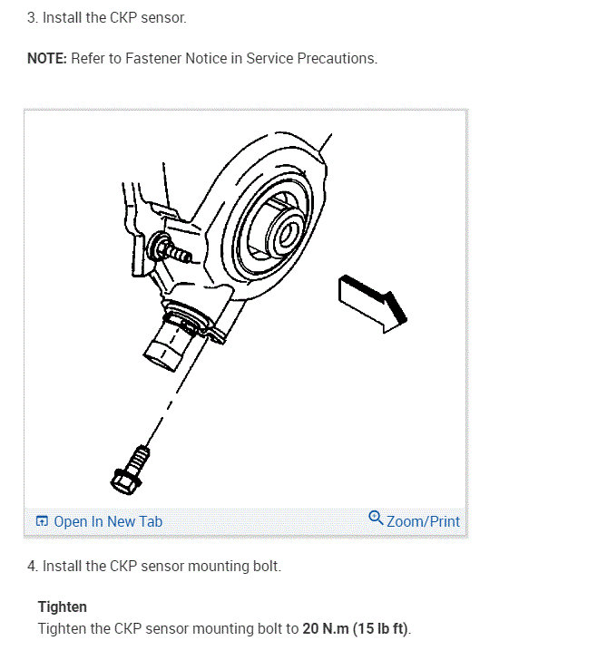

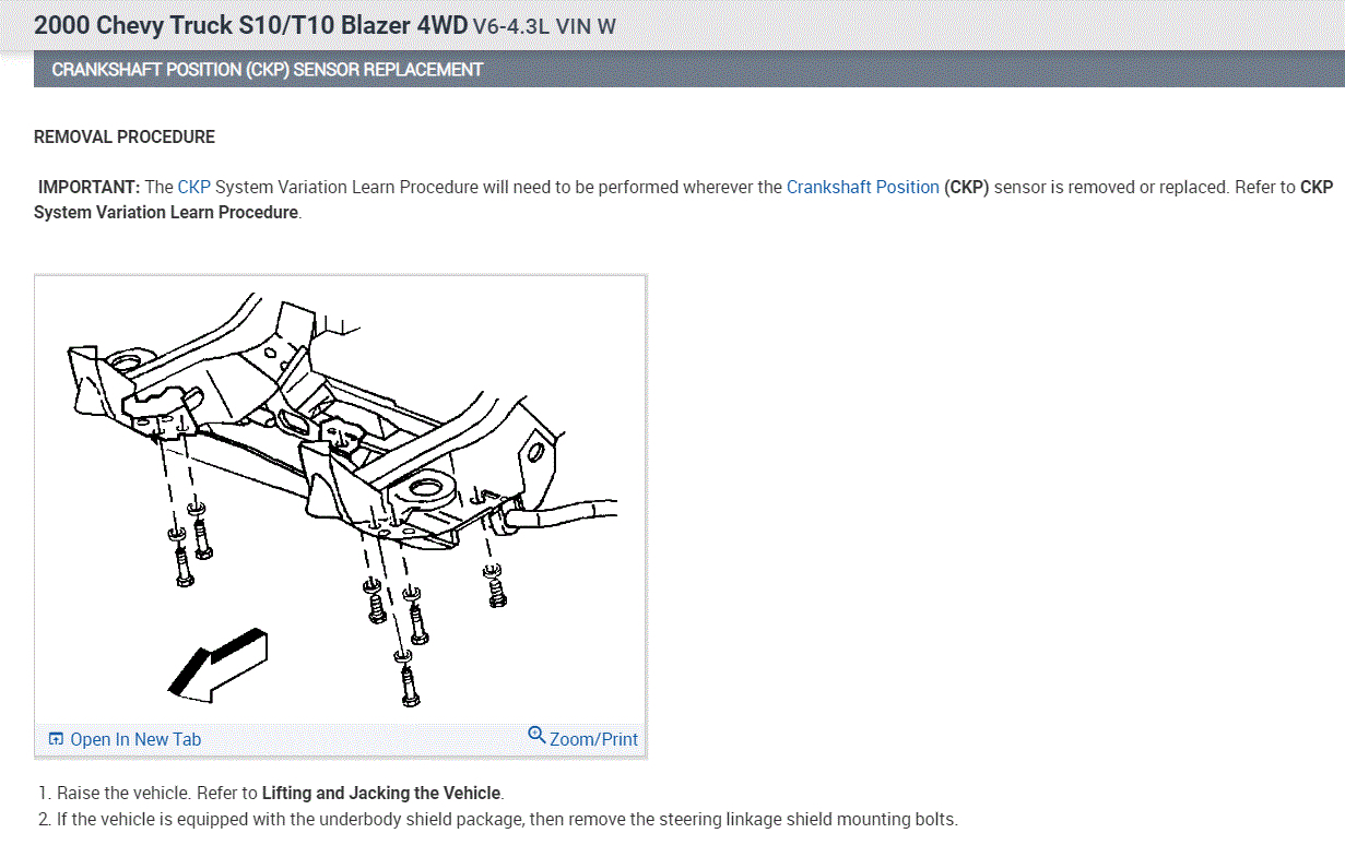

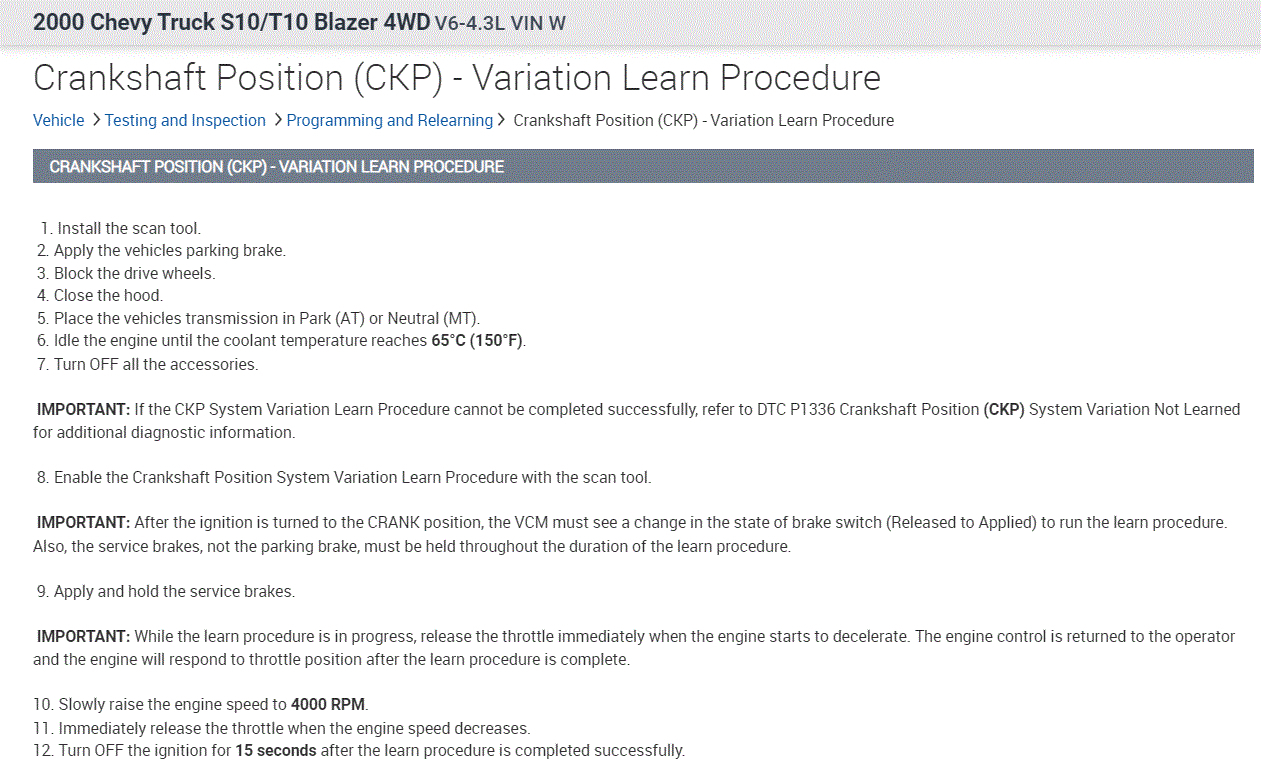

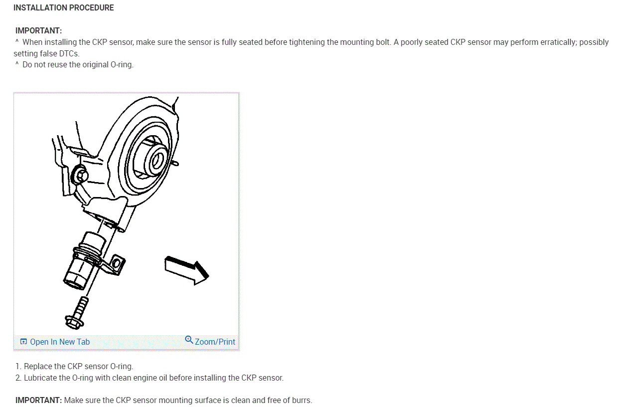

What you describe sounds like a faulty crankshaft position sensor. When they begin to fail, often they are adversely affected by heat. Do me a favor. Take a look through this link and let me know if you feel it mirrors what you experience:
If you do, here is a link that explains in general how one is replaced:
Also, I attached the directions specific to this vehicle below. Let me know your thoughts or if you have other questions.
See pics below. Note: The last pic provides the relearn procedure.
