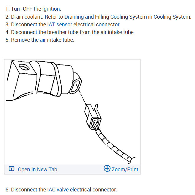

Engine sometimes shuts off at low idle?
Jan 2, 2025 at 4:10 PM
  • 55,433 POSTS

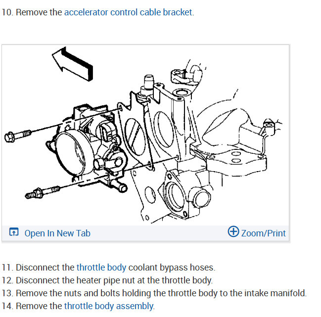

This is common, when the throttle bore needs to be serviced or the engine as a vacuum leak. Also do you have a check engine light on? If so, we should run the codes to see which codes are stored. Here are two guides to go over which should help fix it:
And use this guide when the engine is cool:
I would replace the IAC motor as well. Check out the images (below). Please let us know what happens.
