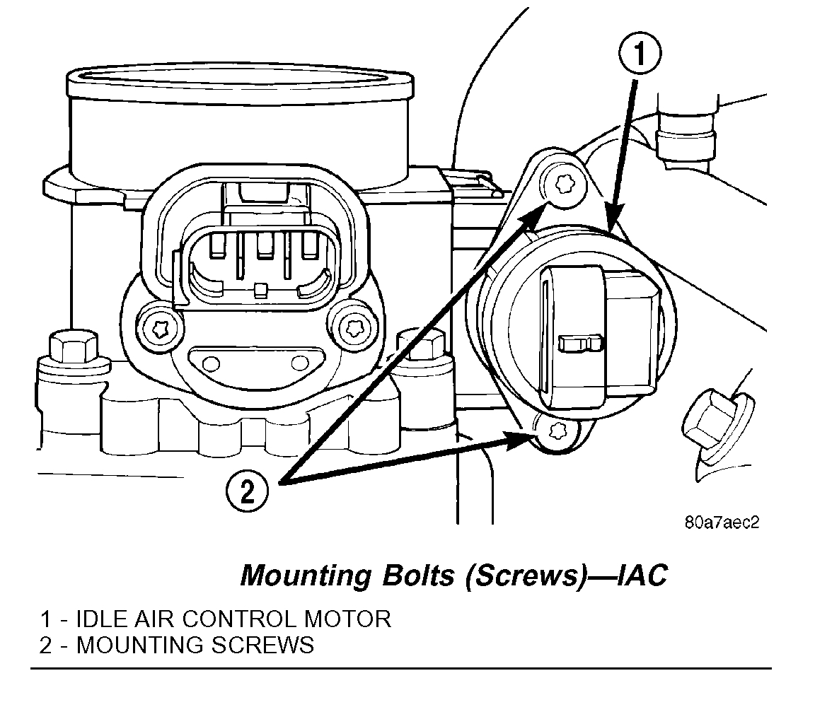

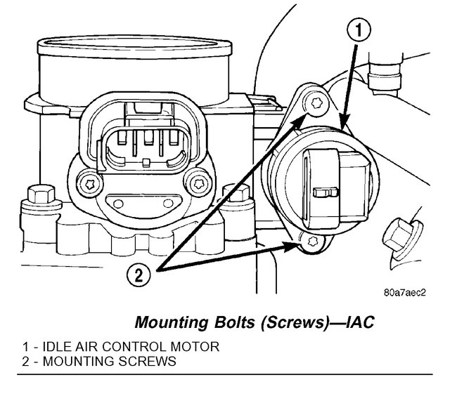

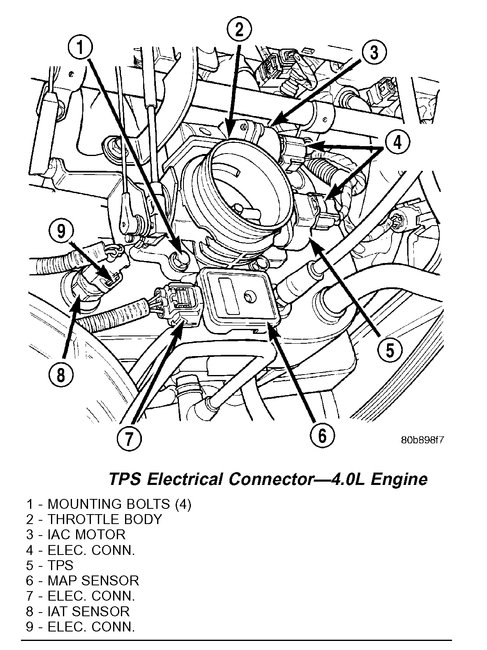

It starts right back up though. also if I put it in reverse first then go to drive and it goes with no problem.
May 9, 2020 at 12:09 PM
  • 110,240 POSTS
What you described sounds like a faulty idle air control motor (IAC). Does it stall if you turn on the AC? The IAC is what is responsible for maintaining engine idle speed. Even though that is my first suspect, there are other things as well which will be discussed in the first link below that I attached.
Take a look through these three links. The first discusses the most common causes of a stall at idle. The second explains how to service an IAC and the third shows in general how one is replaced.

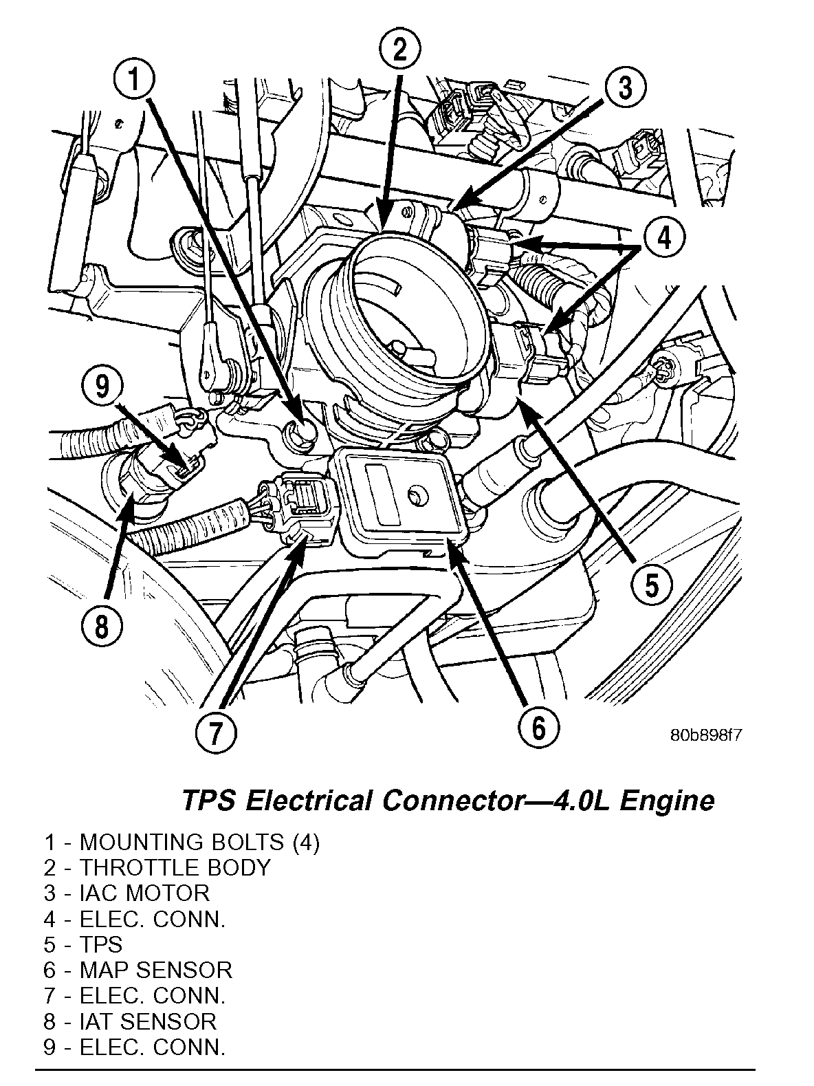

The IAC motor is located on the throttle body.
1 Remove air duct and air resonator box at throttle body.
TPS Electrical Connector - 4.0L Engine
pic 1
2 Disconnect electrical connector from IAC motor.
Mounting Bolts (Screws) - IAC
pic 2
3 Remove two mounting bolts (screws).
4 Remove IAC motor from throttle body
