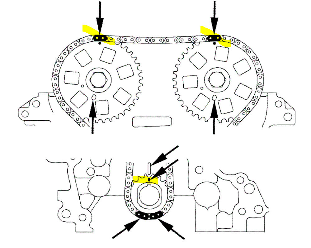

When you checked the timing chain marks on the cams, was the crank at TDC? See pic below. Also, when you crank it, is there any evidence of it firing? Are you spraying the starting fluid directly into the throttle body? If you remove the spark plugs, are they dry or wet with fuel?

Thanks for your thoughts, Joe. The engine fires to some degree and seems to want to start but not quite or it barely starts, runs poorly for a second or two and then quits. The spark jumps across the terminals of the coils okay, and although there is some blue in it there is some orange as well, so spark but probably not a really strong spark. I've taken off the coils and cleaned all contact points and the back of the ignition module where it contacts the block. I had to do a valve job on it before, as all the exhaust valves were badly burned (I replaced the cam chain, adjuster and sprockets at that time), and it has run great for a year or two. Then I heard some chain noise so had another look inside and the chain adjuster wasn't working properly, so I replaced that again. Been working well for the last year or two until this incident. Closer inspection yesterday netted some serious wear on the intake camshaft sprocket; some teeth were worn halfway (front to back) and some were very small and pointed so I took off the cam chain cover. Sure, enough I did check the cam chain timing correctly and it's correct at TDC, but I need to replace at least that sprocket; thus, taking off the cover (so much for cheap Chinese parts). Under normal start attempt the spark plugs get wet and if I crank it a lot with no plugs, I can smell gasoline. Plugs have been gapped and cleaned several times. 150lbs compression might not be fantastic but definitely good enough to run. Gasoline/either tell me it's not a fuel problem, so my gut feeling is somehow spark at the wrong time. The problem was immediate so something changed quickly. I'm not keen on just starting to change parts because I can't figure out what is wrong, but I'm out of ideas. Over to you! Al.

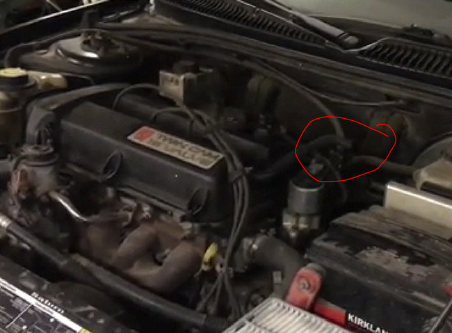

I attached a pic from your video. Is that the PCV hose?
Try something for me. Disconnect the MAP sensor and let me know if it runs differently or if there are any changes.
Apr 15, 2022 at 1:23 PM
ALAWISHES
  • 12 POSTS
Hi Joe, yes that's the PCV hose... I removed a fair amount of the intake system to access the throttle body plus make sure there was no restriction anywhere. After sitting for a day and disconnecting the MAP plug, it initially resulted in a little longer run, slightly higher RPM and a little less roughness but the engine quit after 10-15 seconds. Restarting immediately after this resulted in the same rough run for a few seconds. 12v at 2 terminals on the MAP plug. TPS has 5v feed and varies from .43v to 5v when throttle is moved from one extreme to the other. Coolant temperature sensor has 5v feed and when removed it varied in resistance when run under hot/cold water.

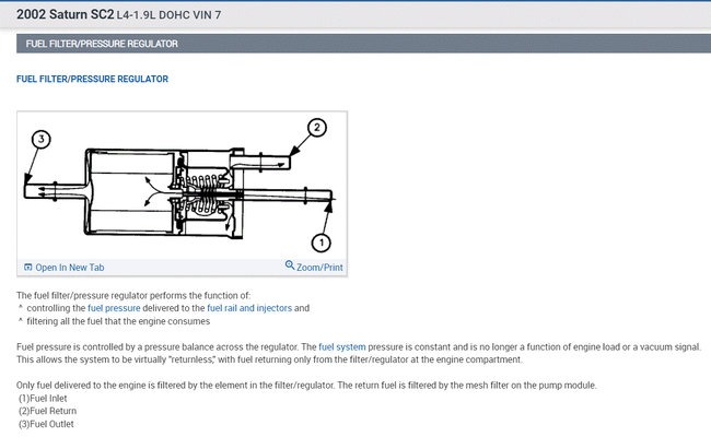

I may have figured this out. The fuel pressure is regulated at the fuel filter. The filter is just that, a filter, but it has an integral pressure regulator. See pic 1 below.
By chance, have you replaced the filter?
Apr 16, 2022 at 10:39 AM
ALAWISHES
  • 12 POSTS
Hi Joe, I hadn't thought about replacing the fuel filter, as the engine seemed more flooded than starving for fuel. I hadn't replaced it since we bought the Saturn a number of years ago, but I put in a new one today. Unfortunately, no change :-(. Cheers, Al.

I'm concerned about the fuel filter. According to the manual, the pressure regulator is integral.
Let me know what you find when you get the scanner. I'll watch for your reply.

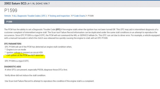

Hi Joe, my friend finally got back and borrowed a Snap-On high end code reader. It showed code P1599, and when I looked into that it just means the engine stalled when the key was still turned on. I checked the fuel pressure again and it's 56# when the key is turned on, and while cranking (or barely running) it varies between 50 and 55#. He said there was another code that indicated something about the air intake temperature sensor (maybe that it had been replaced). I had already taken out this sensor and the resistance checks out correctly as I make it warmer and cooler, and there is 5v at the connector. Now I'm back to no ideas again. If you have any other brainwaves, please let me know! Cheers, Al.

Also, the code does indicate it stalled with the key in the run position. However, it also indicates the CKP signal was lost.
Read through the code description below and let me know your thoughts. Also, by chance do you remember the code related to the intake air temperature sensor?
