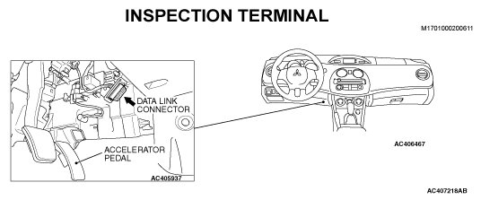

HARRY P
  • 2,292 POSTS
Attached is the location of the connector to hook the scanner up to.

ROSHAN FERNANDO
Heyman,
I brought the car to local Mitsubishi dealer yesterday and they helped me to scan the faulty codes and they found there were three codes showing including oxygen sensor. I could not see the codes but they said it shows the issue.
After further discussing with them, they could figure out that cause for the problem was my car battery went drained a day before this happens and I change the battery. during the battery replacement the ECU data has been corrupted or erased. Once reset the ECU data it is all fine now. :)
