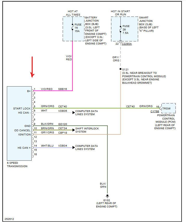

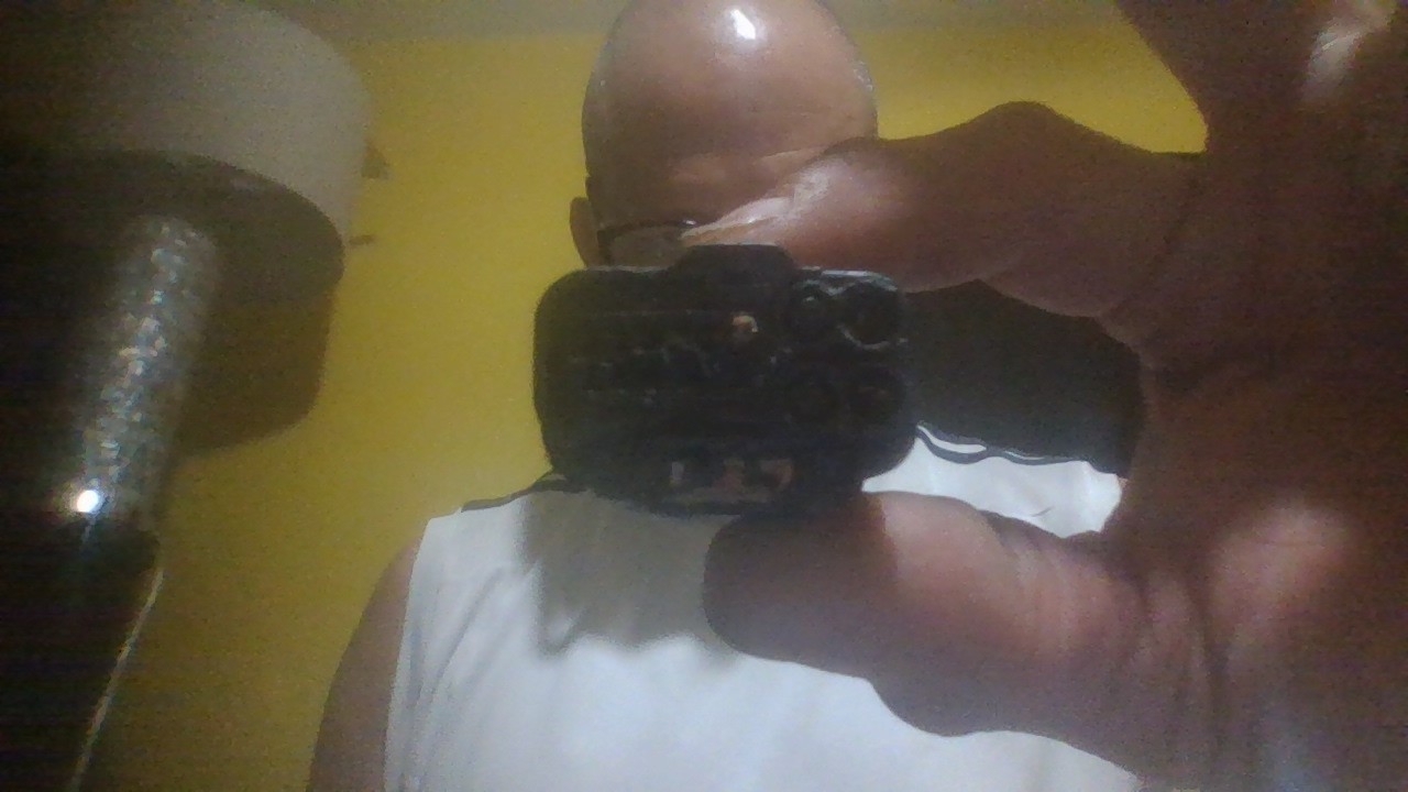

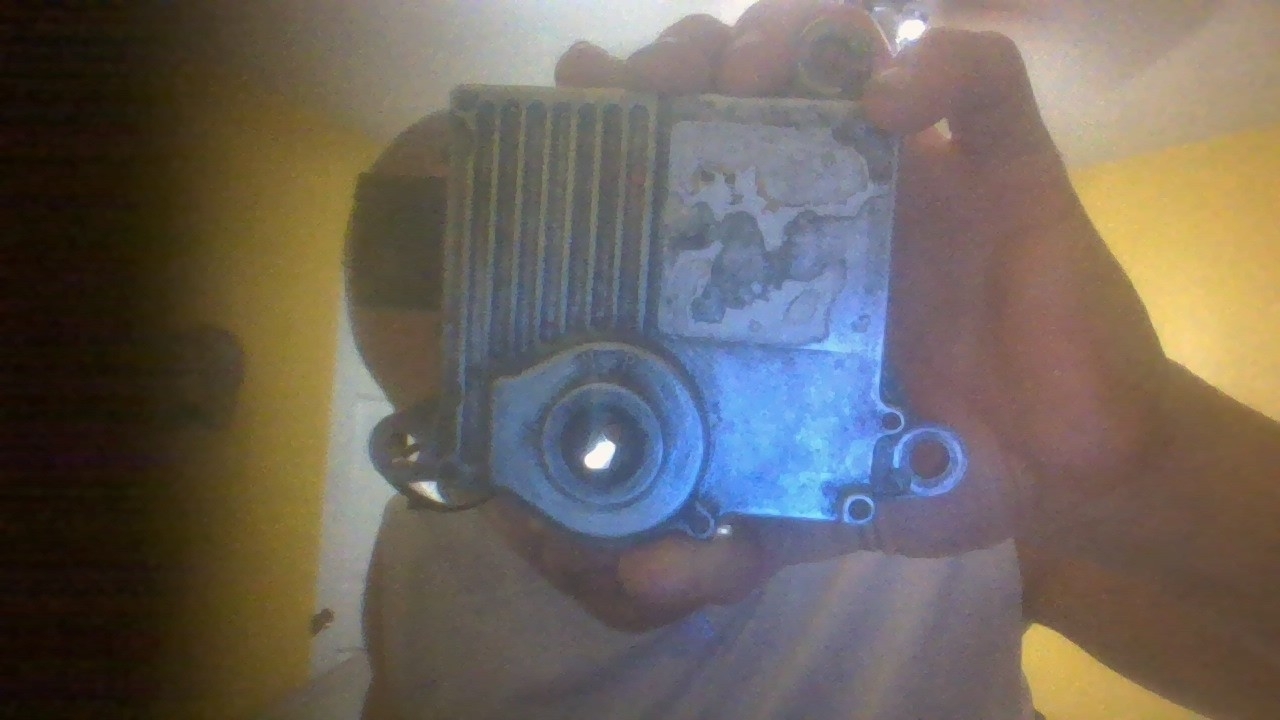

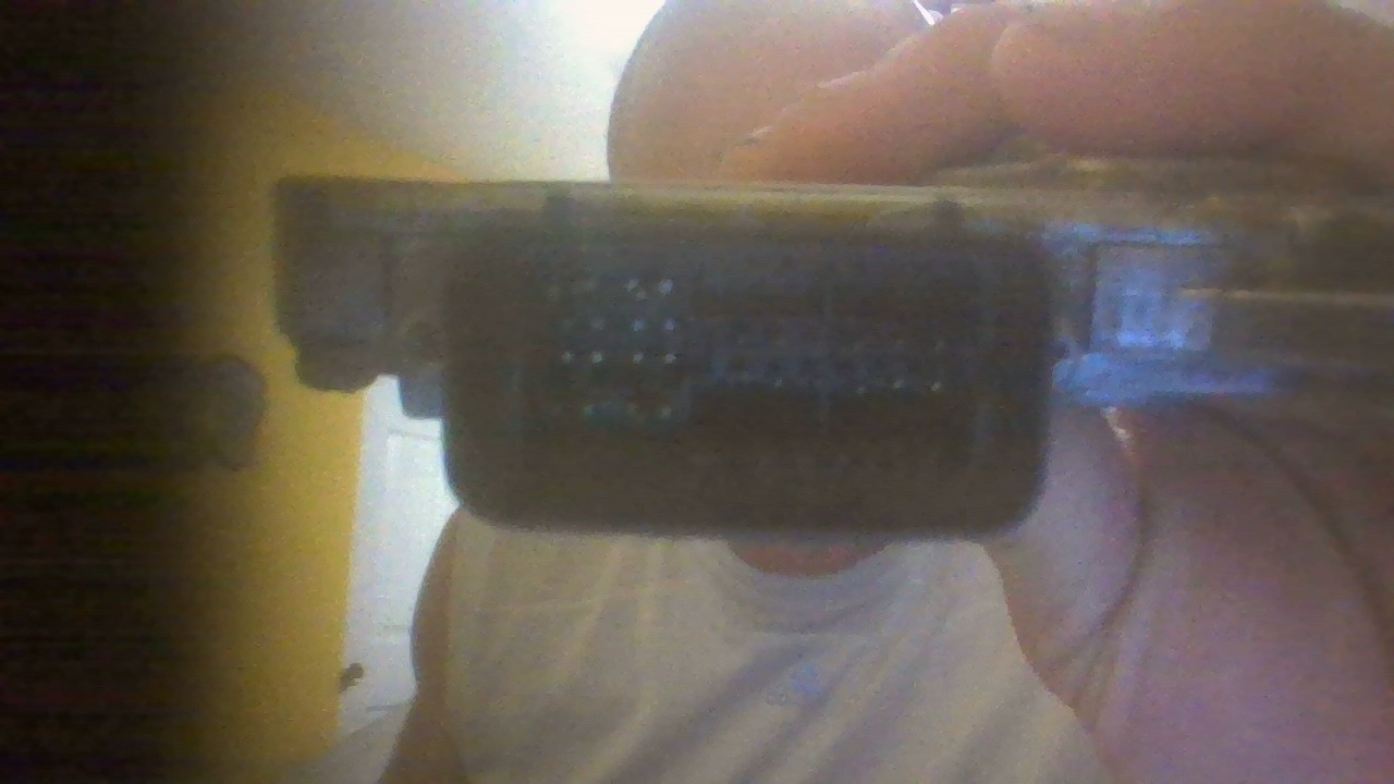

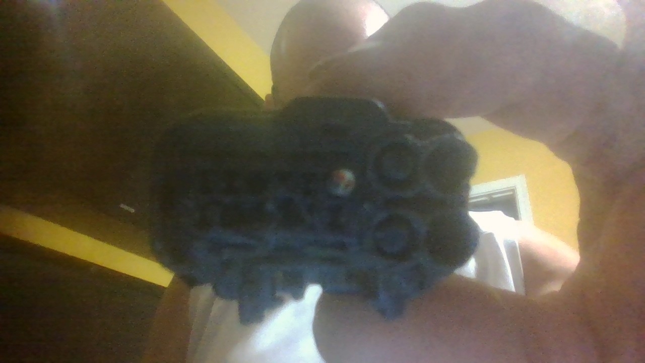

As I'm looking in the manual booklet it gives me the transmission description (Aisin AW F21 Automatic transaxle (TR-VX.) Code B. So, the female connector is damaged that goes into the control module. What wires go to which pins. Thank you...
Mar 11, 2025 at 7:56 AM
  • 55,433 POSTS
Sure, here is the wiring diagrams for the transmission control module. Thanks for the images they helped. Check out the images (below). Let us know if you need anything else.
Mar 12, 2025 at 4:36 AM
GREG GARCIA
do you have the pinout for the connector?
Mar 12, 2025 at 5:38 AM
  • 55,433 POSTS
No, I am sorry we don't. You can see the terminal numbers though which should be on the connector.
