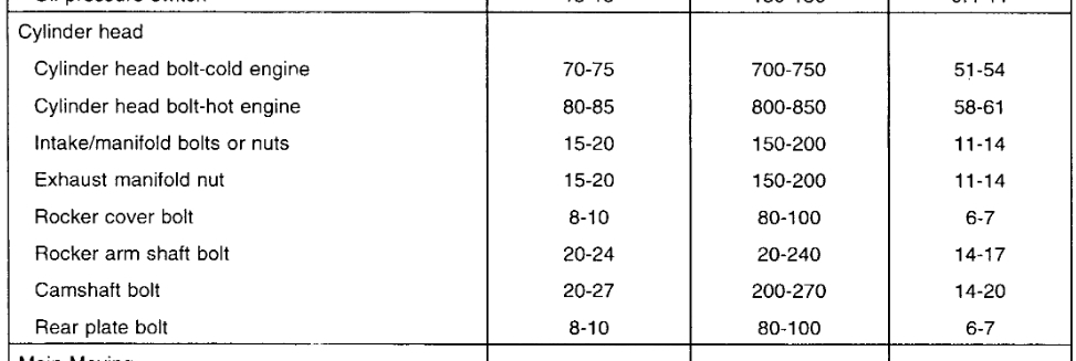

Hi guys,
Could anyone help me with the correct torque specs for bolting down the cylinder head on car listed above?
Cheers!
Apr 8, 2019 at 12:43 AM
SCGRANTURISMO
  • 4,897 POSTS
The information that you requested is in the diagrams down below. Please feel free to ask any automotive questions that you may have. That is what we are here for.
