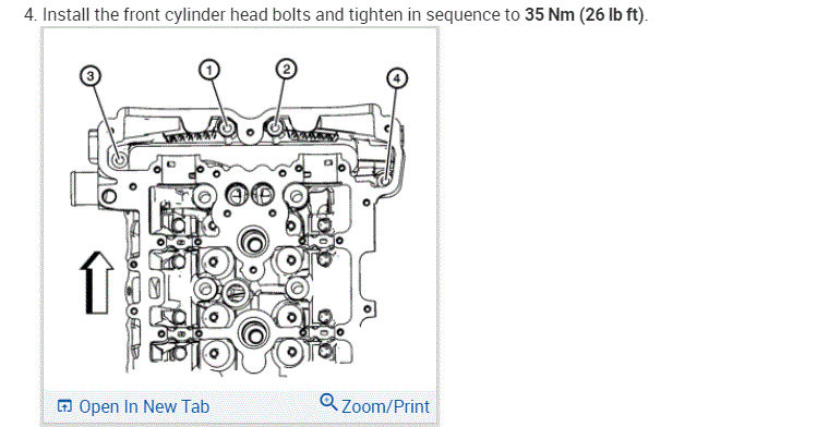

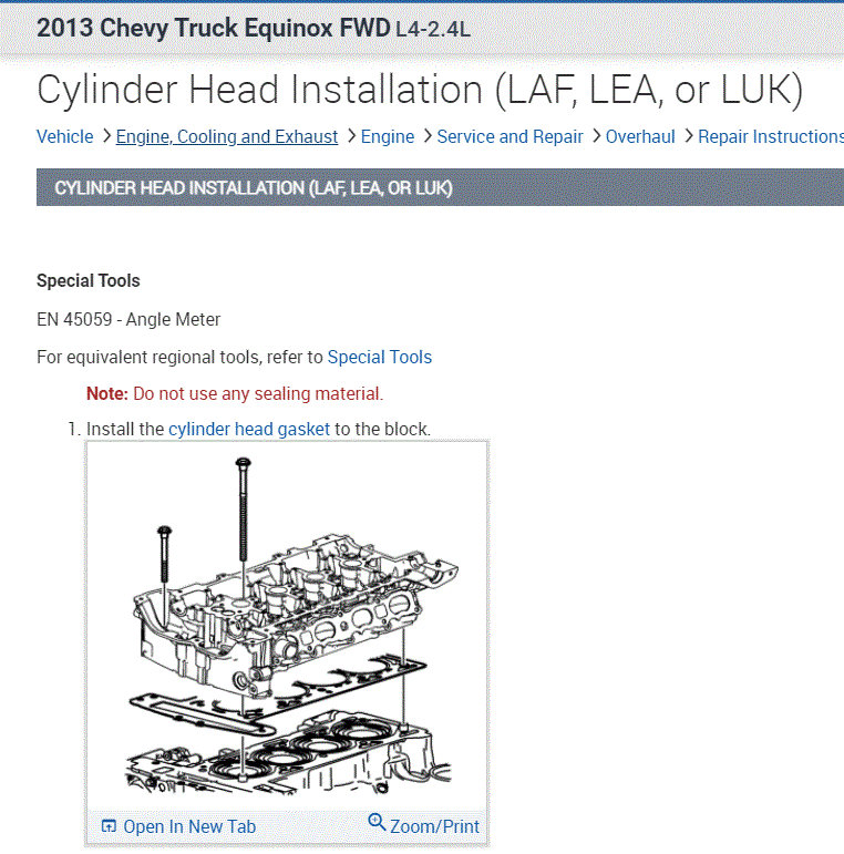

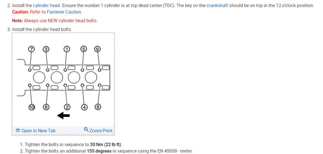

Need to know the torque sequence for head bolt and other torque specs and procedures. Cannot find anything reliable online.
Jan 1, 2022 at 5:14 AM
  • 110,241 POSTS
If you look below, I attached the torque specifications, procedure, and bolt tightening sequence. I hope that helps.
